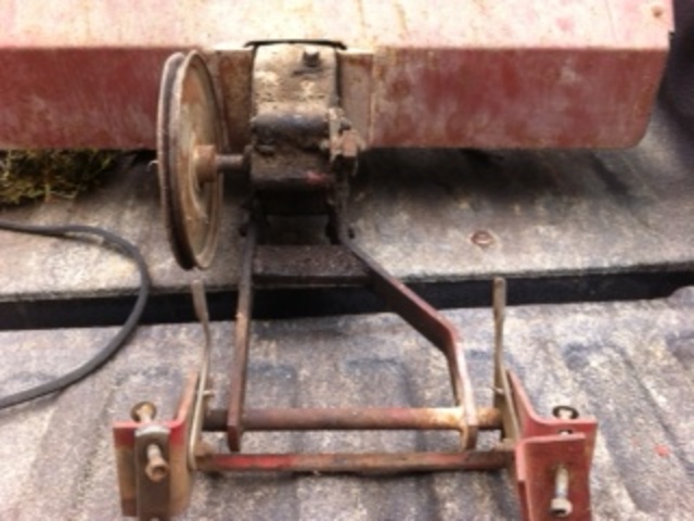

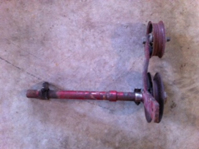

fuzzy 0 #17 Posted April 12, 2012 The mid mount pulley bracket broke this evening, so more problems. The weld broke. It appears as though the mid mount diameter is just a hair too large for the latch. I think that is ultimately what made the belt jump. I'll try to upload photos of the tiller and mid mount pulley we have and see what you think. I really didn't think it was going to be this difficult. I have seen different pictures showing different positions of the tensioning spring so i'm second guessing whether or not its the right one for this 1983 tractor? Getting frustrated... Share this post Link to post Share on other sites
fuzzy 0 #18 Posted April 12, 2012 I'm not sure i understand your question. The attach bracket on the rear axle? The tiller attaches from the bottom if thats what you mean. Share this post Link to post Share on other sites
fuzzy 0 #19 Posted April 12, 2012 Here is what we have. I have added an idler pulley and bracket on the tiller frame since this picture. Is this the correct tiller for a 1983 C175 just to be sure? Share this post Link to post Share on other sites
jachady 130 #20 Posted April 12, 2012 Looks like you have everything you need to make it work on your tractor. A couple things to help keep your belt on, first check the big pulley on the tiller - in the picture it looks bent. After you have everything installed, eyeball the belt down under the tractor and look for anything that looks out of line. Sometimes you need to shim the idler pulleys or even bend the bracket you made for the small pulley to get the belt to ride straight. After that all looks ok, run your tiller in the up position and watch for the belt moving around on the flat pulleys, make adjustments. Then watch the belt while going through the motions of lowering and raising the tiller. After all that you should be good to go. Like was said above, you'll still throw a belt every once in a while when you hit a rock or hard spot and the tiller jumps. Hope this helps. John Share this post Link to post Share on other sites
jachady 130 #21 Posted April 12, 2012 And it looks to me that the small pulley on the Mid-pulley is on the wrong "ear". On mine the tensioning ear points up with the small pulley pushing down to create the pressure. I simply drilled a hole in the main belt guard and attached a bolt to run the tensioning spring to. May not be factory but it works. I'll get a picture in the morning. Share this post Link to post Share on other sites
fuzzy 0 #22 Posted April 12, 2012 Thanks Jachady! I agree about the small pulley. My dad and I had already changed that around. The ear that the small pulley is on in this picture (the one for the tensioning spring) is where the weld broke. I'm trying to get the big pulley off in order to reweld it as we speak! Share this post Link to post Share on other sites
