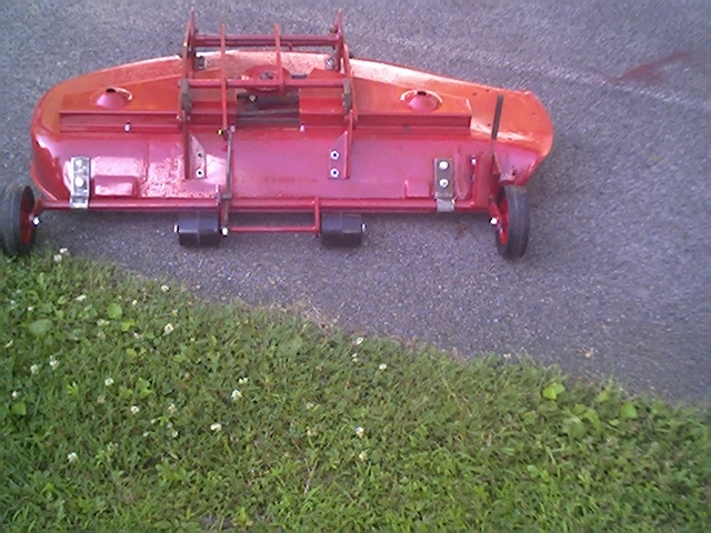

jdog_kustoms 82 #1 Posted March 30, 2012 i was searching craigs list and found and add with a c 105 and a deck my question is this caradge normal on a deck cuase i have never seen it before or is this a custom creation just wanted to see what you all thought deck 1.bmp Share this post Link to post Share on other sites
IthacaJeff 151 #2 Posted March 30, 2012 I've never seen such a thing, but I'm sure there are others with a lot more experience that may give a more informed answer. Jeff Share this post Link to post Share on other sites
WH854 45 #3 Posted March 30, 2012 i was searching craigs list and found and add with a c 105 and a deck my question is this caradge normal on a deck cuase i have never seen it before or is this a custom creation just wanted to see what you all thought I would say a custom built. Here is what my 42 inch on my C-105 looks like. the rear roller adjustment is on the left side, mine is on the right side. Possible it is a 48 inch deck for a D series they had the adjustment on the left I think. Chas Share this post Link to post Share on other sites
SAM58 33 #4 Posted March 30, 2012 I could be wrong... I think that is for a C-175, C-195. Special deck with the offset for some Model. I remember something about a discusion on the old RS Forum about it. I am sure that someone here will chime in on the correct application for it. It may fit a C model anyway... Share this post Link to post Share on other sites
