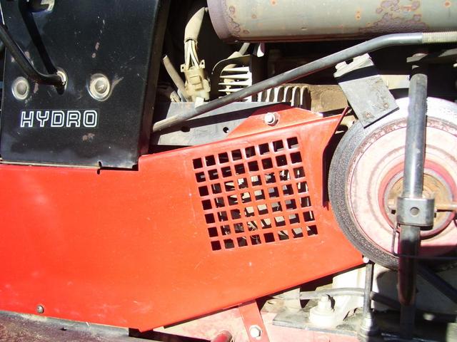

Hydro 131 #26 Posted April 4, 2012 Can't wait to see your modification. If I had it to do over again knowing what I know now that would be the first thing I would do with my Onan is vent the belt guard. The second would be a cylinder head temp guage. Share this post Link to post Share on other sites

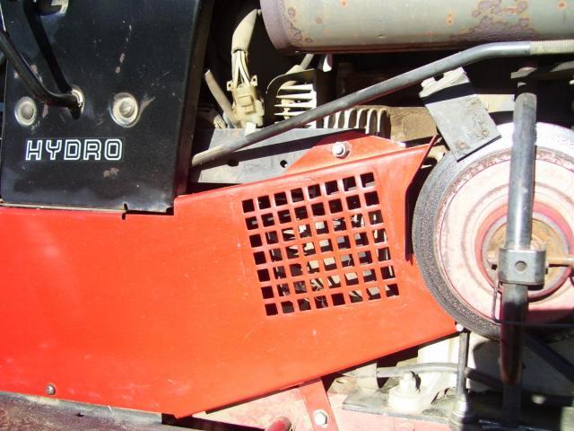

jay in nc 211 #27 Posted April 4, 2012 victory! i finaly loaded a picture. first time don't know if i will be able to do it again. here is the beltguard on my 518. i have enough material to do at least 30 more, pm me if interested. Jay 1 Share this post Link to post Share on other sites

boovuc 1,090 #29 Posted April 5, 2012 Hi Jay, That is a great job! Very nice looks and I would guess very functional too! Share this post Link to post Share on other sites
coldone 35 #30 Posted April 5, 2012 It does look factory! Share this post Link to post Share on other sites
jay in nc 211 #31 Posted April 5, 2012 that is just cut & fit , mig welded & light grinding 1 light coat of primer & 2 light coats of farmall paint spray bombed,and i got rain drops in the paint when it blew under the shelter, customer parts will be better but i had to get it done that day! thanks for your praise everyone Jay Share this post Link to post Share on other sites

BOWTIE 226 #33 Posted April 5, 2012 JAY, I JUST SAW THE PICTURES OF THE VENTED BELT COVER. DO YOU SEEN THE DUST/DIRT BLOWNING THROUGH WHEN MOWING? IT LOOKS GREAT. IF I PICK UP ANOTHER ONAN TRACTOR I WILL DO THAT ALSO. I THINK I WILL MAKE IT LOOK LIKE THE LOUVRE HOOD IF POSSIBLE. THAT SHOULD HELP THE PROBLEM WITH COOLING.. BOWTIE IN OHIO Share this post Link to post Share on other sites
