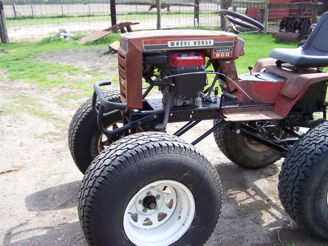

These tires are on my new addition. Go BIG or go home!
post-1334-0-71702200-1333320989_thumb.jp
mdn1081
Haha, wow cowboy what do you plan on doing with that machine? Or is it just a showpiece?
woodchuckfarmer
Its a monster horse
546cowboy
I bought this from a guy and have started making some improvements and I plan on painting it. I love to just cruise around on this. I may be going to the Mentone,IN swap with it and a few tractors to swap or sell. Maybe I'll see some of you there. :USA:
