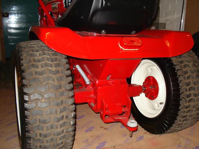

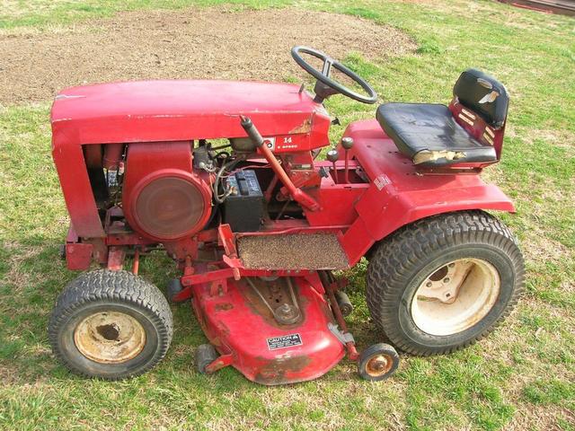

fourwheels0 191 #1 Posted March 20, 2012 can anyone tell me what rear hubs are suppossed to be on a 73 model 14 8 speed. or what hubs will work. i have a mis matched pair on mine. the woodruff key is a 1/4 x 1inch. i think it has 1 1/8 axles. Share this post Link to post Share on other sites
Anglo Traction 761 #2 Posted March 21, 2012 Your Hubs should have the 'Fingers' or 'Spider style' strengthening where the Stud holes are. I have this style on both 72 and 74 models and yes 1.1/8" dia Axles. You can also fit the Later heavier version if you wish. Share this post Link to post Share on other sites
