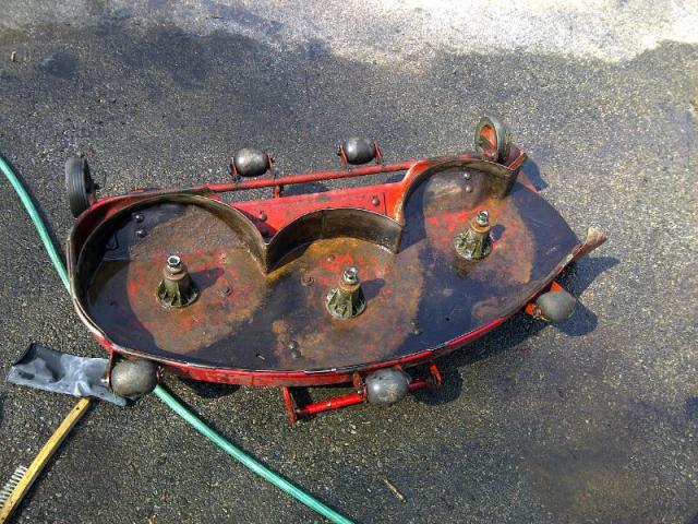

dsholler 54 #1 Posted March 18, 2012 I have an 87 414-8 with a 48 inch mower. It appears that the deck has not been cleaned at all by the previous owner. It has a layer of dirt mixed with rust that is a couple of MM thick. I have managed to scrape this off in some places, and can see some red paint beneath it. But after a cumulative 7 hours of scrubbing with the wire brush, I am pretty much done. The questions are 1. I am sure that it woudl be best to get it all clean, but given my limited time work on this, am I doing something horrible by leaving a bit of the crud on there. ? 2. When I had an old fashioned push mower, I used to paint the bottom of the deck with motor oil to make it slippery and prevent corrosion. I did it from the time I got the mower, and since the deck was small, if there was crud or rust I scrubbed it down to shiny metal before putting on the oil. Will it be better worse or no difference if I just put the oil on it with some crud left on there? Share this post Link to post Share on other sites
gregg'shorses 77 #2 Posted March 18, 2012 That is clean enough, just oil it with a product like :http://www.seafoamsales.com/deep-creep.html Share this post Link to post Share on other sites
dsholler 54 #3 Posted March 18, 2012 thanks @greggshorses... I took your advice (sorta). .I didn't have any of the stuff you mentioned, but I did have a nice big new bottle of PB Blaster, so I used that instead.. and I put the deck back on (first time for that as well ) seems to work just fine.. grass has started to green up here, but none of it is long enough to cut... so I was not able to do a real field test.. maybe next weekend. Share this post Link to post Share on other sites

can whlvr 994 #5 Posted March 19, 2012 i would invest in an angle grinder and you can get a wire brush for it,then that would be 10-15 minutes instead of hours,then it can be used for many things like sharpening blades,grinding rust,cutting metal,sanding and many more things Share this post Link to post Share on other sites
BOWTIE 226 #6 Posted March 19, 2012 I HAVE ALWAYS USE A PRESSURE WASHER AT THE END OF THE MOWING SEASON. I HAVE GAS POWERED ONE WITH 3000 PSI. ANYMORE I JUST USE A ELECTRIC ONE WITH 1500 PSI IT WORKS GREAT AND ITS JUST SIMPLER TO USE WITH NO MAINTANCE. I ALSO HAVE A OLD KNIFE I SCRAPE THE FRESH GRASS OFF THE UNDERNEATH WHILE IT IS STILL FRESH. BOWTIE IN OHIO Share this post Link to post Share on other sites
