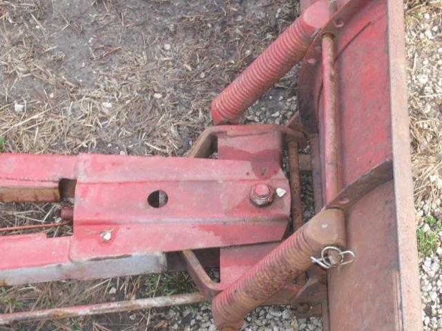

Mykol610 2 #1 Posted March 16, 2012 This may be a stupid question but I've noticed people talking about snowblades, grader blades, dozer blades, ect. What is the difference between each kind? I have a 42" blade. What kind is it, I used it for plowing this winter and am planning on using it for moving dirt/gravel this summer when I build an extension on my shed for my toys. But I don't want to mess it up anymore than it is. It's already bent a little from the previous owner (right side in the picture). It's a model/serial 42400 I'm not sure which one it is (snow/dirt/dozer) and don't know if it's the wrong kind, will I mess it up. Any help would be appreciated. Thanks. Share this post Link to post Share on other sites
Mykol610 2 #2 Posted March 16, 2012 Here's another pic of it... Share this post Link to post Share on other sites
Trouty56 567 #3 Posted March 16, 2012 Dozer blades and snow blades are one in the same. That is what you have pictured there. A grader blade is underneath the tractor between the front and rear wheels. I hope this helps...... Share this post Link to post Share on other sites
Hodge71 665 #4 Posted March 16, 2012 :text-yeahthat: What he said...Damn Bob ya beat me again. I would elaborate to say that a snow dozer blade is good at moving large piles of dirt/stone and getting a grade. The grader blade is better at maintaining that grade and say filling holes in a driveway or the like. It dos this more efficiently because it sits between the front and rear tires. I hope this helps you out. Share this post Link to post Share on other sites
