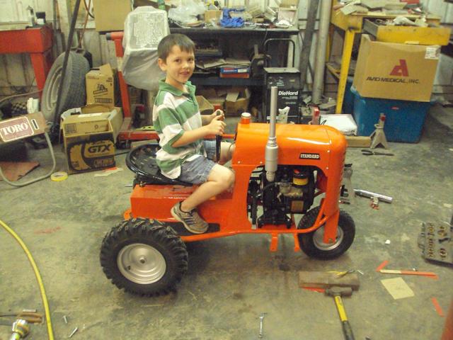

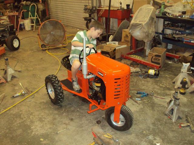

bowtiebutler956 650 #183 Posted May 20, 2012 I've run into a small problem, when you have been running the little tractor for about 10min. it starts cutting out, and losing its fire. The points, and condenser are perfect, and the only thing that I believe could be affected by heat is the coil. The coil is 60yrs old, so I guess it has the right to die, but it could have waited till after Danny's birthday! I did manage to find a coil on and I paid extra shipping to have it here by Tuesday, his birthday isn't untill Friday, but I'm not taking any chances. So the engine is going to have to come back out. I did make some revisions to the exhaust, because I thought it was really ugly. It's still not exactly what I had in mind, but it will do untill I buy some stainless steel pipe. Of course Danny is on the tractor in the pic, I can't keep him away from the shop right now! Matt :flags-texas: Share this post Link to post Share on other sites
