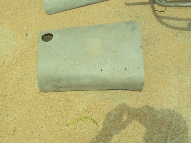

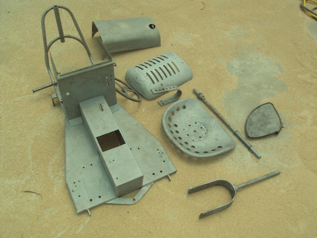

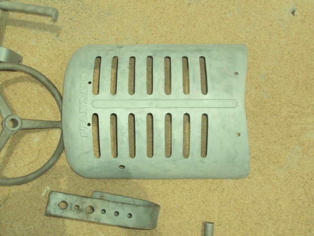

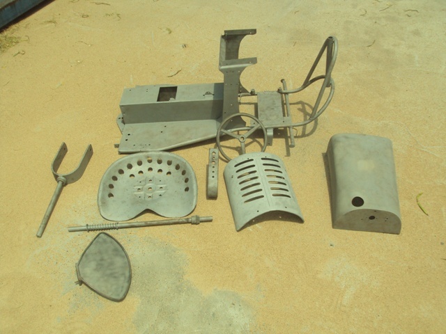

bowtiebutler956 650 #80 Posted April 29, 2012 Well, I finally got around to sandblasting the tractor. What a mess that makes, the slab outside of my shop looks like beach property. That sand gets everywhere, it fills your shoes, your pockets, and gets into places where its not nice to have sand at! There is quite a bit of rust pitting on this tractor, and I really wish I were a better body man. I'll do the best I can, and hope it turns out OK. I'll get it primed tomorrow. Matt :flags-texas: Share this post Link to post Share on other sites

Martin 2,133 #83 Posted April 29, 2012 looks good matt, just make sure you get some primer on that metal quick. with surface pitting the metal will start rusting again real soon with any sort of humidity in the air...... Share this post Link to post Share on other sites
bowtiebutler956 650 #84 Posted April 29, 2012 Looks like the metal is in good condition .. Looks can be deceiving. There are some small rust holes in the floor pan towards the back, and quite a bit of rust pitting. I should have taken some close up pics. I shouldn't complain, it is 60 years old, so I guess overall its pretty solid. Craig I just blasted all the rust off, and I have no interest in making that a weekly ritual. I think I'll paint it, but thanks for the suggestion. Not Really! I plan on priming it tomorrow first thing Martin, just as soon as I go buy some of that really expensive epoxy primer. I'm really having a hard time bringing myself to pay $70 for a quart of primer. I may just use self etching primer, money is pretty tight right now. Thanks to all. Matt :flags-texas: Share this post Link to post Share on other sites

Martin 2,133 #89 Posted April 30, 2012 matt, ive had to redo stuff so many times because of flash rusting. actually when the metal is really pitted, it will start quick. i think sometimes blasting doesnt remove all the rust in the pits unless you spend a bunch of time blasting it. only thing is, the more time you spend on sheetmetal, the more you risk work hardening or even stretching the metal. just one of the many downfalls of rusty metal when trying to restore it. unfortunately most often we cant choose what we have condition wise to work with...... Share this post Link to post Share on other sites
bowtiebutler956 650 #90 Posted April 30, 2012 The floor pan section of this tractor was quite rusty, and I had to spend quite a bit of time with the blaster to get it all off. It has alot of pitting, and a couple small rust holes. I really do wish I was a better body man. This restoration is going to be far from perfect, as hiring someone to do the body work for me is not an option. Sometimes I have to sit back, and remember, my son is going to love it even if its not perfect, and as long as I stop, and remove all the rust it won't get any worse. So in the future when finances permit I can hire a real body man to really square it away, but for now his birthday is in 25 days, and I intend to have a big bow around it on that day, even if its not all I would like it to be. I love the smell of Bondo in the morning! Matt :flags-texas: Share this post Link to post Share on other sites

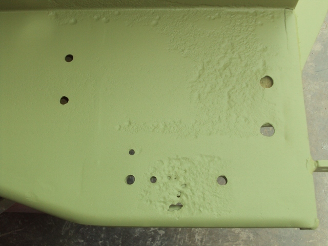

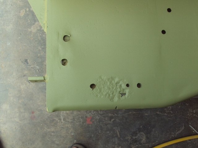

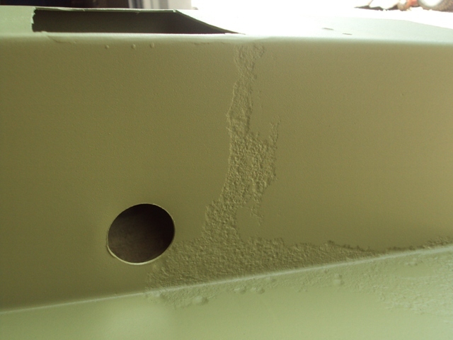

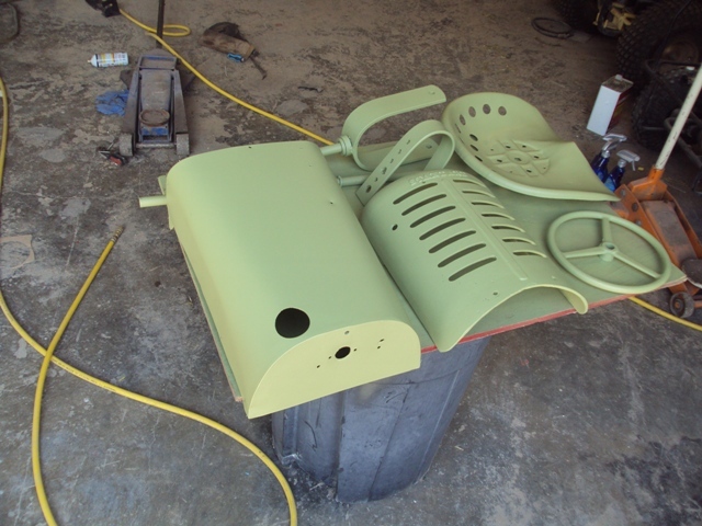

bowtiebutler956 650 #92 Posted April 30, 2012 Well, I was at my paint supply at 8 this morning to buy primer. I ended up buying some self-etching primer that said it was good for both raw steel and aluminum. It was only $26 a quart as apposed to $70 for the epoxy primer. He said it would work fine. I got everything primed first thing this morning, and I took some close up pics of the rust pitting I was telling you about on the floor board. I'm definitely going to have some bondo work to do. The body also has alot of holes that have been drilled in it over the years that are going to have to go! I showed my son the pictures of his puke green tractor when I got home, and I told him that was the color I painted it! The look on his face was priceless. He sure was glad I was kidding. Matt :flags-texas: Share this post Link to post Share on other sites
Martin 2,133 #93 Posted April 30, 2012 yes matt, thats some serious rust pitting there. some of it really deep. that really deep stuff that has blown through from blasting you really need to patch it with new metal. theres really no other way to do it right..... unless you just want to do it with bondo, that is!....... reminds me of this......... Share this post Link to post Share on other sites
