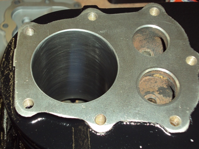

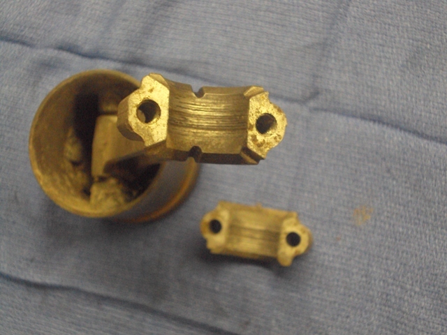

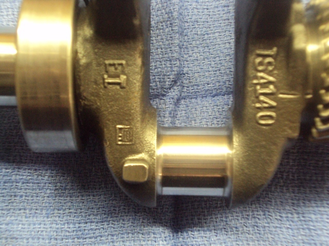

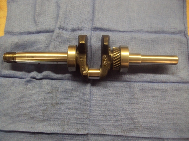

bowtiebutler956 650 #26 Posted March 15, 2012 Well, I started on the motor. I thought I would make sure she has a strong heartbeat before I did anything else, or at least as strong a heartbeat as 3hp can give you. This thing has a piston the size of a gerger baby jar! The rod is completely shot, the cylinder has little rust pits, and the crank looked pretty bad, but to my suprize it cleaned up quite easily with some 320 grit emery clothe, witch is good since I could not find a crankshaft anywhere for this ancient briggs. I did find a .020 piston, new rod, new valves, gaskets and seals for it. I am also bidding on a carburetor on as I can't seem to find the old one anywhere. Here are a few pics to show what I've been up too. Matt :flags-texas: Share this post Link to post Share on other sites

bowtiebutler956 650 #29 Posted March 15, 2012 Thanks Matt, I am going to get the block bored .020. I am also going to keep the starter/generator that my dad put on it for me as a kid. My youngest son is only 7 so he will need the electric start just like I did 30 years ago. Just the lighting Craig, I wish it was gold, I'd sell it, and that would pay for the restoration. Matt :flags-texas: Share this post Link to post Share on other sites
Flatheadpuller 6 #30 Posted March 16, 2012 That thing is super sweet. I love the three wheeler tractors. CHeck my panazer build hen you can. Its on here under pullers. The exhaust seat looks pretty ugly in the block picture. Are you going to touch those up. Share this post Link to post Share on other sites

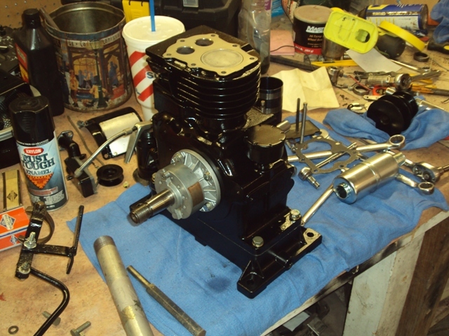

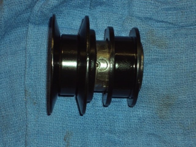

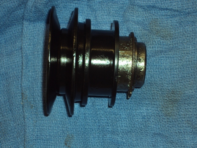

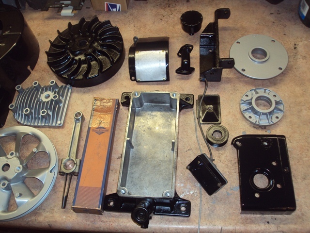

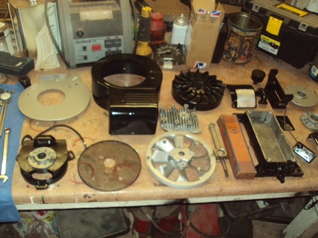

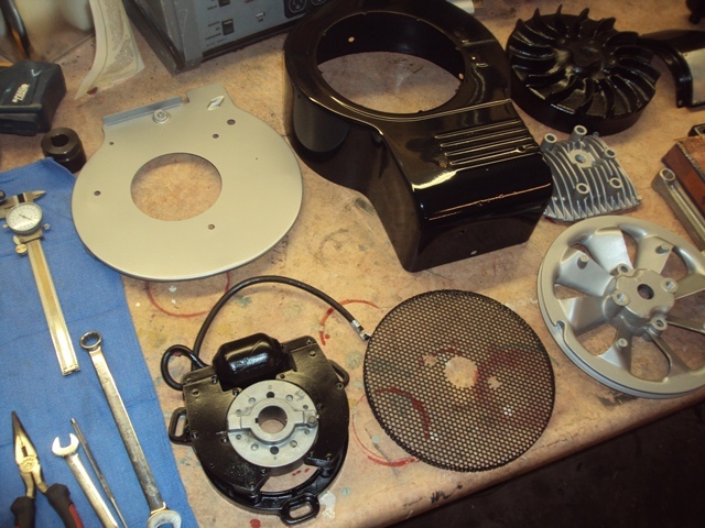

bowtiebutler956 650 #32 Posted March 18, 2012 Well, I thought I would give a quick update on my progress. I just found a carburetor with oil bath air filter on and bought it for $8 Thats good since I could not find mine. My .020 piston, rings, gaskets, seals, and valves should be here tomorrow, I already got my new rod. As soon as I get my parts tomorrow, I will drop my block off at the machine shop to be bored, and have the valve seats machined. I have already cleaned and painted most of the components for the engine. I also got the clutch back in working order, which is a miracle since it was froze solid with rust. PB blaster and a little heat with the torch. I also have figured out it is a 1952 model with the help of Daryel at panzerbantam.com who explained how to read the serial no.. My no. is 952378. The 9 is for the 9FB briggs, the 52 is for 1952, and the 378 is for the 378th model made that year. Here are a few pics of the progress made. Matt :flags-texas: 1 Share this post Link to post Share on other sites

Flatheadpuller 6 #39 Posted March 19, 2012 Matt what kind of ignition system does it have. Looks like some sort of early magnatron. The parts look killer. Did you get all you engine parts of ebay? I love that place. Just never see any panzer parts on there. Share this post Link to post Share on other sites
bowtiebutler956 650 #40 Posted March 19, 2012 Thanks to all for the encouragement! Flatheadpuller the ignition system is pionts and condenser, but the coil is different than what I normally see on briggs. The guy I got most of the parts from I did find on but the parts I needed were not listed there, but he did have his phone no. listed, and he has every part for an old briggs you could ever want. His ebay name is woodrow5810 and his no. is 540-273-7541. If you need something, he's very friendly and helpful. You said your having a hard time with Panzer parts, have you tried panzerbantam.homestead.com, the guy there Daryel makes alot of reproduction parts for Panzer and Bantam, also a very friendly guy. If you haven't checked him out, you really should. He also has used parts. Matt :flags-texas: Share this post Link to post Share on other sites

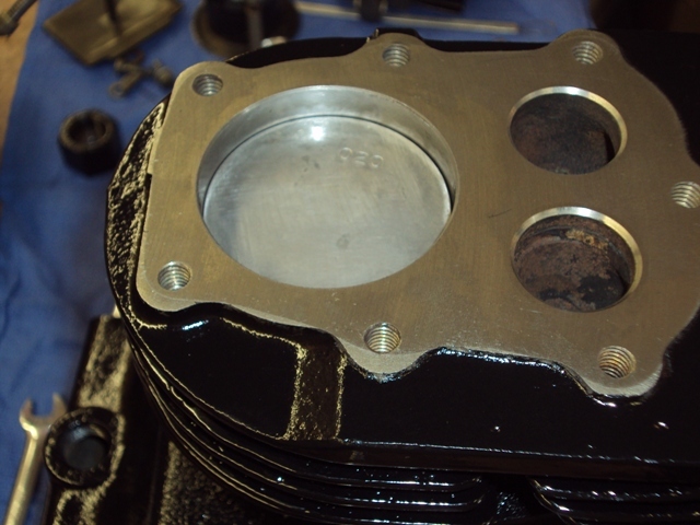

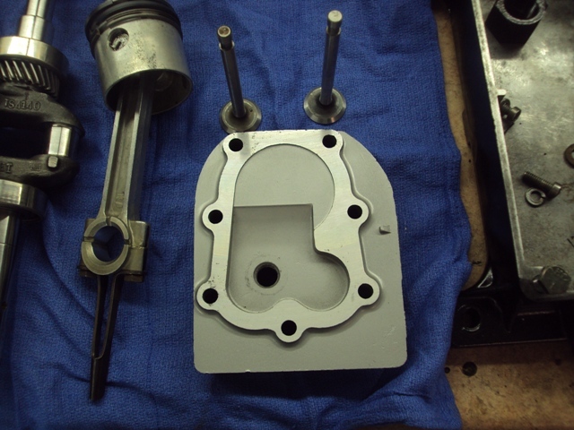

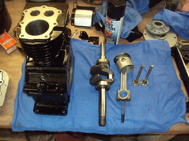

bowtiebutler956 650 #41 Posted March 22, 2012 Thought I would give a quick update. I got the block back from the machine shop, and I got my parts which includes piston assembly .020, new rod, new valves, gaskets and seals. This little engine is definitely from before my time, I opened up the old Briggs boxes that the seals were in and the seals were leather, not rubber. This is the first time I have ever installed leather seals in an engine. Anyway here are a few pics. Matt Share this post Link to post Share on other sites
Martin 2,134 #42 Posted March 22, 2012 matt, engine looks great. its been a long time since installing leather oil seals for myself. one thing with leather, you really need to soak them overnight in oil to prepare them before installation. i used to have some old cars back home that had leather seals in the engine and they would leak bad if not prepared properly. i did a quick search for you for some info...... http://www.leatherseals.co.uk/ Share this post Link to post Share on other sites
bowtiebutler956 650 #43 Posted March 22, 2012 I suppose I could take it back apart and let them soak, all I did was rub them down with oil several times since I got them in a couple days ago. What do you think Martin? Matt Share this post Link to post Share on other sites
Martin 2,134 #44 Posted March 22, 2012 what are they sealing? if they are easy to remove, i would do it and let them soak well. are they installed in the 'castings' that ive out lined in the pic? if they are can you just unbolt them without removing the seal from that part. i wouldnt remove them altogether as you will most likely damage the seal. better to do it now and soak them properly, i have learnt the hard way with them and once you have it altogether and running isnt the time to be dealing with leaky seals. maybe they would swell enough when running, maybe not......... Share this post Link to post Share on other sites
bowtiebutler956 650 #45 Posted March 22, 2012 Yes they are in the casings you outlined. I knew I should have read up on them before installing as I had never delt with leather seals before. Oh well, I will take them back apart and let them soak. Thanks for the heads up Martin, glad to know you got my back. Matt Share this post Link to post Share on other sites
Martin 2,134 #46 Posted March 22, 2012 No worries mate. Sometimes it's things like this that trip you up. I have only my dad to thank me for this little bit of knowledge. It's amazing how you can forget about stuff like this for 20 years or more and just when you come across something like this, it's there. I only wish I'd paid more attention to his knowledge when he was there. He passed in 1991 and like a lot of others from that generation took a bunch of this sort of stuff with him. Share this post Link to post Share on other sites
