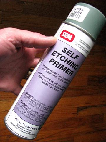

This is the stuff. :popcorn:
craig, where did you find this brand? I"ve bought this stuff before but haven't seen it lately because my local auto paint shop went out of business.
Thanks for the pic. Terry
AMC RULES
Yeah, local auto paint store...but I just searched ebay, it's there too.
