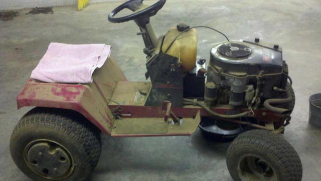

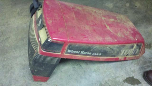

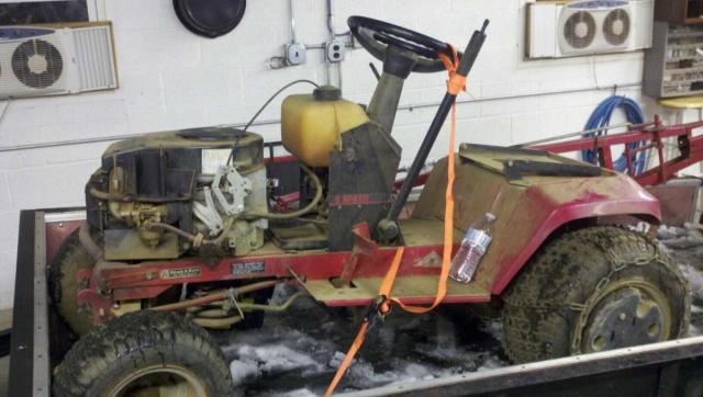

mkevinr63 4 #1 Posted March 7, 2012 I have a "85" 310-8 that I have been wanting to get a snow blade for, I finally found one in my area for 150.00. Went to look at it and other than being outside for about 2 years it looks almost unused! As we were looking at the plow, I noticed the ever so faint black grill on a very typical barn find tractor. Sure enough, a 90's TORO model 244-5. I asked what we wanted, he said make an offer so I offered him 175.00 for both. He took it and off I went plow and 244 in hand. I had the carb off, cleaned it up, changed the oil and spark and she's running albeit a little sluggish. (My neighbors love me at 9:30PM) I think I need a fuel filter and a tank cleaning, add those to a good bath and I think she'll be an OK wagon puller. Question is, the carb leaks when it's not running. I had it sonic cleaned and the guy suggested a rebuild kit only available from Onan and only 130.00? All I think I need is the float valve, any ideas? Any thoughts on that Onan? Oh yea, need some seat springs too, that towel is not going to last long! Share this post Link to post Share on other sites

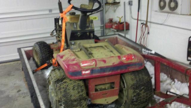

KC9KAS 4,745 #2 Posted March 7, 2012 With wheel weights and chains! Share this post Link to post Share on other sites
mkevinr63 4 #3 Posted March 7, 2012 Yeah, I don't know much about the Toro tractors but I did get weights and chains. I could probably sell it for mor ethan the 25 I have in it but I think I may keep it for a wagon and snow tractor. Share this post Link to post Share on other sites
mrocket49 23 #4 Posted March 8, 2012 "Question is, the carb leaks when it's not running. I had it sonic cleaned and the guy suggested a rebuild kit only available from Onan and only 130.00? All I think I need is the float valve, any ideas?" While you're sorting out the carb. you could install a fuel shut-off valve between the fuel filter and carb and then just shut the fuel off after use (or shut off the fuel a couple minutes before shutting off the engine and use up the fuel in the line and bowl). Share this post Link to post Share on other sites
