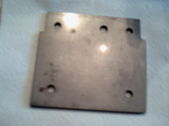

whc160 80 #9 Posted March 3, 2012 I found on my on C-160 that the shifter was hitting the plate with the shift slots. Went to my local dealer & asked him if he had seen it before. He walks back to the shelf & comes out with a plate. made this as a fix for the factory trans plate because they crack. The part # is 114285. Went back & got another one for Dad's tractor. Then went back a few days later & he asked me if I had used it yet. I asked him why & he said he could not get another from Toro. So we took it to a local machine shop & got some made. Share this post Link to post Share on other sites
tgranthamfd 29 #10 Posted March 3, 2012 I found on my on C-160 that the shifter was hitting the plate with the shift slots. Went to my local dealer & asked him if he had seen it before. He walks back to the shelf & comes out with a plate. made this as a fix for the factory trans plate because they crack. The part # is 114285. Went back & got another one for Dad's tractor. Then went back a few days later & he asked me if I had used it yet. I asked him why & he said he could not get another from Toro. So we took it to a local machine shop & got some made. Got any pictures of the fix? Maybe old and new side by side? Share this post Link to post Share on other sites
whc160 80 #11 Posted March 3, 2012 Here is a pic of the trans plate before the repair. I found out about the plate after I had removed the trans. You can put the plate in with out removing the trans. The last one I took two bolts out & install guide studs took the other bolts out. Slide the plate on & put the bottom bolts in. Then removed the studs & put the top bolts in. Last welded the plate on each side & painted. I don't have any after pics but I will get one & post it. You have to put in new bolts that are 1/4 inch longer. Share this post Link to post Share on other sites

whc160 80 #14 Posted March 3, 2012 This is the plate that I put in my horse. He is a pic of a new plate. Share this post Link to post Share on other sites
whc160 80 #15 Posted March 3, 2012 Here is a pic of the plate with measurements. Hope this helps. 1 1 Share this post Link to post Share on other sites

WH854 45 #20 Posted March 8, 2012 Well the brown truck came today left this for me. I must have got the last one I plan on checking around and seeing if I can get some made Chas 1 Share this post Link to post Share on other sites
Forest Road 595 #21 Posted March 8, 2012 Chas Hats great! Can you measure that and check it against the measurements listed above. My horses are far from home or I'd compare myself. Thanks Kevin Share this post Link to post Share on other sites
WH854 45 #22 Posted March 8, 2012 Chas Hats great! Can you measure that and check it against the measurements listed above. My horses are far from home or I'd compare myself. Thanks Kevin Yes Kevin I come up with the same as above Chas Share this post Link to post Share on other sites
whc160 80 #23 Posted March 8, 2012 Chas glad to see you got a plate. I took my to my local metal shop that has a computer laser cutter. They made me one & kept the program. So if I need more I can just call them up & they will cut it out. Share this post Link to post Share on other sites
