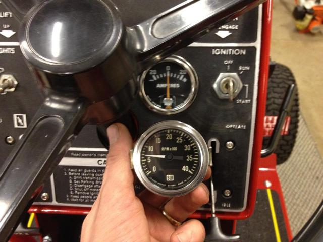

Martin 2,135 #26 Posted September 19, 2012 just a small update on my search for a tach for the c125. i picked up a 520 tach off ebay a week or so ago, said it wasnt able to be tested, so i bought it condition unknown. well hooked it up and its perfect!!! now i just need to make up a small harness for it and install it in the hourmeter side of the dash... i cleaned it up, didnt like the black bezel, so i carefully scraped the black paint off and polished it to match the ammeter..... here it is.... after its installed i will post in my c125 thread about the install....... 1 Share this post Link to post Share on other sites
Save Old Iron 1,576 #27 Posted September 19, 2012 Very nice touch with the chrome bezel. As long as you are using an 18 segment stator, the gauge will have no problem in its new home. Share this post Link to post Share on other sites
Martin 2,135 #28 Posted September 19, 2012 chuck, i thought id take a chance and try it out. it was a gamble if the gauge even worked, so im a happy man right now, hooked it up and works great!!!! so i guess i have a gauge that works and the right stator. i should try it out on the c160 as well.... Share this post Link to post Share on other sites
