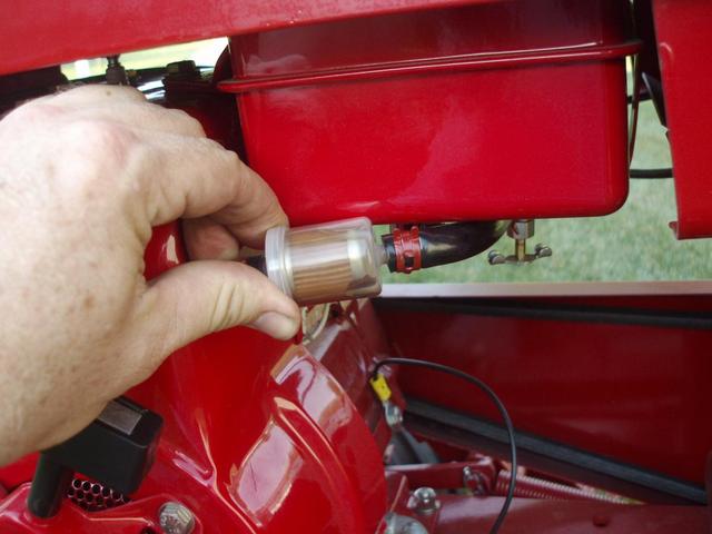

Terry M-(Moderator) 2,301 #204 Posted September 5, 2013 Well I have good news. The 606 runs and I drove it around the yard several times...but , It died again. worked on it all day and couldn't find anything wrong with the ignition system. so I took the carb apart and it was kinda dirty. so I cleaned it up and wham!!! she started and ran good!!! sound like a carb problem...yep! so why did it stop...I'll show you what going into the brand new Tecumseh carb. Filter Looks dirty huh! my guess is its sand blasting media. the tank was full off it when I assembled the engine so I vacuumed and rinsed it out many times and put it in a 175 degree oven to dry it out so it wouldn't rust on the inside of the tank. well, next day off I'm taking the carb apart again to see whats in it. My guess is its full of something.... we'll see. Share this post Link to post Share on other sites

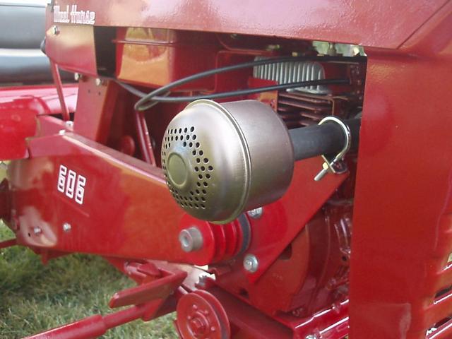

Terry M-(Moderator) 2,301 #205 Posted September 5, 2013 Also, the five minutes I ran this tractor the muffler turned a bronze color. is this normal for silver muffler paint to burn up this quick??? just curious. or is this thing running too hot. it had lots of power the few minutes I drove it around. Share this post Link to post Share on other sites
bowtiebutler956 650 #206 Posted September 5, 2013 Glad to hear you got it going Terry! That is definitely some nasty stuff coming out of the tank. As far as the muffler goes, you have to cure high heat paint correctly, or it will burn off just like regular paint. I use header paint on mine, and I start them up, and let them run about 30 seconds, then shut them off to let them cool. I repeat this process several times, letting the engine run a little longer each time. After its cured properly, the paint won't discolor, or burn off. Matt 1 Share this post Link to post Share on other sites

Retired Wrencher 6,723 #215 Posted September 8, 2013 Also, the five minutes I ran this tractor the muffler turned a bronze color. is this normal for silver muffler paint to burn up this quick??? just curious. or is this thing running too hot. it had lots of power the few minutes I drove it around. Hi Terry in my book that is a color u can never get with paint it looks natural to me. I will posts some picks of my 606 today if I can. Great job so far. Gary B.... Share this post Link to post Share on other sites

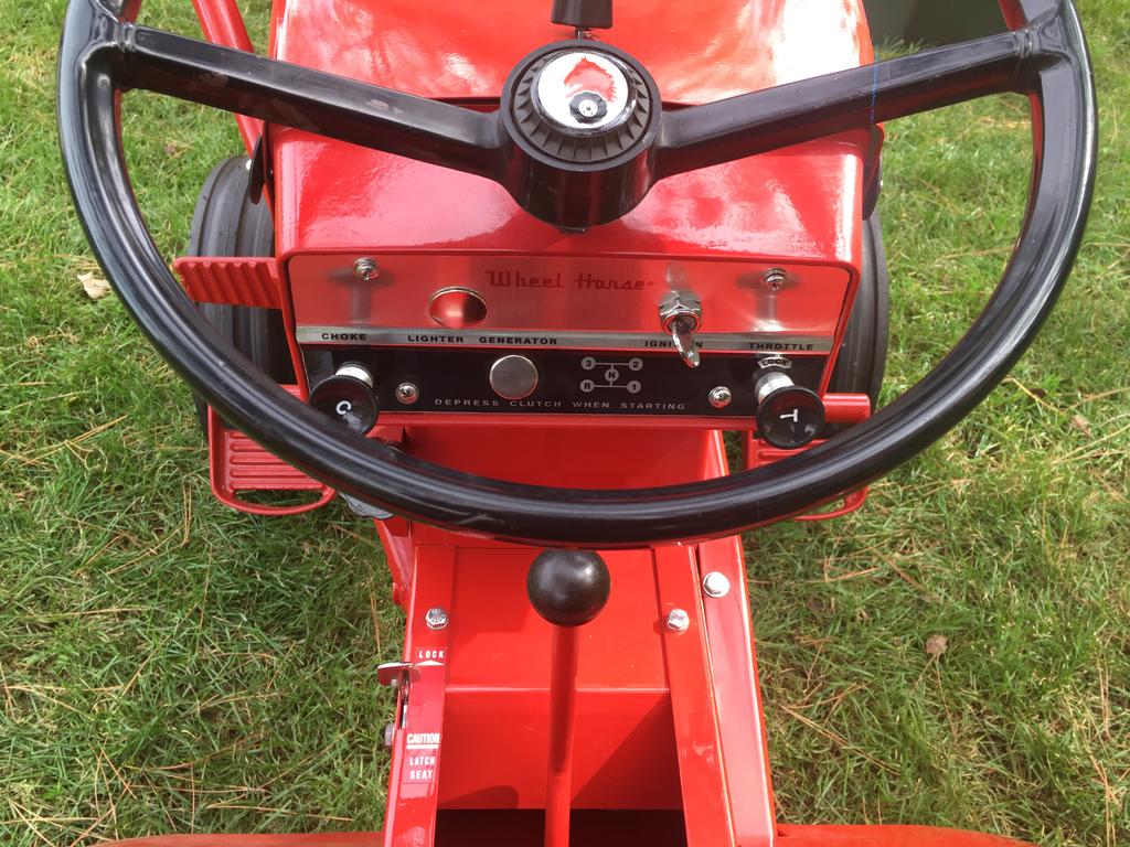

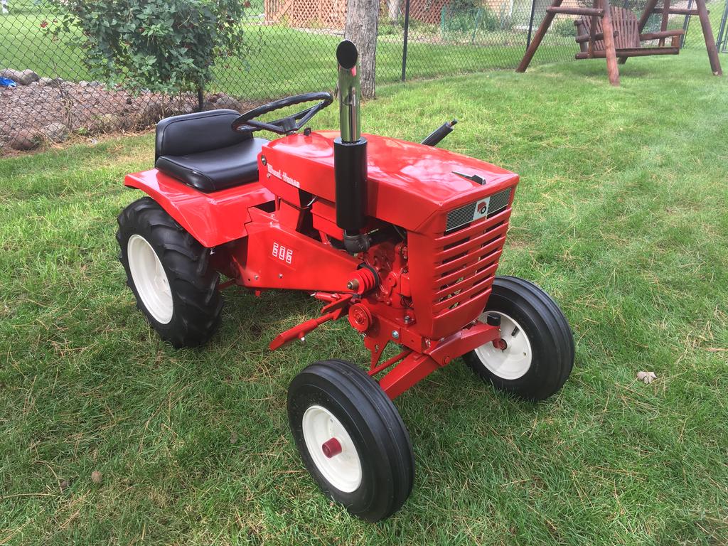

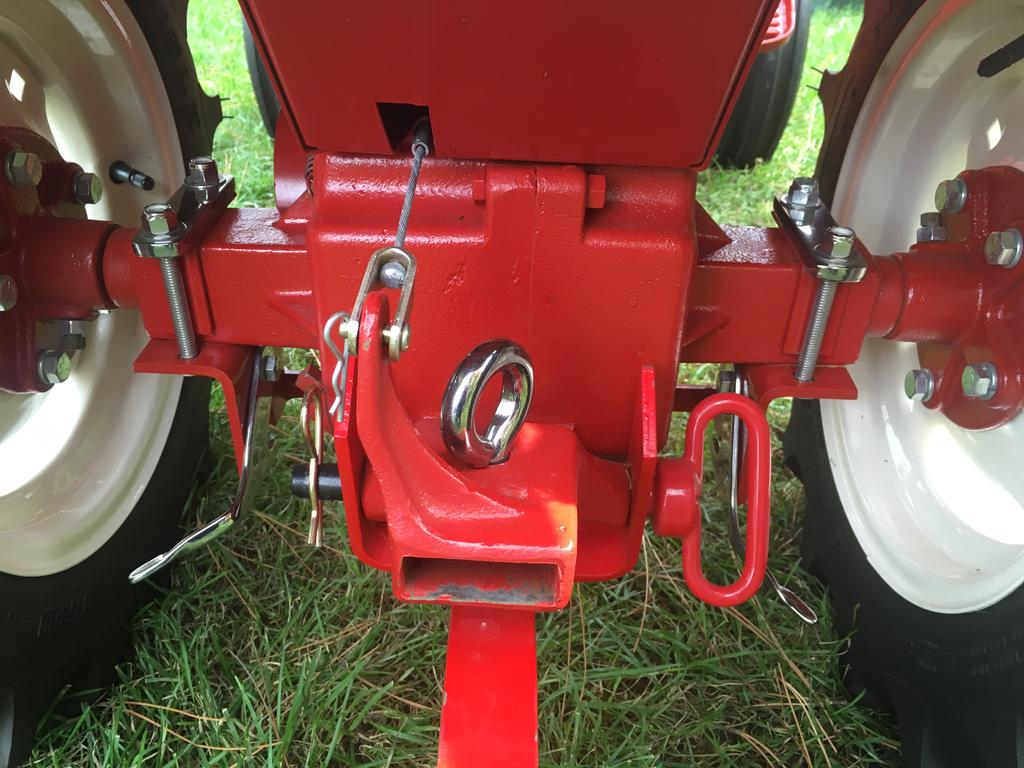

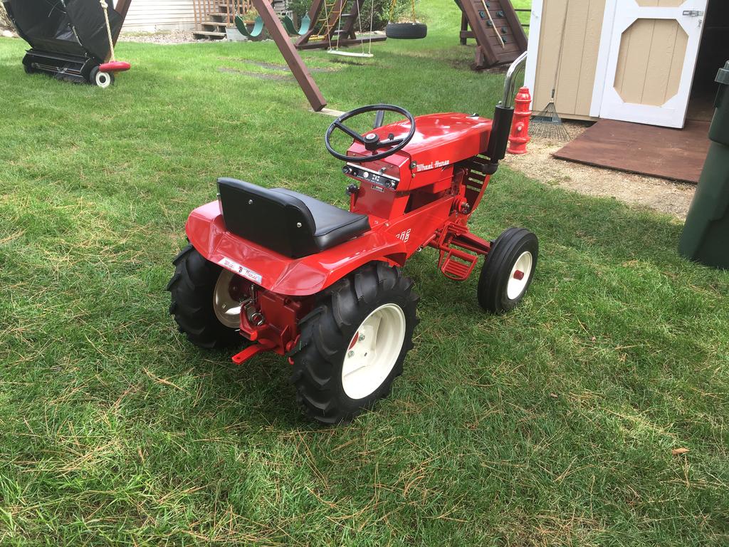

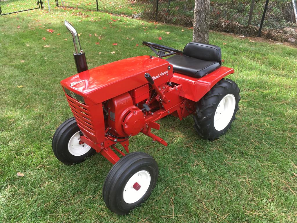

Terry M-(Moderator) 2,301 #216 Posted February 28, 2018 Took these pics last October and as you can see, I junked the Tecumseh!! Warmer weather is coming and getting ready for a new project as this one just dragged on too many years.....So I'm calling this one done!!! 1 9 Share this post Link to post Share on other sites
Pullstart 70,089 #217 Posted February 28, 2018 Thanks for bringing this one back to the top! Magnificent work! Share this post Link to post Share on other sites
dclarke 4,268 #218 Posted February 28, 2018 I like that stack, Terry! Great job on the tractor! Share this post Link to post Share on other sites
Shynon 7,594 #219 Posted February 28, 2018 Looking good Terry, hope to see it make a parade lap this year. 1 Share this post Link to post Share on other sites
