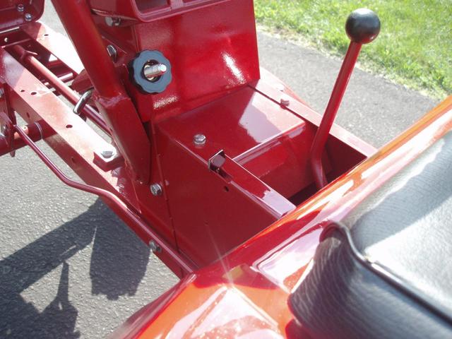

Terry M-(Moderator) 2,253 #176 Posted July 10, 2013 Thought I'd bring my 606 topic back to the top and show the parts I had chromed and I painted for the 606 and Andrew's lawn ranger. 2 1 Share this post Link to post Share on other sites

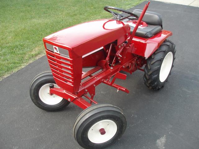

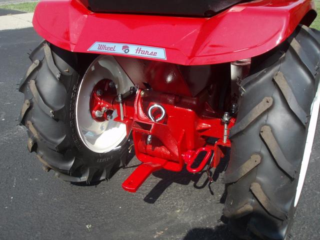

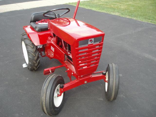

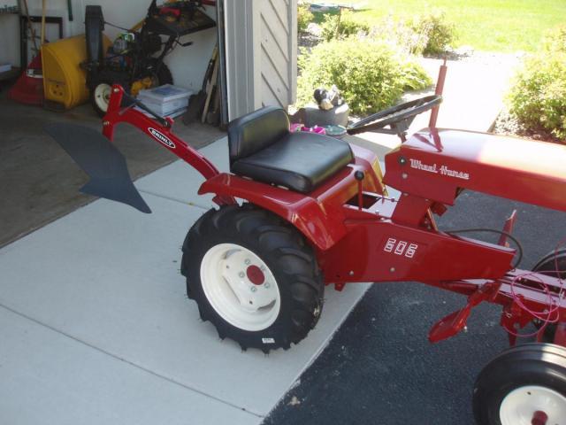

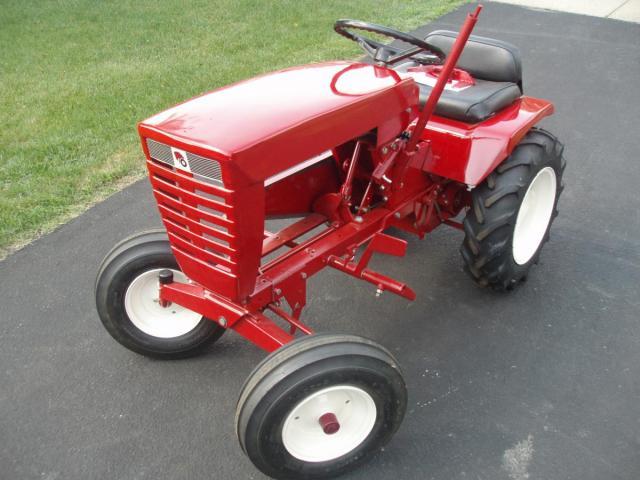

Terry M-(Moderator) 2,253 #177 Posted July 10, 2013 And pulled out the 606 today and dusted it off. Heres a few pics of the tractor after I pushed it out side and put some chrome parts on today. What you see is pretty much what it looked like when I put it away last fall. Looks nice but you can see the flaws when you get close. But its just a yard tractor so in time its sure to get scratched up anyway. Engines apart right now and I'm hoping to have it running by early August. heres a few pics.... 4 2 Share this post Link to post Share on other sites
Jake Kuhn 1,579 #178 Posted July 10, 2013 Wow that looks awesome terry! Your giving me the itch to get the other tractors done so I can start restoring my 867! Share this post Link to post Share on other sites
Terry M-(Moderator) 2,253 #179 Posted July 11, 2013 Wow that looks awesome terry! Your giving me the itch to get the other tractors done so I can start restoring my 867! Thanks Jake, I'm slowly going to get this thing done by summers end.... Share this post Link to post Share on other sites
Ken B 3,201 #180 Posted July 11, 2013 That looks awesome Terry! I can't wait to see it when its totally done. 1 Share this post Link to post Share on other sites
CasualObserver 3,411 #181 Posted July 11, 2013 Ummm.... hate to break it to you Terry, but LeSueur was cancelled. Guess you'll just have to stay home that weekend. Seriously though... that is looking sweet! Can't wait to see it. 7 weeks from tomorrow!! 1 Share this post Link to post Share on other sites
JC 1965 1,532 #182 Posted July 11, 2013 Wow !! That tractor looks amazing. You did a great restoring it. Thanks for sharing the pics. 1 Share this post Link to post Share on other sites
Shynon 7,485 #183 Posted July 12, 2013 Nice looking resto, can't wait to see it. Tom Share this post Link to post Share on other sites
userj8670 68 #184 Posted July 12, 2013 Thats a sweet looking machine - def makes me want to go find one to restore. If you dont mind me asking - how much would you say that you have tied up in her money wise? Keep up the great work! Jim Share this post Link to post Share on other sites
Terry M-(Moderator) 2,253 #185 Posted July 12, 2013 Thats a sweet looking machine - def makes me want to go find one to restore. If you dont mind me asking - how much would you say that you have tied up in her money wise? Keep up the great work! Jim Jim, I haven't completely added things up. And for safety reasons I better not publish it where my wife could see it . But I can tell you so far it's alot more than I could ever sell it for. so thats why I'll have it forever 2 Share this post Link to post Share on other sites
bowtiebutler956 650 #186 Posted July 13, 2013 That is absolutely gorgeous Terry!! I can't wait to see the engine back in it. Fine work for sure! Matt 1 Share this post Link to post Share on other sites

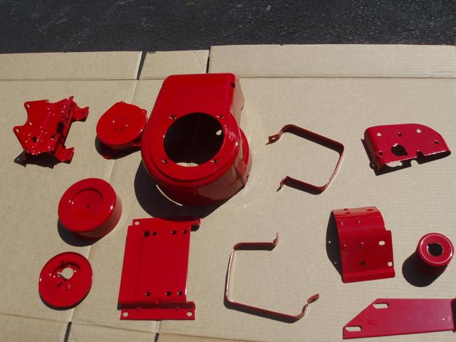

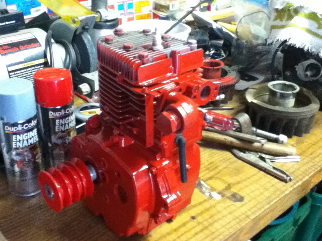

Terry M-(Moderator) 2,253 #187 Posted July 23, 2013 Picked up some engine parts from the powder coater today. Looks Nice! But the gas tank didn't fare so well. the solder melted during the heating process and fell apart .....so I'm having it welded by a gas tank guy and then getting it re-powdered next week. for some reason the parts in the pic look blotchy. But to the naked eye they look nice!! 3 Share this post Link to post Share on other sites

bowtiebutler956 650 #189 Posted July 24, 2013 Those parts look Fantastic Terry!! I'm sorry to hear about your gas tank, that would be upsetting, but I'm sure it will look great when its done. I've never had anything powder coated before, but maybe someday. Matt Share this post Link to post Share on other sites
Terry M-(Moderator) 2,253 #190 Posted July 24, 2013 Those parts look Fantastic Terry!! I'm sorry to hear about your gas tank, that would be upsetting, but I'm sure it will look great when its done. I've never had anything powder coated before, but maybe someday. Matt Thanks Matt!! Painting is hard for me and very time consuming. so I've been getting some stuff powdered to speed things along. Now that I have red powdered parts , you may be able to see three different reds on my 606.(red powder paint and two colors of other red paint) oh-well.... I think my next tractor will be all powder coated. Share this post Link to post Share on other sites

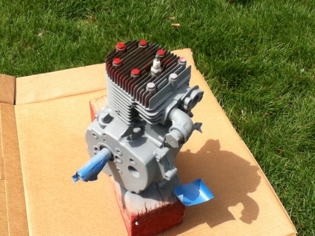

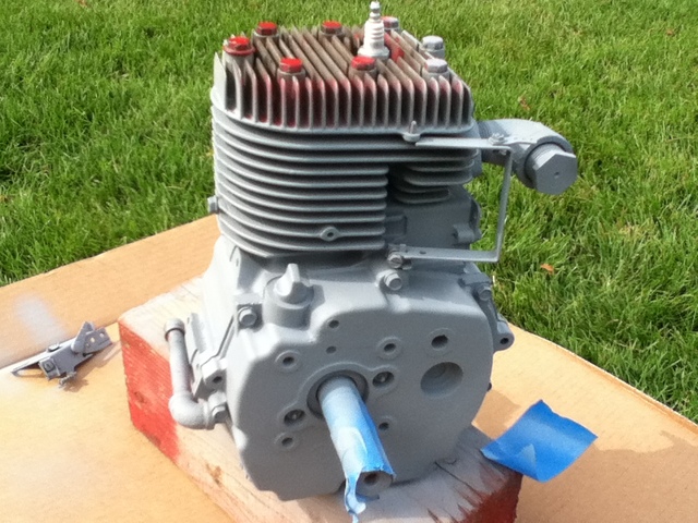

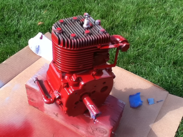

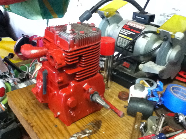

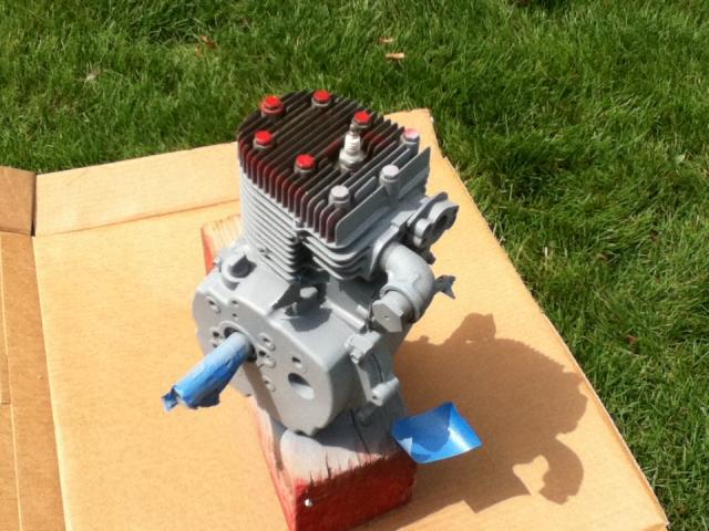

Terry M-(Moderator) 2,253 #194 Posted July 29, 2013 Another step finished today Finished putting the HH60 short block together today...all outside surfaces were already blasted twice before(rust happens fast ). Then before I started painting I wiped all outside surfaces with cleaner, primed with high temp primer, then painted Red with dupli-color Engine Enamel. The pulley was powdered with the engine tins and the cylinder head you see is a junk one I lightly bolted on just for the paint job. The actual cylinder head for this engine will be just the natural aluminum color. Now I just need to keep on putting it together. The hardest part of that will be timeing the breaker point assembly with the engine.....I'm reading up on it tonight...we'll see . 1 Share this post Link to post Share on other sites
bowtiebutler956 650 #195 Posted July 29, 2013 I have no doubt that you'll have it running in no time Terry! By the way that engine is Gorgeous! Matt 1 Share this post Link to post Share on other sites

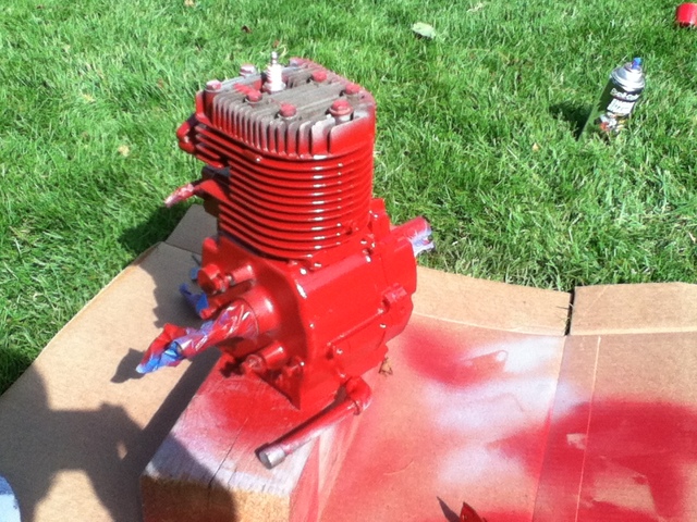

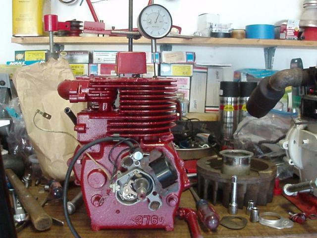

Terry M-(Moderator) 2,253 #199 Posted August 7, 2013 (edited) Spent yesterday working on timing the HH60 for the 606. Had to move the magneto to the max clockwise adjustmment to get this engine within the timing spec. Thats my only worry about getting this thing running. used a multitester to indicate when the points were breaking. Had my 9 year old Daughter help hold things for me while using the tester. she did great!! Edited August 8, 2013 by Terry M 1 Share this post Link to post Share on other sites

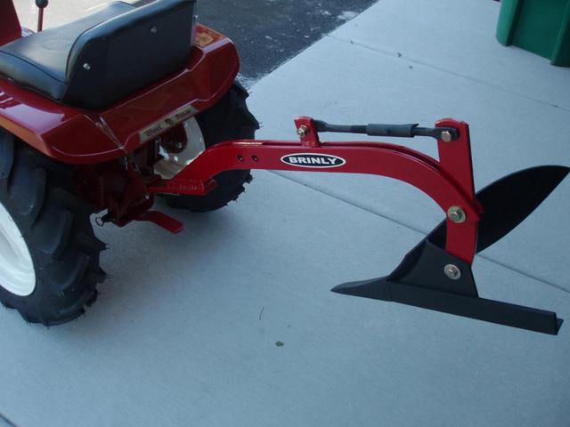

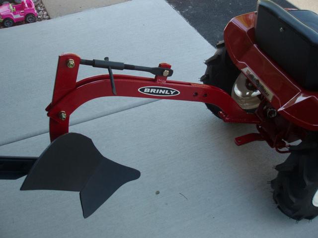

Terry M-(Moderator) 2,253 #200 Posted August 7, 2013 And spent today taking a brief break from working on the engine to finish this project I was making for the 606...a Brinly plow. I think it looks good. 5 Share this post Link to post Share on other sites
