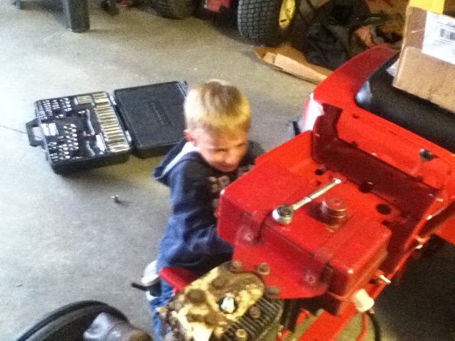

Terry M-(Moderator) 2,304 #159 Posted September 28, 2012 have made some progress on the 606. slowly fixing up the engine so it will run and today worked on the steering shaft so that the locking collar and steering wheel would fit on. Had to cut the old steering shaft out last spring so I could remove the steering wheel from it using a press. Here's a couple pics of the 606 while we were working on it. 3 Share this post Link to post Share on other sites
bowtiebutler956 650 #160 Posted September 28, 2012 I've been wondering how things were going with you, and the 606 Terry! I was just about to send you a PM to find out, but I can see all is well. Your boy looks right at home working on the ! Your 606 really is looking Fantastic! Matt :flags-texas: Share this post Link to post Share on other sites
Terry M-(Moderator) 2,304 #161 Posted September 28, 2012 I've been wondering how things were going with you, and the 606 Terry! I was just about to send you a PM to find out, but I can see all is well. Your boy looks right at home working on the ! Your 606 really is looking Fantastic! Matt Thanks Matt, It's far from perfect but what the heck...it's just a yard tractor. Share this post Link to post Share on other sites

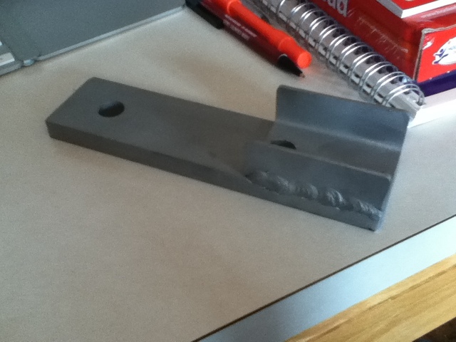

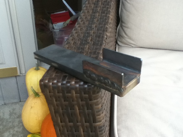

Terry M-(Moderator) 2,304 #164 Posted October 18, 2012 bought a slot hitch mold board plow for the 606 this past summer. I was told it was from an RJ tractor and I didn't know the slot hitch on those RJ's is slightly smaller that my 606's slot hitch.....I wanted to keep it because I really liked the plow.so here is how I made a cheap fix. I just cut a piece of steel stock that would fit in my slot hitch and cut a piece of square steel stock down the middle and welded it to the other piece of steel. the slot hitch for the 606 is half an inch wider than the plows hitch so the sliced piece of square tubing helped make up the difference. here is what it looks like. Share this post Link to post Share on other sites
Terry M-(Moderator) 2,304 #165 Posted October 18, 2012 here it is with holes drilled and some sand blasting to clean it up. Share this post Link to post Share on other sites

Terry M-(Moderator) 2,304 #167 Posted October 18, 2012 here is the finished product. Share this post Link to post Share on other sites

Terry M-(Moderator) 2,304 #173 Posted October 18, 2012 I must add that the reason I did it this way is I wanted to keep the plow unchanged or unaltered if you will. all I have to do is remove the adaptor piece and its an original RJ plow again. I do though plan on repainting it . Now I need to get my act together and someday finish this tractor. :) 1 Share this post Link to post Share on other sites

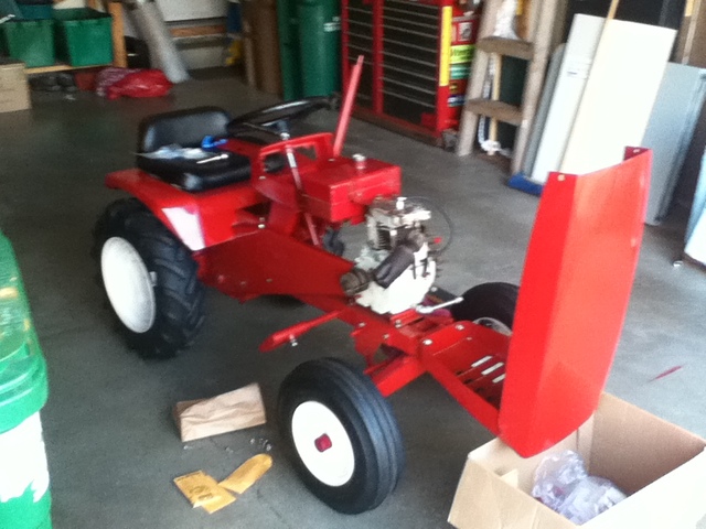

COMMANDO6 20 #174 Posted October 19, 2012 Great work so far. I agree, It's better to build an adapter instead of modifiing the original plow. But I have a question that probably a lot of people here could answer. How is the hood mount bractet thing that actually attaches the hood to the frame mounted. On my Commando, the hood opens only so much, because the bracket acts like a stopper. But I see that your hood goes all the way down. Share this post Link to post Share on other sites
Terry M-(Moderator) 2,304 #175 Posted October 21, 2012 Great work so far. I agree, It's better to build an adapter instead of modifiing the original plow. But I have a question that probably a lot of people here could answer. How is the hood mount bractet thing that actually attaches the hood to the frame mounted. On my Commando, the hood opens only so much, because the bracket acts like a stopper. But I see that your hood goes all the way down. Commando6,my hood just moves on a simple hidge held on by a couple of cotter pins. my 606 is my only square hood i have so thats the only one i can look at. as you can see in the picture above a few posts i'm using a cardboard box to keep the hood from hitting the floor. I'm trying to think of a way to hold it in an open position from hitting the ground. maybe mine is installed wrong or backwards....i'm not sure. I'm out of town now but when I get home I'll post some pics of my hood open and closed. maybe then a good comparison will answer the question. I wish my hood would hold itself open like yours.. Share this post Link to post Share on other sites
