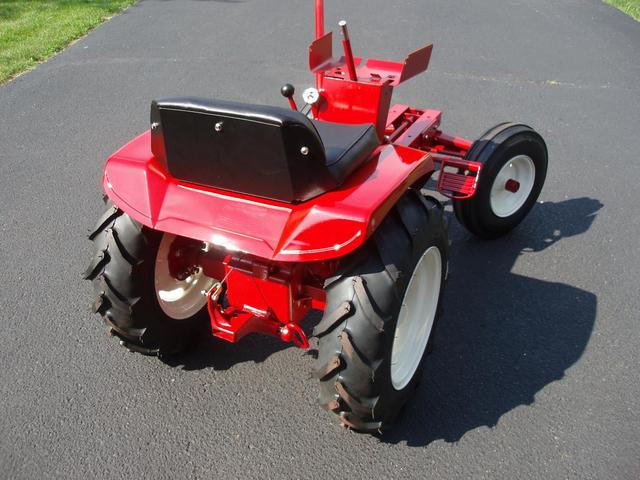

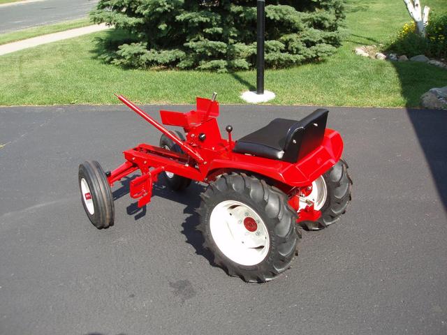

Jake Kuhn 1,598 #101 Posted May 17, 2012 She is looking really good terry! Jake Share this post Link to post Share on other sites
Terry M-(Moderator) 2,289 #102 Posted May 17, 2012 It's sure feels good to get them back on four wheels Terry. Hope yours progresses faster from this point than mine has. I really like your choice of tires. What's next? Well Denny, trying to decide if I should start on the engine or continue building the tractor itself. I'm leaning more twards finishing all the sheetmetal first, Then the engine......We'll see...Thanks, I really like the tires too. :handgestures-thumbupright: Share this post Link to post Share on other sites
bowtiebutler956 650 #103 Posted May 17, 2012 Wow, that looks great Terry! I noticed the sun was shining in the pics, and the grass is green, so I guess things are warming up some for you. That really is looking great, and I agree with Denny, the ags, and tri ribs really look sweet! Matt :flags-texas: Share this post Link to post Share on other sites
Terry M-(Moderator) 2,289 #104 Posted May 17, 2012 Wow, that looks great Terry! I noticed the sun was shining in the pics, and the grass is green, so I guess things are warming up some for you. That really is looking great, and I agree with Denny, the ags, and tri ribs really look sweet! Matt Thanks Matt, Those tires really make a tractor look good! Hopefully the weather stays nice so I can keep going and maybe someday finish the 606 restore. (before the snow flies or I might think about taking over some space in your shop ) :) Share this post Link to post Share on other sites
bowtiebutler956 650 #105 Posted May 17, 2012 Your welcome here anytime Terry Matt :flags-texas: Share this post Link to post Share on other sites

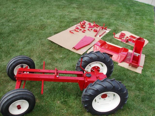

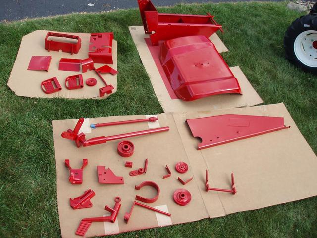

Terry M-(Moderator) 2,289 #106 Posted June 4, 2012 Took some time today to do some more painting. Will have to use some elbow grease to buff out the imperfections like cotton wood and a couple small bugs and do some small paint touch ups.....But I think It's ok. added a little x-tra gloss hardener to see if I could get a little more shine out of the paint...We'll see. If I have some time in the next few days I'll maybe do some more assembly work. 5 Share this post Link to post Share on other sites
dclarke 4,117 #107 Posted June 4, 2012 Looks good from here Terry. :thumbs: Share this post Link to post Share on other sites
bowtiebutler956 650 #108 Posted June 4, 2012 Looks Fantastic Terry!! Glad to see your back at it, and that is going to be one fine looking ! Matt :flags-texas: Share this post Link to post Share on other sites
Terry M-(Moderator) 2,289 #109 Posted June 5, 2012 Thanks Denny and Matt, Put the stuff in the garage for the night and noticed a big run on the front right part of the fender pan . Oh well, I'll try to buff it out or something. The paint job is so-so , but what the heck, better than what it was. :unsure: Share this post Link to post Share on other sites
Jake Kuhn 1,598 #110 Posted June 5, 2012 Looks great Terry! Jake Share this post Link to post Share on other sites
bowtiebutler956 650 #111 Posted June 5, 2012 Thanks Denny and Matt, Put the stuff in the garage for the night and noticed a big run on the front right part of the fender pan . Oh well, I'll try to buff it out or something. The paint job is so-so , but what the heck, better than what it was. Been there done that Terry, often. You should be able to buff it out, but if its large you can wet sand, then buff. I'm sure its going to look great! Matt :flags-texas: Share this post Link to post Share on other sites

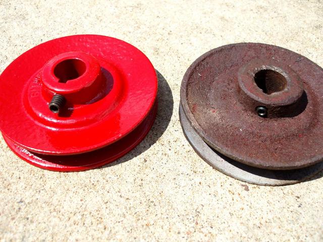

Terry M-(Moderator) 2,289 #116 Posted June 6, 2012 Forgot to ask.......anybody know where I can get a set-screw for the in-put pulley on my 5053 uni-drive trans? Can't find one at the local hardware store....They said it's a #7 and the only #7's they have are ones with metric threads.......???? Any advice appriciated, thanks Share this post Link to post Share on other sites
Martin 2,133 #117 Posted June 6, 2012 terry, what is it with that hardware store and their 'metric' everything? havent you dealt with that sort of thing before with someone from there?.......... the set screw is a 1/4-20 x 5/16. you should be able to pick up one of those. dont know where the #7 comes from? in the ipl of the 606 manual it calls out as 909849-5 Set Screw 1/4-20 x 5/16 fyi, this same part number comes up in the 1057 ipl as a nylok set screw. so you could find one that has a locking patch on it too if you wanted. ive found that the standard set screw with the cup point works just fine though. or you could put some non permanent locktite on the threads.. that hardware store looks to be one that i would work out exactly what i need before hand ( most of the fastener sizes are on the ipl of the tractor manual) and just go in there and ignore all help and just get what you need and get outta there! tractors looking real nice by the way......... :thumbs: Share this post Link to post Share on other sites
Terry M-(Moderator) 2,289 #118 Posted June 6, 2012 I know what you mean about the hardware store, but it's really my only local ave. for those sorts of things and I sometimes seem to be a little challenged in this area. I'll try again but I know they tried 1/4 inch or at least they say they did when I actually broght the pulley in. I'll go in with the info you gave me. That seemed to work last time. Thanks again martin. :) Share this post Link to post Share on other sites

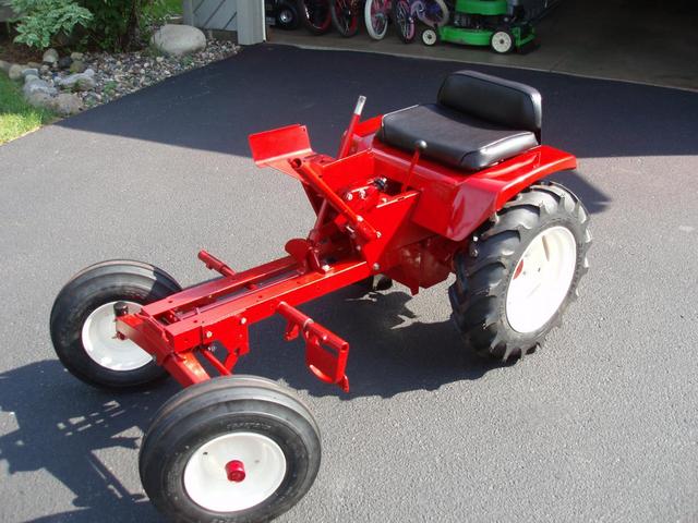

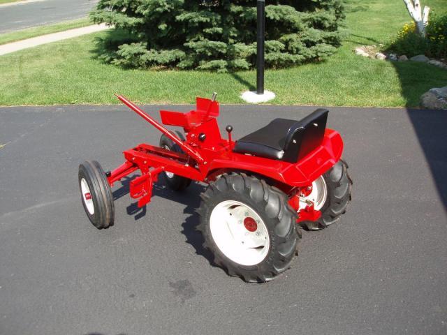

Terry M-(Moderator) 2,289 #119 Posted June 7, 2012 Put a few things together the last couple of days. can't get too much more done until I blast and paint the hood,and a few small parts and get a few of some other small parts plated. Had to put the seat on just to see how it looked. 3 Share this post Link to post Share on other sites
bowtiebutler956 650 #120 Posted June 7, 2012 :scared-eek: I think I may go blind from the sun reflecting off that !!! That looks great Terry, and the seat looks great too. I think I may have to come visit you now Terry, it looks like nice weather, its been almost 100 for the last several days now, and we've been getting some showers, so its extremely humid too! Matt :flags-texas: Share this post Link to post Share on other sites
Terry M-(Moderator) 2,289 #121 Posted June 8, 2012 Thanks Matt, It looks better in the pictures but it is looking better than I thought it would. Things may get busy at work and kids will be out of school so I may have to park it in the corner for a while. We'll see... Yes Matt, I bet Texas is very hot this time of year ...Won't be long things here will get really sticky too! :happy-bouncyredfire: Share this post Link to post Share on other sites

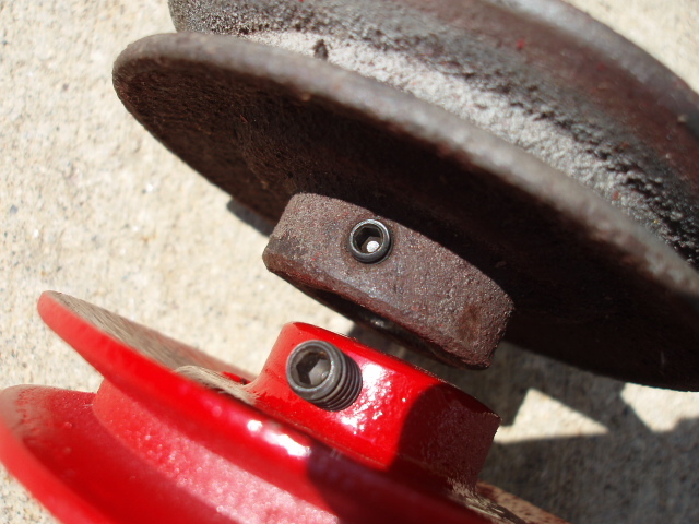

Terry M-(Moderator) 2,289 #122 Posted June 8, 2012 Martin if your out there check out the pulleys, I pulled out my tap and die set (it's an inexpensive one) and tried to see if I could find a size to chase the threads. What I found is the pulley in question(red one) is a 5/16th" and the original cracked pulley(rusty one) is the 1/4" size you refered to. Still don't know where they got the #7 metric.??? Why my replacement pulley is 5/16? Heck if I know....maybe at one point in its life the threads were damaged and someone oversized it. had to show you this so you don't think I'm nuts Thanks again for your assistance!!!!!! Share this post Link to post Share on other sites
Martin 2,133 #123 Posted June 8, 2012 terry, i think the red one at some time was tapped out to 5/16. the oem was 1/4. i dont think you have a screw loose or anything....(a set screw maybe?) the oem pulley on your tractor is a different part number than what i have on my 1057, and the setscrew on mine is positioned in the belt groove and not out like yours on the edge of the pulley. on the 606 ipl it shows the setscrew going into the belt groove as well, so not sure if you have an oem pulley or not. i dont know enough about these things. just for interest sake does either one have a part number cast into them? my ipl on the 606 is a bit blurry but i think the number is 1611? my 1057 pulley is 5425..... Share this post Link to post Share on other sites
Terry M-(Moderator) 2,289 #124 Posted June 8, 2012 Yes martin, they both have 1611 cast into them. The painted red one was given to me by Denny clark. don't know what it was off of. he may have said but I may have forgot. my rusty one is off my spare 5053 trans which came from a 857 It's cracked in the back. my original 606 5053 trans pulley is broken still stuck on my original trans. :banghead: Share this post Link to post Share on other sites
Martin 2,133 #125 Posted June 8, 2012 thanks for the info. well i guess thats one way to tell pulleys apart from 5053 and 5058 transmissions other than the part numbers. i guess the picture of the pulley in the 606 ipl isnt really 100% accurate...... Share this post Link to post Share on other sites
