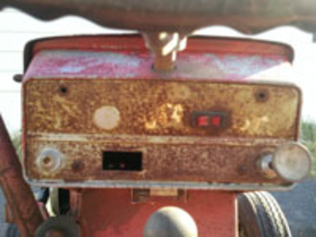

KC9KAS 4,744 #7 Posted February 19, 2012 From the looks of your photo, the tractor seems to have a nice paint job. Also looks to be missing the ignition switch. The correct switch is NLA....ask me how I know! I actually added a solenoid and a different switch to start mine. Share this post Link to post Share on other sites
cdn97 6 #8 Posted February 19, 2012 Thanks for all of the info. Here is a photo of my dash. There is a toggle switch that shouldn't be there, but im not sure if there was a key or not. The motor is a pullstart. Any input is appreciated. 1 Share this post Link to post Share on other sites

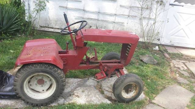

rjwhorse700 7 #10 Posted May 16, 2014 I just got done painting my wh700 last night. First restoration Ive ever done. I didnt go completely original because I only had a bare frame with like new original tires! I went with black bed liner coating for the frame and snow blade. Then ih red for the rest. Mine had no dash plate so I made one from 1/16 plate steel. Not sure what options im goin to put on it. Any ideas? Im not quite computer savy enough to post pics but they are to come. 1 Share this post Link to post Share on other sites
rjwhorse700 7 #11 Posted May 16, 2014 (edited) H Edited May 16, 2014 by rjwhorse700 1 Share this post Link to post Share on other sites
rjwhorse700 7 #12 Posted May 16, 2014 (edited) The day I brought her home. Sent from my SAMSUNG-SGH-I337 using Tapatalk Edited May 16, 2014 by rjwhorse700 1 Share this post Link to post Share on other sites
rjwhorse700 7 #13 Posted May 16, 2014 The day I brought her home. Sent from my SAMSUNG-SGH-I337 using Tapatalk Sent from my SAMSUNG-SGH-I337 using Tapatalk 1 Share this post Link to post Share on other sites

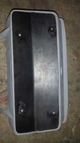

rjwhorse700 7 #14 Posted May 16, 2014 This is my dash plate. Not sure about the accessories. Im thinkin cigarette lighter so I can charge my phone! Sent from my SAMSUNG-SGH-I337 using Tapatalk 1 Share this post Link to post Share on other sites

rjwhorse700 7 #18 Posted May 31, 2014 I got my instrument panel done except for the holes drilled. Now im at a loss cause my fenders dont have brackets and the few that I have seen were tack welded to the fender. Do they sell a universal bracket that will bolt to the hooes I have? The ones I saw were unused and makes me wonder what the extra holes are for. Water drain? Any advice would be appreciated 1 Share this post Link to post Share on other sites
