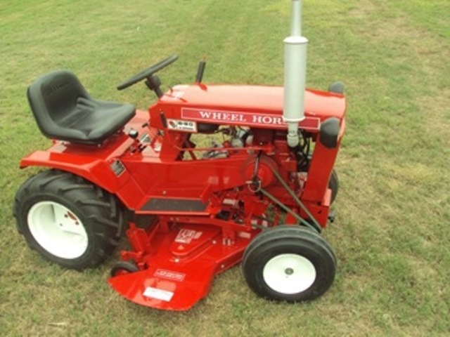

squonk 45,593 #9 Posted February 12, 2012 Tim, Thanks for bringing up this subject.I was wondering about finding these styles of tires too. I checked all of the local places I could think of but had no luck. I really like those tires martin has and was thinking of getting something like those for my 606. I think they'd look nice with my mid mount blade. Thanks guys!! So you have an idea on how it will look: 1 Share this post Link to post Share on other sites

Terry M-(Moderator) 2,291 #13 Posted February 12, 2012 mike, I like the look of those on your 704!!!!! Share this post Link to post Share on other sites

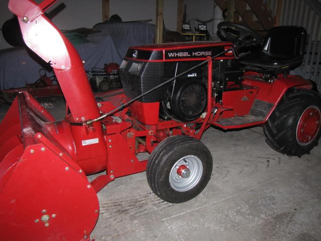

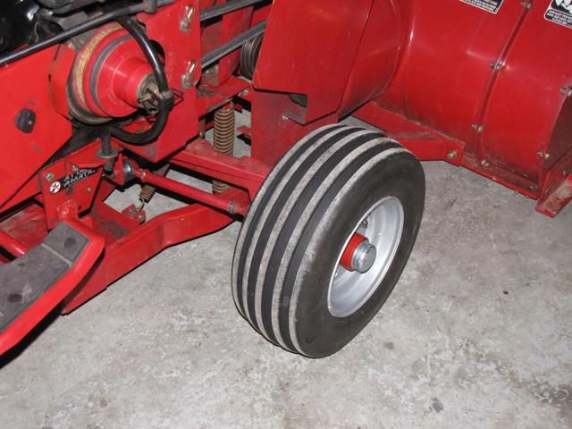

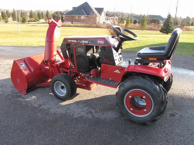

Hydro 131 #14 Posted February 12, 2012 I have Vredesteins they are about $50-60.00 They work well in snow. I had them on standard 8" rims which fit a 314. I now have them on a 4 stud rim. They are 16X6.50X8. They may be too wide though for what you want. FYI anyway. 1 Share this post Link to post Share on other sites
Trouty56 567 #15 Posted February 12, 2012 Hydro....how are your spindles set up for 4 bolt hubs?? Looks very nice....looks great!! Share this post Link to post Share on other sites
AMC RULES 37,254 #16 Posted February 12, 2012 Search "Miller tire" on ebay, nice selection of lawn tractor tires there too Tim. :handgestures-thumbup: Share this post Link to post Share on other sites
Kelly 1,037 #17 Posted February 12, 2012 Hydro....how are your spindles set up for 4 bolt hubs?? Looks very nice....looks great!! The 520 spindles for the forward swept axle are 1" and use a castle nut like a car to hold the wheel on they also use taper roller bearings, many boat trailer hubs are a direct bolt on, then you can use bolt on wheels, I did it on my 520, took about 10 min. to do the swap, but be sure to get the wheels with the correct back spacing or they may rub on the end of the axle. Share this post Link to post Share on other sites
Hydro 131 #18 Posted February 12, 2012 Yeah to that Kelly. The wheels were wider than my back tires which I did not like so I turned the rims around, drilled new holes for the tube stems, welded up the old tube stems and then shimmed out the rims with two 1/2" washers per stud to clear the ball joints. For tractor ground speeds, no great deal and I do not intend to use a FEL. I had to laugh though the tires are rated for 30 mph but I did not balance them! I needed about a 1/4" of clearance. Now everything is in line and as Kelly says it's just a matter of the castle nut and a cotter pin. When you are sitting on the tractor it's so mch nicer to see that wheel perfectly revolving around the axle and off the tractor it looks so much heavier than before. I'm sure these little things meant big dollars in production but it sure makes for a nice end result. Share this post Link to post Share on other sites
Trouty56 567 #19 Posted February 12, 2012 Very nice....I didn't know that about the 1" spindles for the 520 forward swept axle. Looks really nice!!! Share this post Link to post Share on other sites
Hydro 131 #20 Posted February 13, 2012 There are a ton of 520's out there with blown engines and not worth much. It's too bad Wheel Horse did not put that front end into other tractors. It would be a cost per unit thing but the 520 front end bolts right in as does the '91 and later gear reduction steering to a 300-400 series tractor. All I had to do was change and shorten the steering wheel shaft. The hubs I have were bought from an RS member who was thinking about putting an FEL on his 520. Share this post Link to post Share on other sites

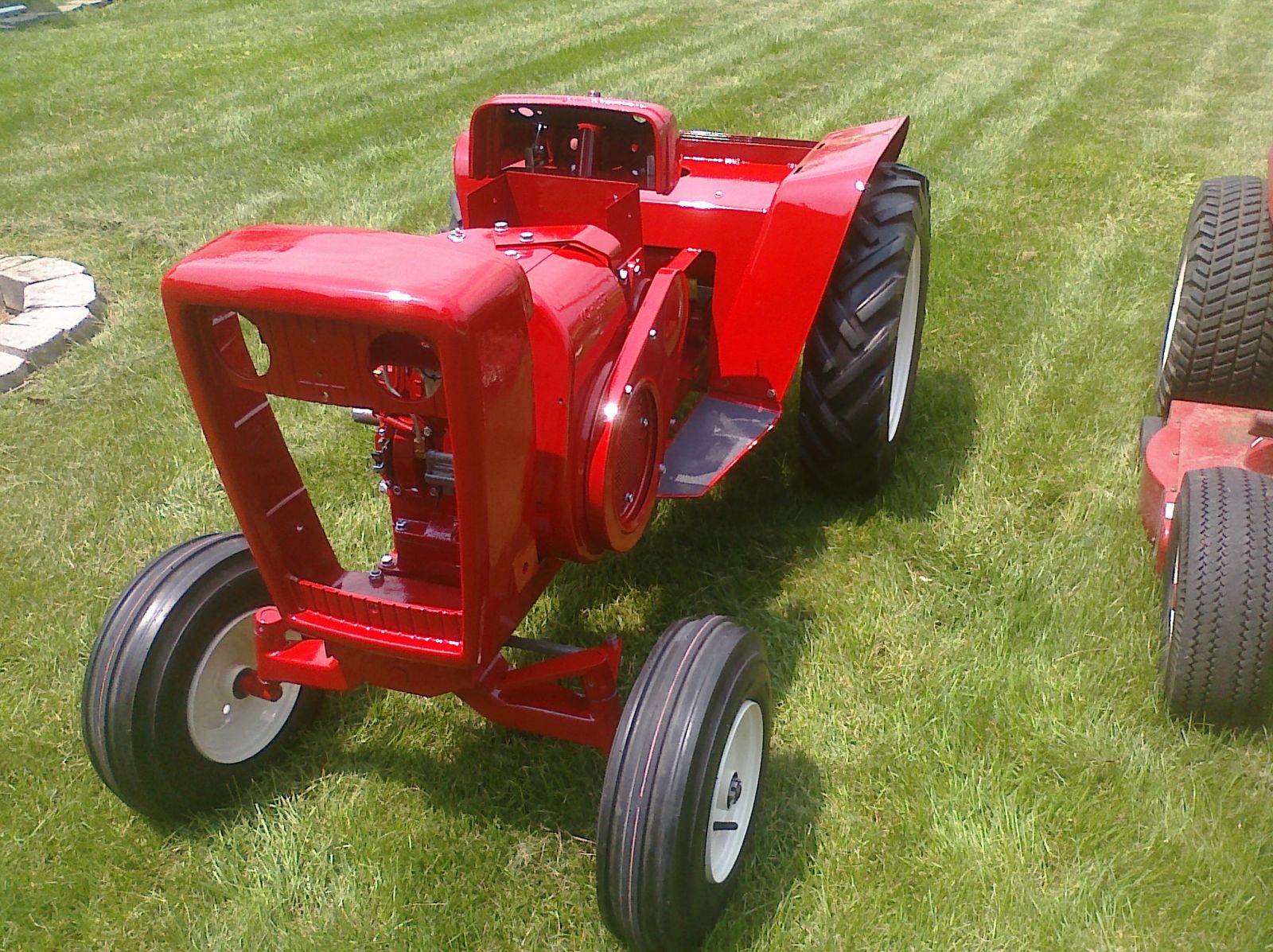

bowtiebutler956 650 #22 Posted February 16, 2012 I used the 400x8 deestone tri ribs in mine, bought them for $40 a pair plus $15 shipping from tucker tire on ebay, and I love them. 2 Share this post Link to post Share on other sites

wheelhorsekid 141 #25 Posted February 17, 2012 Do the rib tires steer better? What is the main reason to have them? Bowtie, where did you get your back set of tires? Thanks! Share this post Link to post Share on other sites
