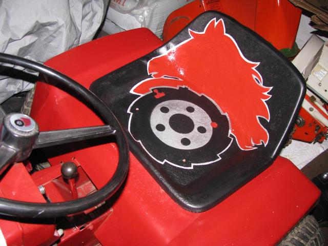

dobeleo 7 #26 Posted February 12, 2012 my 312-A was rotting when i started tearing it apart. I used Rustoleum Farm Equipment Paint (IH Red) My pic at the left is what i started with I just cleaned a hand full of parts at a time, and started primering and painting. The paint seemed to dry extremely slow and chip easy. Dan Shorewood, IL Share this post Link to post Share on other sites

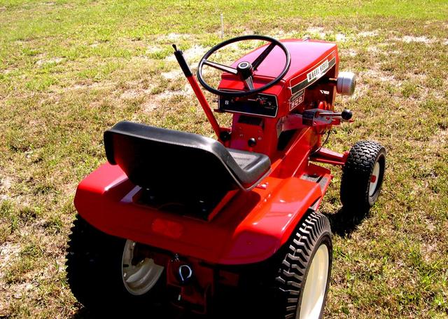

AMC RULES 37,259 #27 Posted February 12, 2012 Here's an older resto done by the PO. On a good day, it's a 10 footer that I'm currently fighting the urge to blow apart and redo everyday. I do think I remember messing around with the seat pan at some point though. Recently, I disovered a little issue with the dash while trying to clean it up for one of Terry's decals...so how long do you think it going to be before it gets restored again? LOL. :) Share this post Link to post Share on other sites

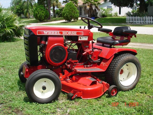

Duff 206 #34 Posted February 12, 2012 Rattle canned all three; two are frame-off rebuilds. Rusto Regal Red and Gloss Black. Duff :thumbs: Share this post Link to post Share on other sites
AMC RULES 37,259 #35 Posted February 12, 2012 Man, those black wheels look tough Duff. :icecream: Share this post Link to post Share on other sites

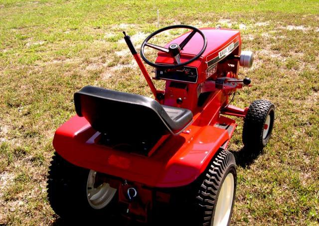

Racinbob 13,040 #43 Posted August 31, 2013 Here's a Commando 800 I sprayed with Rustoleum Red. It amazed me how it turned out. Share this post Link to post Share on other sites

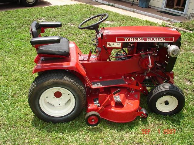

C-160 Auto 10 #44 Posted August 31, 2013 (edited) It doesn't look quite as pretty today...but this is what it looked like when it was rattle canned in 2007. Edited August 31, 2013 by C-160 Auto 1 Share this post Link to post Share on other sites

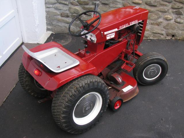

rwilson 128 #47 Posted September 1, 2013 C-125. used tractor supply's Majic IH red 1960 400 Suburban. used Valspar tractor and Implement IH red Share this post Link to post Share on other sites
