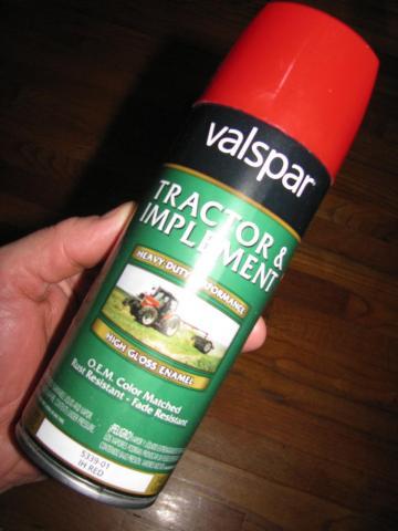

AMC RULES 37,250 #4 Posted February 9, 2012 Don't forget the Valspar...looks really good so far...hope we get an action video once completed. :eusa-think: Share this post Link to post Share on other sites
kpinnc 16,181 #5 Posted February 9, 2012 Yeah, it will get the Valspar treatment for sure Craig. The tractor I built it to fit was painted with it back in 2008. Looks good enough for me. Share this post Link to post Share on other sites
