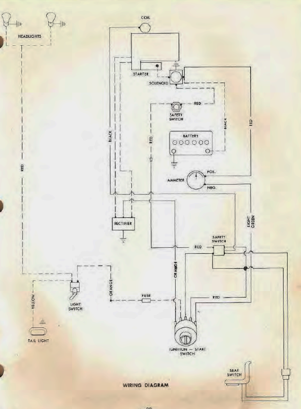

Wheelhorse84 87 #1 Posted February 7, 2012 Any idea where I can find a wiring diagram for this tractor.. Model 1 0481. Thanks Share this post Link to post Share on other sites

Wheelhorse84 87 #7 Posted February 8, 2012 So I'm taking the horse apart to go through it. the electrical harness connector that plugs into the ignition is rotting away so i clip the wires and put plugs on the end of them and reattached. My green wire has juice when i checked it with my test light. I plug all the wires in to spec and no power anywhere but that green wire. Any ideas. Share this post Link to post Share on other sites
Wheelhorse84 87 #8 Posted February 8, 2012 Figured it out..... The switch went bad, I switched in my raider 12 switch and it worked... Share this post Link to post Share on other sites
