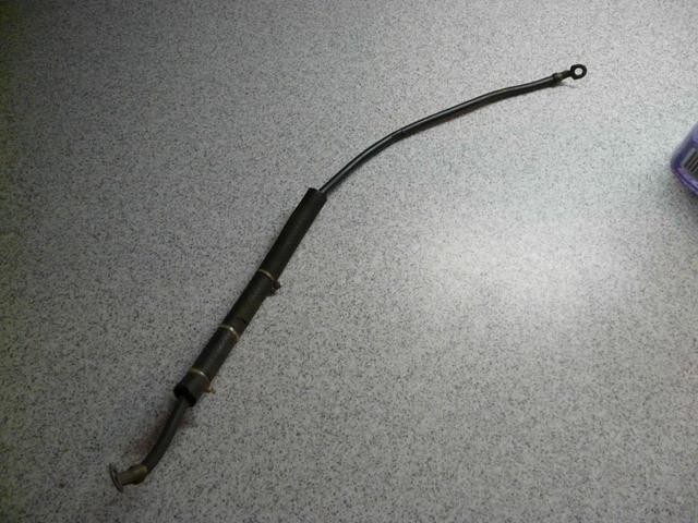

where does this go on my C-175
whalenkm
I have been working on my Kohler KT17S from my C-175 in the basement for a while and have it all put back together EXCEPT....I have this one heavy wire that I don't know where it goes. I have lots of pics but this was removed before I started taking them apparently. Nothing in Kohler or Wheel Horse manuals. I suppose it is a ground but not sure where each end connects. It has a short section with a rubber shield wrapped on it.

I'm guessing it's an engine to frame grounding wire.

Do you have a wire to your starter?

Solenoid to starter! That's it! Overlooked the obvious......Thanks a bunch!
