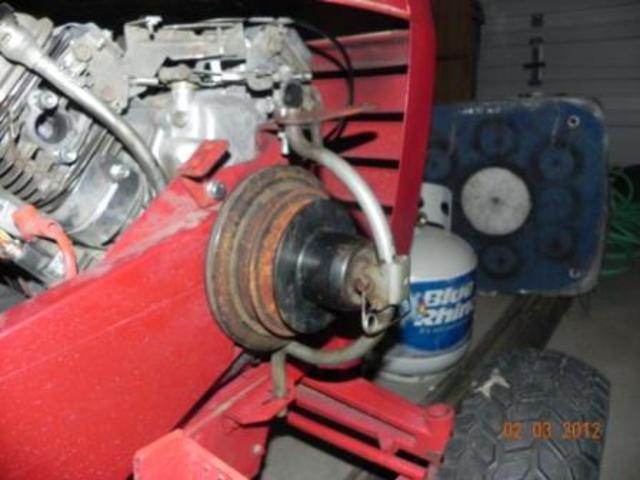

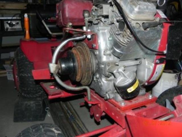

porlife00 0 #3 Posted February 4, 2012 Ok Don thanks for the reply. Here are some pictures of what im working with. I put two 1/16" washers behind the upper bracket but it still needs to come out almost an inch. I dont know if I mounted the motor correctly I put it on before I acquired the pto assembly. I based my placement off of the belt guard and the clearence I had with the motor. I only have about 3/16" of clearence on the side with the fan shroud before it comes into contact with the hood. Another question is how many different size pto housings did wheel horse make as well as the hoops or yokes? I noticed that all the hoops are offset from where the top bracket and lower bracket connect to it and just want to know how much of a difference from top to bottom. The one I have looks like its an inch if not more. Any more help would be grealy appreciated! Share this post Link to post Share on other sites
TT-(Moderator) 1,170 #4 Posted February 4, 2012 :WRS: I can't tell you exactly which bail you need, but I can tell you there were quite a few different versions. A quick search at eBay turned up at least a half dozen - and they aren't all the same. I'm pretty sure I ended up flipping the C-85 bail upside-down when I installed a Vanguard twin on my tractor. I did have my engine mounted on a GT-1142 WorkHorse riser plate though, and they have the lower hole for the bail built right into them. If all else fails, you could modify your existing part, or fabricate a new one. Share this post Link to post Share on other sites
Don1977 606 #5 Posted February 4, 2012 From looking at your pictures, your engine is mounted up closer to the frame. My suggestion is to make a new bottom bracket as it's too close to the engine and holding the top out. Remove the bottom bracket and with the PTO out of ingagement measure where the bottom of the loop should be and make a new bracket . I think this will get you fixed up. If you have any more questions PM me. Share this post Link to post Share on other sites
TT-(Moderator) 1,170 #6 Posted February 4, 2012 Remove the bottom bracket and with the PTO out of ingagement measure where the bottom of the loop should be and make a new bracket . Good idea! You'd think if it was that far off, the main drive belt would be way out of line though. :scratchead: Share this post Link to post Share on other sites
Don1977 606 #7 Posted February 4, 2012 I cheated on mine. I have a 5/16" spacer behind my drive pulley to keep the clutch from pushing it out of alinement. His drive pulley is all the way back I would guess he had that in line when he mounted the engine. Share this post Link to post Share on other sites

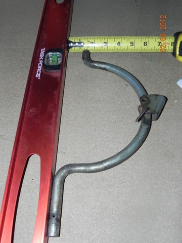

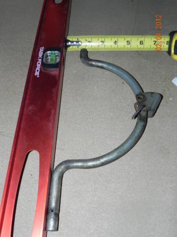

porlife00 0 #13 Posted February 4, 2012 ok guys thanks for the help and advise. I was concidering making a whole new lower bracket but when I put the upper bracket into its correct position and had the hoop on it kicks out so far and binds on the bell housing. The hoop is what looks mesed up to me. I dont know if it is over sprung or if they made them like that for the particular model I got the pto from but there is an 1 1/8" difference from the top to the bottom. I will attach a picture so you guys can see what i am talking about. I put a square under the frame and aligned the lower bracket with the upper bracket while it was in the intended position and the upper mounting hole for the hoop isnt that far off from the bottom. maybe a 1/4" or so. I cant find a good picture on the net of one but every hoop I see doesnt look like there is a huge difference from top to bottom. If anyone has a idea or a hoop for sale that is closer please let me know. Share this post Link to post Share on other sites
Don1977 606 #14 Posted February 5, 2012 That's just the wrong one. I checked mine it lines up on both ends. You need one off a C-Series with a !0,12, or 16 HP K-Series Kohler. You still may need to shim out both top and bottom brackets to get it to work right, Share this post Link to post Share on other sites
can whlvr 994 #15 Posted February 5, 2012 could you cut off the top of the hoop and add an inch or so and weld the piece back on? Share this post Link to post Share on other sites

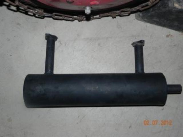

porlife00 0 #16 Posted February 8, 2012 Ok got it finally working well to the best of my knowledge. I ended up cutting and adding to the top of the pto hoop to make the top and bottom align and be able to ingage. The hoop was made out of 9/16" material so finding a donor piece of bar stock was fun. I eventially found a 9/16" lag bolt to use and it worke out perfect. Question is how much presssure or how hard does the pto bell need to compress to the clutch plate for it to work properly? I have to do some modifacations to my exhaust sense I made it before I got the pto assembly and naturally it doesnt fit. Also when the pto disengages while running does the momentum push the bell housing far enough away? or when I disengage it while not running should there be a certain gap between the plate and housing? And what distance should I put the bell housing brake? Lots of questions first horse and learning as im going. Thanks for the help Share this post Link to post Share on other sites
