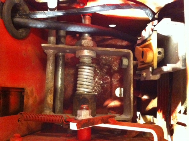

I've started the restoration on my '78 C-121 Auto. Dissassembly is well underway. Pretty much everything under the hood is off but I seem to have paused at the speed control linkage area. Any trick to taking all this apart? I'm taking plenty of pictures but I'm not sure in what order things need to come apart. Thanks for any help you can provide.

theres a shafr that goes from one side to the other through the spring,it has a small tab on the side and then it slides out,take the ball off first that goes in the cam plate,then the bolt i just mentioned,it can be stuck in there so good luck
