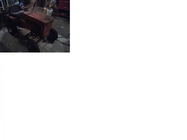

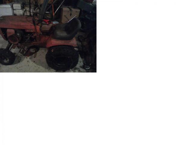

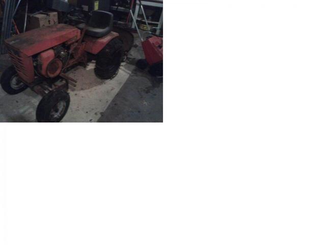

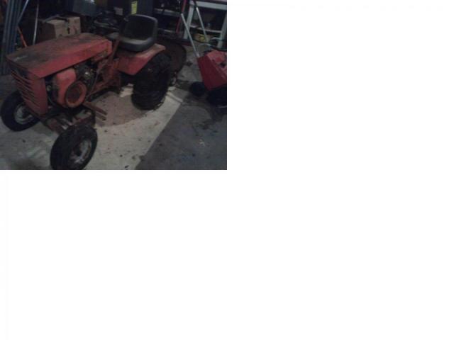

AMC RULES 37,251 #4 Posted January 25, 2012 :WRS: It would be easier for us to help you if you uploaded a couple picts of your project for us here on the forum. :text-worthless: Share this post Link to post Share on other sites
stevasaurus 23,521 #6 Posted January 25, 2012 First...welcome to Red Square. Second, you do not need to repolorize (sp)...but you may want to check and clean all grounds if it has been sitting for 6 years. can't tell you how much those clean grounds mean to these little horses. As was said above...we love pictures...and we love to solve problems also. :) Share this post Link to post Share on other sites
fullerman 0 #7 Posted January 27, 2012 Sorry about not adding any photos but I didn't have any yet. I am just trying to find out whatever I can about this little guy. Rareity, problems, worth, why it was only produced for 1 year....... Just the basics. In my last post I commented about it not charging. I checked it out a little bit and I found that it is not charging at a low idle or at a higher rpm either. I removed the cover on the regulator and saw that one set of points functioned during starting and the other didn't seem to do anything during the run cycle. My voltage stayed steady at around 12.05 the entire time. It is a new battery and it is displaying the same voltage when it is not running. I am not sure exactly what to check next. All of my grounds are clean, as many as I can find anyway. . Not sure what to look at next. Share this post Link to post Share on other sites
