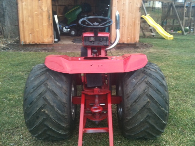

Flatheadpuller 6 #3 Posted January 25, 2012 Being he is 9 you would want him in a stock class. Be sure to hunt around your area for a club and build it to suit.the class. Around here we run 23-10.50-12 tires. I pull my wheelhorse in my avtar in the stock class. Stock 12 hp kohler. Its a fresh rebuild and has a couple good part in but it passes stock rules. 4000rpm with working governor. You will need wheelie bars and a hitch as most clubs require certain hitch requirements and wheelie bars. My son is also nine and he runs a model 100 cub in the same class I pull. We compete against each other. Share this post Link to post Share on other sites

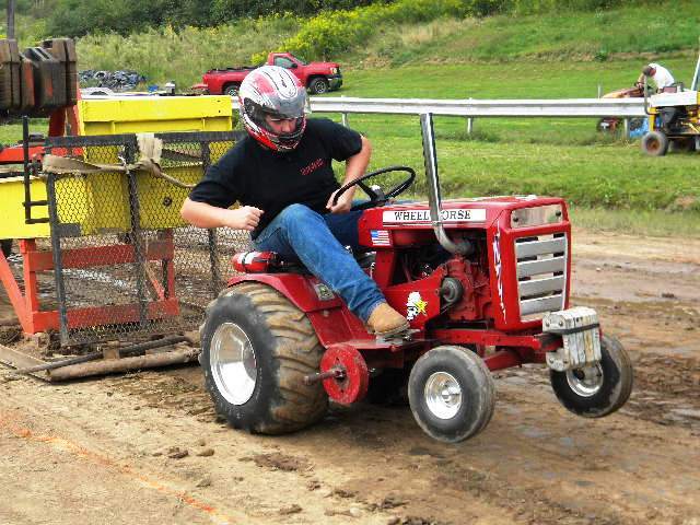

WHEEL HORSE BILL 7 #4 Posted January 25, 2012 That is awesome. My son is sitting here now and is saying he's got the chill's with excitment he can't wait to start on the project. Can you guys show your puller pics he would love to see them done up if you can thanks again. :lol: Share this post Link to post Share on other sites

baerpath 517 #8 Posted January 28, 2012 Couple of our stockers the gray ones is for sale The little one's for a kid has an 8hp in it Share this post Link to post Share on other sites

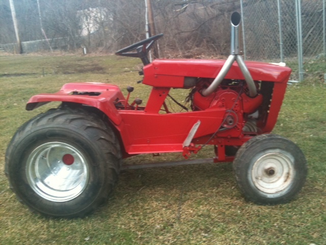

Wheel Horse Kid 105 #9 Posted February 1, 2012 That is great that you want to do that with your son! What a great way to make lasting memories! Several years ago, my grandpa, dad, and I built my first pulling tractor! It was a blast and a whole lot of fun! I have since retired my puller as it does not really work out for us to go to the local tractor pulls anymore. Maybe someday when life is not so hetic and busy, I will bring her out of retirement! Here is a picture of my puller that I took last year: Anyways, good luck with your first puller!!! Share this post Link to post Share on other sites

Cory Zuill 7 #11 Posted February 4, 2012 My 8 horse stocker. Share this post Link to post Share on other sites
