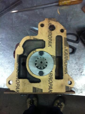

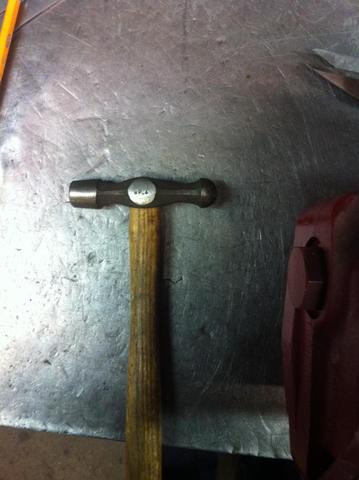

Hodge71 690 #127 Posted March 6, 2012 Small amount of progress today. As some may remember I've been worrying for awhile what to do about the NLA gasket for the hydro motor to transmission. because mine was nonexistant, some genius used blue silicone instead. So today I took the motor over to Dads and showed him what I was up against. 2 minutes later here comes a roll of gasket material, a square and compass( 2 things dear to me being that I'm a Freemason), and a little funny looking hammer. Well let me tell ya I got taken to school by the old guy. After about 10 minutes of measuring, drawing a square, triangles and a circle, heres the finished product. I asked him how he found the hammer and stuff. His answer, I've had this stuff since the 60's. They didnt make gaskets for everything back then and when you drag race a Studebaker, they dont make any gaskets...lol.. His best friend Jake showed him how and now I know how to make any gasket I could ever need with a little patience, time, and the right tools. Heres the magic little hammer. Its actually called a gasket hammer,but I bet nobody makes them anymore Share this post Link to post Share on other sites
WH854 45 #128 Posted March 6, 2012 Small amount of progress today. As some may remember I've been worrying for awhile what to do about the NLA gasket for the hydro motor to transmission. because mine was nonexistant, some genius used blue silicone instead. So today I took the motor over to Dads and showed him what I was up against. 2 minutes later here comes a roll of gasket material, a square and compass( 2 things dear to me being that I'm a Freemason), and a little funny looking hammer. Well let me tell ya I got taken to school by the old guy. After about 10 minutes of measuring, drawing a square, triangles and a circle, heres the finished product. I asked him how he found the hammer and stuff. His answer, I've had this stuff since the 60's. They didnt make gaskets for everything back then and when you drag race a Studebaker, they dont make any gaskets...lol.. His best friend Jake showed him how and now I now how to make any gasket I could ever need with a little patience, time, and the right tools. Heres the magic little hammer. Its actually called a gasket hammer,but I bet nobody makes them anymore WE were taught how to do that in the Navy (1952 To 1960) I was a Machinest Mate. Chas Share this post Link to post Share on other sites
JamesBe1 84 #129 Posted March 6, 2012 Fantastic work. I learned the hard way by trial and error (best teacher I ever had). I've gone through lots of gasket material in my time. Is there anything special about the hammer? It looks very much like a small ball peen hammer. I'm not a hammer expert, but I know that there are more type of hammers than you can shake a stick at. BTW, I got my new (used) block today, so it looks like I can continue with my project. Luckily the weather is starting to turn. Share this post Link to post Share on other sites

Hodge71 690 #132 Posted March 7, 2012 James, The round end of the hammer cuts the gasket. You just tap the gasket and low and behold a circle appears where theres a hole. You tap with the flat side for straight areas and then the round again for radiuses. It was great to see how it works and then for my Dad to leave me do some. Just keep tapping until its all cut out. Yeah I offered him the extra and his answer was I must be insane. he would never consider $500 Share this post Link to post Share on other sites
JamesBe1 84 #133 Posted March 7, 2012 James, The round end of the hammer cuts the gasket. You just tap the gasket and low and behold a circle appears where theres a hole. You tap with the flat side for straight areas and then the round again for radiuses. It was great to see how it works and then for my Dad to leave me do some. Just keep tapping until its all cut out. Yeah I offered him the extra and his answer was I must be insane. he would never consider $500 The hammer technique is pretty cool. I see now how it works. http://youtu.be/HWbNw7moKl8 1 Share this post Link to post Share on other sites
Hodge71 690 #134 Posted March 7, 2012 That it James!!!! I saw it on Youtube myself but it wouldnt allow me to post it on here for some reason.... I think I will contact a mod to pin this video. It could help some others on here 1 Share this post Link to post Share on other sites

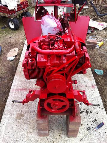

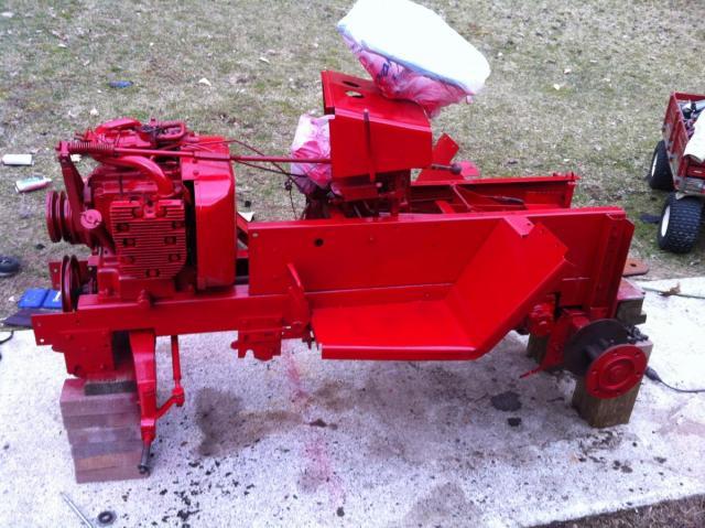

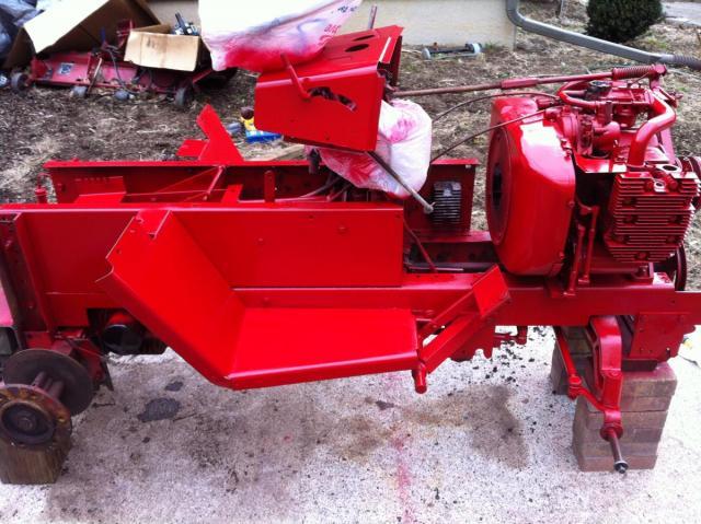

Hodge71 690 #137 Posted March 9, 2012 Todays progress, Got 3 coats of paint on her before the clouds came and I didnt want it to get water droplets in wet paint. Probably gonna do 3 more next week when its back to 65 here. Also got my hydro pump from Kelly to day so hopefully tomorow will begin the teardown and polishing of the slippers and swashplate and then reassembly. Share this post Link to post Share on other sites
JamesBe1 84 #138 Posted March 9, 2012 Tremendous! Too bad you couldn't get the steering wheel off, but you seem to have found a satisfactory work-around. How many cans of paint did it take? I didn't notice before, but I see you have turning brakes. That's a nice option to have. Can't wait to see the finished tractor. Share this post Link to post Share on other sites
Hodge71 690 #139 Posted March 9, 2012 James, believe it or not, its 3 cans of valspar tractor and implement that got me that far. As far as the turning brakes...thats kind of a sore subject. I was told that the tractor had turning brakes, when I picked it up I was given a box full of junk that was supposed to be all the parts necessary to make turning brakes and a 3 point hitch. Well I got home and got a printout of the turning brakes instruction sheet only to find I had a pedal and a rod. I need calipers, pads, rods, springs, and assorted miscellaneous clips and parts to get them to work. So I have rotors for turning brakes, hopefully someday I will have actuall working turning brakes on it. Share this post Link to post Share on other sites
