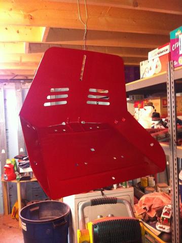

JamesBe1 84 #76 Posted February 7, 2012 I see what you mean about the fenders looking like swiss cheese from all the holes drilled in it. At least you won't have any trouble find matching holes to attach your new lights to. Just curious, where do you do your painting this time of year? Share this post Link to post Share on other sites

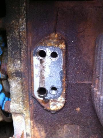

Hodge71 690 #84 Posted February 8, 2012 Thanks Jake, it did come out pretty good. James, I'm researching a remote filter right now.I checked with my Toro guy and he told me the original engine mounted systemis NLA. But he did tell me they put the K482 in JD tractors. He can get one for $386 from the green and yellow parts side. To me thats way too much so I'm checking on something similar to what Duke did with his 520. I'll let ya'll know what I come up with. Not sure where I could mount it though. Share this post Link to post Share on other sites

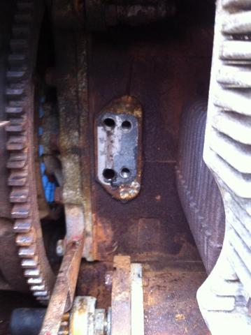

Hodge71 690 #88 Posted February 8, 2012 This is what I found under my filter mount block off plate. James, The JD isnt a remote kit, it supposedly mounts to this area somehow. THe 2 holes on the right side hold the blocking plate on. The 2 on the left are the holes I need to plumb my lines to. They appear to be 1/4 NPT. This is as far as I got because the snow came. According to Kohler the top hole is supply (dirty oil) to the filter, the bottom is return (filtered oil) to the engine. I have sourced the remote filter housing, its about 25 bucks for one that has the mounting foot on it. I will research the fittings and lines to make it all work. I have found a possible location but it might depend on the filter size. According to the instructions it fits a Fram PH-8a. This is a pretty big filter, should hold damn near a quart of oil. Its the same as I have on the 1965 Plymouth Satellite with a 426. I gotta see if it will also fit the PH-16 which if I remember correctly is the small block filter for MoPar. I'm 99% sure its the same base and thread, just a shorter filter housing. Share this post Link to post Share on other sites
JamesBe1 84 #89 Posted February 8, 2012 I see the same setup on mine, although I haven't taken the blocking plate off. If you use the JD setup, at least you won't have to cut a hole in the tin and fabricate a cover like Duke did. That is, unless you can't find another way to route the hoses. I don't see any reason the hoses can't be as long as you want the to be. Curious how the outlet holes are only 1/4". You'd think you would want something larger to flow more oil. There are also ports on the front of the engine on the other side that Paul used one of to plumb his pressure gage. Check out page 2.3 of the engine manual. That where they plump the remote filter on a K662. Spent the last 3 hours on hold with unemployment trying to get a couple of buck out of them. Sigh. What a scam that whole system is. It's about to snow here, so it doesn't look like I'll be getting much done my my carb today. Finally got my connectors from Newark electronics in the mail today. I might start in a replacing the plug on my C-120, and maybe rewiring my fuel pump on my D-180 to run off the ignition wire. Let me know if you need any. Share this post Link to post Share on other sites

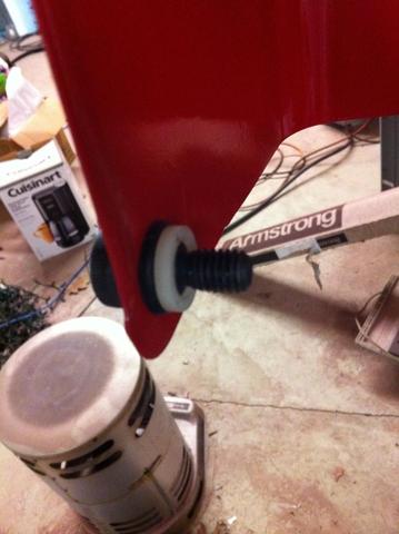

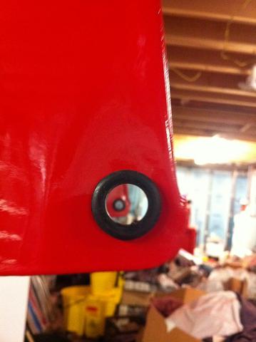

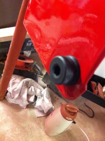

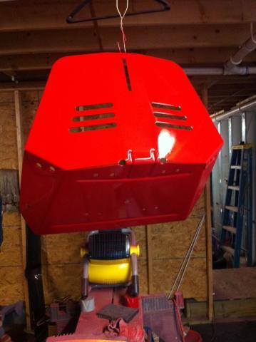

Hodge71 690 #90 Posted February 8, 2012 Heres the fix I came up with for my hood hinge and the lack of factory bushings. Got it together for some pics tonight to share. 1/2 x 3/8-16 NC stripper bolts, 1/2 nylatron washers, .54X31/32 rubber grommets..... Done deal.....vibration dampening, wont scuff the paint and should make the rattle that I had coming from up there go away. 1 Share this post Link to post Share on other sites
Hydro 131 #91 Posted February 9, 2012 Golden :thumbs: Share this post Link to post Share on other sites
JamesBe1 84 #92 Posted February 9, 2012 I certainly admire your out of the box thinking Jeff. Real nice work. Share this post Link to post Share on other sites

Jake Kuhn 1,581 #94 Posted February 9, 2012 Thats a nice fix for the hood :handgestures-thumbup: Share this post Link to post Share on other sites
JamesBe1 84 #95 Posted February 9, 2012 Looking good. Glad you got your paint issues worked out. It shouldn't have anything to do with the rusto red primer. I used the same primer with the Valspar IH red in the tractor & implement and the Restoration series, with very good results. I also painted it over the rustolium rust reformer, in spray cans, with good results. Keep up the good work. I am also using valspar over rustoleum rust reformer. Aside from some minor orangepealing in the beginning on a minor piece, it has worked out quite well. Share this post Link to post Share on other sites
1maidenfan 202 #96 Posted February 9, 2012 Heres the fix I came up with for my hood hinge and the lack of factory bushings. Got it together for some pics tonight to share. 1/2 x 3/8-16 NC stripper bolts, 1/2 nylatron washers, .54X31/32 rubber grommets..... Done deal.....vibration dampening, wont scuff the paint and should make the rattle that I had coming from up there go away. Now thats a great idea! Really like that setup. Thanks for the detailed photo. Share this post Link to post Share on other sites

varosd 1,185 #99 Posted February 11, 2012 your use of the rubber grommet on the hood latch is a smart idea Jeff. I have done the same thing using a thin plastic washer on the Snowthrower discharge hood (and added stainless steel hardware)....only have used in once this winter!!! Share this post Link to post Share on other sites
