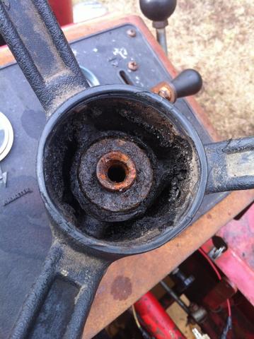

Hodge71 691 #33 Posted January 31, 2012 I went to take the dash off today because it was a balmy 60 degrees here in PA. This was the surprise that was waiting for me when I took off the steering wheel cover. Just one more reason I believe that certain people should not be allowed to have tools or kids....freakin butchers... I had to walk away.... The pic doesnt show it very well but some genius apparently tried to heat it, not realizing rubber burns faster than steel heats up and then mushroomed the top over and bent it to boot from beating on it with a hammer. Any ideas on how I might be able to get this wheel off? Share this post Link to post Share on other sites

ol550 879 #37 Posted January 31, 2012 Any ideas on how I might be able to get this wheel off? I am not there and it is hard to see how much if any of the threaded part of the shaft is left. What I might try is to grind off the rest of the shaft flush with the wheel hub. Then see if you can get bolt or something to fit in the shaft hole to tap against while pulling up on the wheel. I don't know what tools you have but you could drill and tap the hub also and that could give you more pressure to pull without tapping on the shaft. Then when you get it out I would drill a hole in the shaft lower than the sreering wheel fits and find a bolt or stud to insert in the hole amd weld in place. Then use a large washer and nut to hold the wheel on. Or you can watch $pay till a wheel and steering gear show up. Wish I had it here cause I look for this kind of challenge. Mike Share this post Link to post Share on other sites
stevebo-(Moderator) 8,742 #38 Posted February 1, 2012 As stated, I would grind it flat first. Once done, soak it with a 50/50 mix of tranny fluid and acetone. Repeat for a week or more and then try to pull it. If it were me I would not tackle that job. I had a dash that was cut in 1/2 (the plastic dash) which is an idea too. How about leaving the wheel on and pulling the shaft? I forgot how that lays out. Share this post Link to post Share on other sites
Hodge71 691 #39 Posted February 1, 2012 I'm not going to get started today due to rain. But its going to allow me to blast the fenders and remaining tins from the 18 auto so that I can get paint on them. Stevbo,I have never heard of 50/50 tranny fluid and acetone. Is that a better form of penetrating oil that will work better? I have been soaking with Kroil since I found it yesterday and was going to continue that regimen until the weather lifts. I went out last night tothe depot and bought a Milwaukee tools cordless die grinder. Thats what I'm going to use to cut the mushroom off and then grind the remaining shaft flat. From the older posts I've seen Steve the whole steering shaft/box comes out. Its not like the C's that you can cut and then rejoin again. I'm not worried about the plastic dash, th 18 autos are a horseshoe type. I wanted to take the metal dash off to blast and paint. and then resticker before I install it back on. Hopefully pics later... Share this post Link to post Share on other sites
