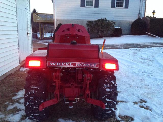

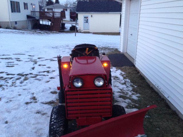

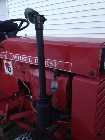

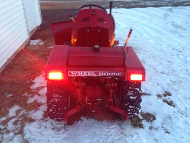

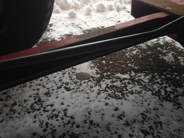

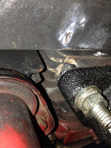

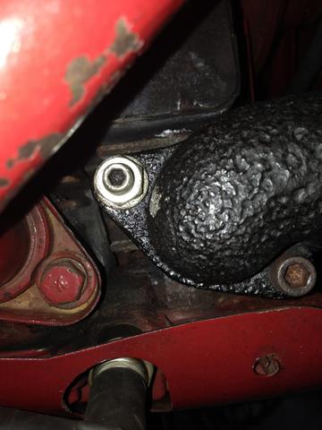

Hodge71 691 #303 Posted January 31, 2014 (edited) Resurrecting oldie but I made some more progress with my dad on truly finishing this tractor. I never put the headlights in or wired them and the fender lights. It needs major work getting the plow squared away but we are about halfway on that and it has a fully functioning sealed exhaust manifold again. My Dad welded the cast-iron and we installed a stud instead of a bolt. I used an allen wrench to hold the stud from twisting and tightened the manifold. Its got the pipe to raise it above the hood level in an effort to stoop the black spots and get the exhaust out of my face..heres some pics to show things as they sit tonight…. exhaust and stack with flapper rear LED tail lights front Amber LED on the fenders instead of reflectors…stink in headlights burned out after about 3 minutes... close up of the stud we welded to the cast iron block. Very strong bond and no exhaust leaks Edited January 31, 2014 by hodge71 1 Share this post Link to post Share on other sites

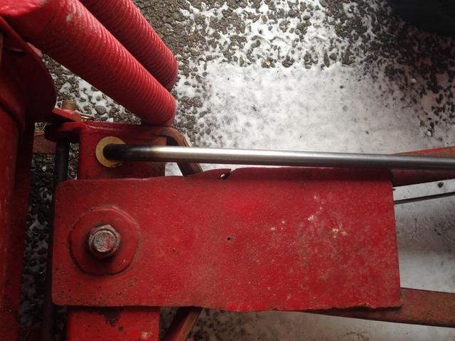

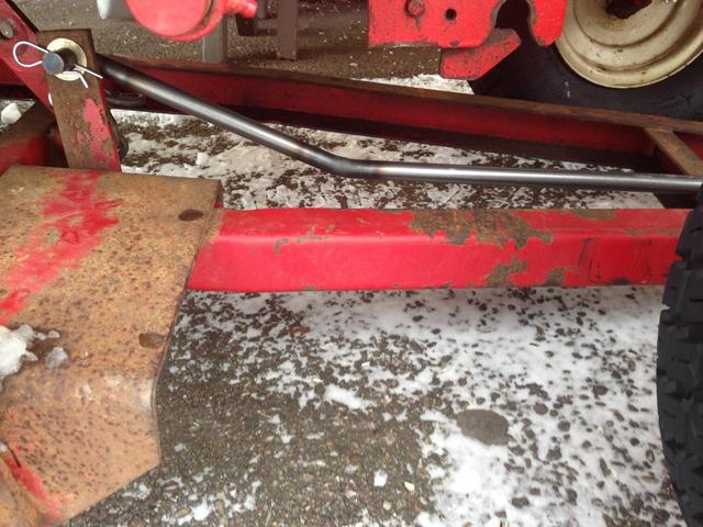

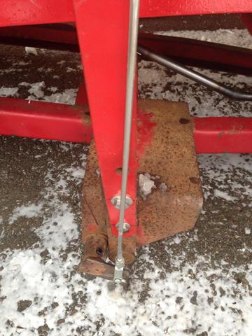

Hodge71 691 #304 Posted February 5, 2014 Hers the finished product with the linkage…. I love how it works!! Share this post Link to post Share on other sites
ol550 844 #305 Posted February 5, 2014 Looks like a ringer on the linkage. Share this post Link to post Share on other sites

Hodge71 691 #307 Posted February 5, 2014 I hate to admit this Andy…I have no idea what was causing the hunting issues. I had gotten so disgusted with this thing I just packed in the corner of the yard at my old house and honestly didn't run it at all last year. It was missing and just generally running like crap and no matter what I did, it wouldn't run the 60 inch deck and drive at the same time. Well the hunting/cruddy running has mysteriously gone away. I have no proof but I wonder if it had anything to do with the massive exhaust leak I had on that right side exhaust manifold where I broke the ear off. It was sucking all that exhaust in the carb and ran like poo…especially at idle...Once my Dad welded a stud in place of the ear and we installed new graphite gaskets, its sealed like a champ…not even the slightest leak. So I never tore into the carb again, didn't replace the throttle bushing like I was blaming everything on, nor did I pull the heads to check the bore or valves. I may pay the price once the warm weather comes and I try to run the 60 again but time will tell. Honestly, once I heard it start and run without issues and black sooty or blue smoke pouring out of the exhaust I realized how much I missed it. Now I just need to get it out the farm here…I kinda feel bad taking it from my Dad though…He wouldn't drive it but he liked it…lol…Next thing to be done is adjustment of the neutral position and friction on the motion control. When I step on the brake pedal to stop, it blows right by neutral and starts to go in reverse a bit. Plus it creeps a very slight bit in reverse with the parking brake on. Looks like a ringer on the linkage. Couldn't have done it without you Ol'….The measurements were perfect!!! Share this post Link to post Share on other sites
