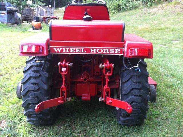

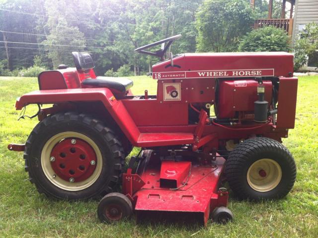

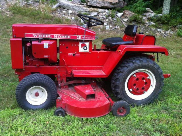

Hodge71 691 #285 Posted July 11, 2012 Here it is 99.75% complete. I'm just waiting for my new L.E.D. headlights to come in. As many can see its got a 60" in deck under her. I was able to adapt a 60" deck from a 520 to fit where the factory stuck a 48. I wish the factory would have thought of this back in '73. I must say its quite the lawn mowing beast. I think it scares the grass when its coming. I can see the blades tremble in fear. The down side is I believe I have a pretty serious carb/governor issues. I have adjusted both the low speed and high speed mixture screws. It starts and idles well, but it really doesnt like running with the throttle wide open. It also sounds like its not reaching max rpm at W.O.T. Once the deck is engaged, it really lugs down. It seems like the governor is working ( I can see it moving the throttle rod) but it just doesnt seem as if its opening the throttle enough under load to compensate. How do I find what RPM the engine is running at W.O.T.? Is there an adjustment for the governor that I can make to make sure it adjusts higher under load? I'm kinda bummed that I'm having an issue after all this work but I will get through this also. Its been a long road but the end has got to be near. :confusion-helpsos: 1 Share this post Link to post Share on other sites
JamesBe1 84 #286 Posted July 11, 2012 Nice tractor. It looks like the deck is a really tight fit. I know from the Kohler manual that the max RPM's are 3600, and that there is a procedure for adjusting the governor sensitivity. GIve it a shot and see what happens. It's kinda odd that the deck would load down the engine so much. Regarding the new headlights - did you find something that fits inside of the rubber bezels or are you going to attach them by some other manner? James Share this post Link to post Share on other sites

Hodge71 691 #292 Posted July 12, 2012 James, the headlights are a direct fit in the rubber bezels. 10Xs the light output of the originals but only draw .25 amps each instead of 5 amps each like the OEM. The picture is an optical illusion, there actually is quite a bit of space. I could probably have gone with a 101 inch deck belt to move it back a bit more but I can turn the wheels quite tight, not quite full tilt but damn close. Coldone, Thats one helluva deal on that tach. I will be getting 1 immediately. I had a guy PM me about a vibration type tach that basically just sits on the engine and somehow knows what the RPMS are. I have never seen or heard of that type before but I think I'm gonna give yours a shot Ol550, I dont think its constipation as the problem just reared its head. It ran great last week, this problem just showed up. The 18 fires like a Harley, one cylinder at a time. SO basically I have two 9 hp Kohlers. Andy, I guess we shall learn together. I have done the same thing and actually fooling around made it worse for me too.so I guess time will tell for both of us. It will be funny if we both have the same problem across the pond from each other. Charles , I have ordered new high lift blades but cut with the ones you had on it. It cuts ok, there was only a few spots where it was really high that it missed from him grinding the ends of the blades. To everyone else thanks for the compliments Share this post Link to post Share on other sites
Ken B 3,203 #293 Posted July 12, 2012 Nice job Jeff! They really looks nice and I love the rear tires. If that D started any faster you might have to worry about it starting on its own! Share this post Link to post Share on other sites
Jake Kuhn 1,600 #294 Posted July 12, 2012 Wow! That really looks great! Love those rear tires and taillights! Jake Share this post Link to post Share on other sites
