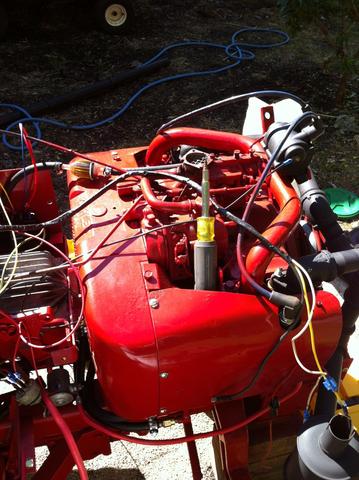

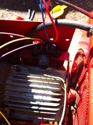

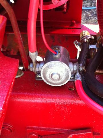

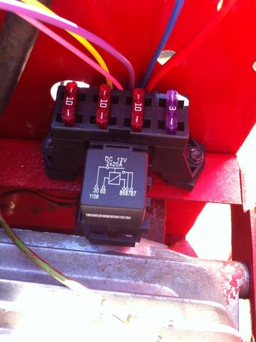

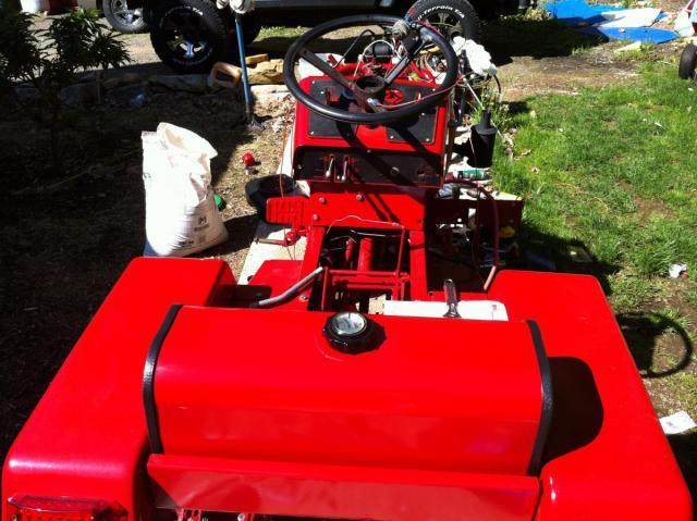

Hodge71 690 #253 Posted May 12, 2012 Well I made a ton more progress in the last 2 days. I ripped the old wiring harness( if you want to call it that) Installed the new fuse block and harness assembly and routed the harness and wired up the ignition, light switch, and solenoid. I got the gas tank installed and put fuel in it to make sureit was leak free before filling it more. As I was working, I keep hearing voices and noises. I'm checkin the wooods around the house as its rather desolate where I'm at. Eventually I turned around quickly and found the source Apparently someones jealous that I'm not trying to get the Techy running on the 551. Heres a link to the youtube vid of the fireup and short run. Hopefully more progress and run time tomorrow 1 Share this post Link to post Share on other sites
JamesBe1 84 #254 Posted May 12, 2012 Holy Carp that's nice! It looks stellar. I am glad to see that you are almost done. The muffler sounds real nice. Just a thought about the fuse box - it might be better to mount it on it's side in case water or other material gets in there. Do you have an oil pressure gage for it? I find it is an excellent monitoring tool. I am glad I installed on on mine. James Share this post Link to post Share on other sites

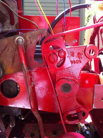

Hodge71 690 #257 Posted May 23, 2012 Ok Guys, I'm reaching out for help. I'm just about ready to pull my hair out. I have the linkage hooked up to the hydro pump for the direction control. The issue I have now is that it only moves forward and when in neutral it still moved forward just slowly. If I adjust the linkage in the trunnion to get it to stop when in neutral and also have reverse, when I go to move the linkage to forward it goes forward just at about half speed. How do I keep reverse and neutral and also keep forward moving at full speed? I cant find a sweet spot on this linkage no matter how I adjust it. I am at a loss here on this one. :confusion-helpsos: Share this post Link to post Share on other sites
JamesBe1 84 #258 Posted May 23, 2012 Wow. You got me stumped on that one Jeff. I must have just gotten lucky when I put mine back together. Everything still works the way it was supposed to, albeit with some adjustments. Is there any chance that it went back together wrong? Did you take pics before you took it off? If it weren't for that, I would still be puzzling over how to get mine back together. If you need pics, let me know, I can take the side plate off of mine and snap away. Share this post Link to post Share on other sites
Hodge71 690 #259 Posted May 23, 2012 The 18 controls only fit 1 way and mine is right except for the parking brake which has me stumped. But on the pic end of things...no I didnt take any pics and unfortunately the 18 auto is a 1 off and nobdy here can provide me with the pics that I need. I have asked numerous times to no avail.... SO I guess I'm screwed to the ground on this until I can figure it out on my own Share this post Link to post Share on other sites
JamesBe1 84 #260 Posted May 23, 2012 Well, this site isn't the only game in town (although it is one of the best). How about mytractorforum. There are several yahoo groups that I have gotten help from too. You might try getting some pics of other D-Series linkages. One of them might have an important clue or two. I really wish I could be of more help. Share this post Link to post Share on other sites
coldone 35 #261 Posted May 23, 2012 Silly question, do you have the Hydro manual? Diagram and adjustments are covered. Share this post Link to post Share on other sites
wheeledhorseman 579 #262 Posted May 23, 2012 Jeff - I know my D has a very different control assembly but I've looked at the Toro diagram for yours and the adjustment part works on a similar principal as far as I can see. Adjustment of the correct neutral position is made using the excentric assembly with the sort of semi circular slot. It's not actually semi-circular but excentric (like me) The problem with setting up from scratch is that there are two variables - the trunion adjustment and the excentric adjustment. Coldone's point is good in that there must be a set of instructions for doing this. I spent hours playing with the adjustments on mine to establish that it wasn't the control system that's responsible for no reverse. In adjusting it I found it helpful to mark the pump shaft to indicate full forward/reverse and neutral postion as a reference point. What I also discovered that may be helpful is that by design full reverse on the control lever uses very little of the possible rotation of the pump shaft i.e. reverse speed is limited to a crawl. Full speed forward uses most of the possible pump control shaft rotatio but I wasn't convinced that it uses all of it and put this down to the fact that the tranny has large wheels attached to it. Up until recently I didn't play with the trunion adjustment at all but when I stripped the panels off to photograph the system I did have a little play and wished I hadn't afterwards as although neutral now sits where it should on the gate slot that the motion control lever shaft passes though, I have now lost some of the forward speed. Tends to indicate how critical the cam and trunion adjustments are. When I get a moment I've got to set it back as t was even though the neutral position on the 'gate' wasnt quite in the right place. Hope there may be something here in these ramblings that helps. Andy Share this post Link to post Share on other sites

Hodge71 690 #264 Posted May 23, 2012 I had a brainstorm about 2 this morning (which I'm not sure its a good thing that I dream about Wheel Horses) but I'm going to try it hopefully today. What I was thinking is as follows.....I know that with no linkage connected and by manipulating the direction control on the pump I do have forward and reverse. I tested this before I got to ths point of connecting the levers. SO I think that if I find neutral on the pump lever, then adjust the trunnion with the motion control in neutral until the linkage lines up with the pump lever I should be close. AT that point I might need to adjust neutral further with the eccentric. I guess we shall see....the biggest thing that concerned me was up to this point when the motion control was in nuetral, the tractor still krept forward......now to find the time to fit all this in......I have too many oars in the water and I dont think a couple are rowing in the same direction..... Share this post Link to post Share on other sites

Trouty56 567 #268 Posted May 28, 2012 Hey Jeff....maybe you can try to work off the neutral setting. Try strapping the brake pedal down and then setting neutral using the eccentric (raise the rear end and adjust the eccentric so the wheels stop turning). Everything else has to be adjusted from that baseline. Adjust the trunion so the handle is where it should be in the slot on the side of the console. No matter what the brake should always return the pump to neutral. Crazy setup on there as compared to the 180 I have.....but way less parts...... :) Share this post Link to post Share on other sites

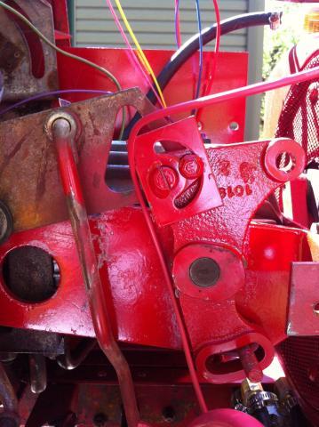

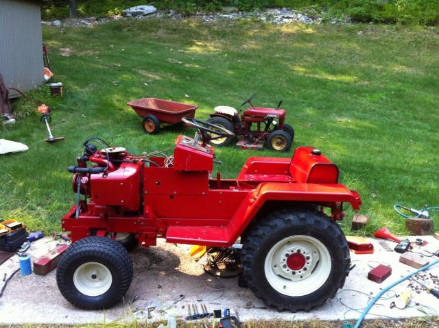

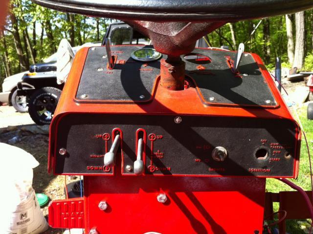

Hodge71 690 #269 Posted June 28, 2012 Well guys pretty much a month to the day since the last post I got the linkage installed properly. Its adjusted for neutral and its it returns there every time I step on the brakes. As you can see from the pic its back on all 3 of her hoofs for the first time in 8 months. And what a sight it was for me to get it this far tonight. Tomorrow I hope to have the gauges finished, the battery where it belongs,the seat back on and be driving around the house. I do have problem though. I marked the wires for the rectifier wires and somehow theyre clean now. I know where the green goes but does anyone have any idea where the other 2 wires go? I dont want to create an issue by reversing something. Let me know guys Share this post Link to post Share on other sites
Trouty56 567 #270 Posted June 28, 2012 Two wires come from the engine to the terminals that are side by side. The lone terminal goes to the R post of the switch..... __ __ - from the engine in no particular order (AC current) __ - to the R post of the switch (DC current) Share this post Link to post Share on other sites
