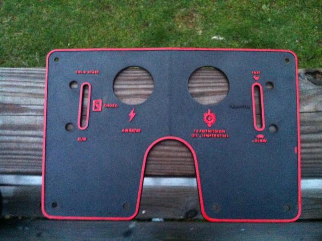

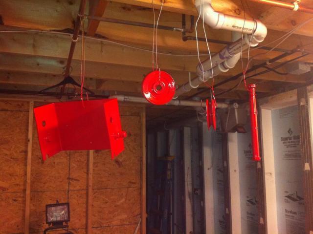

wheeledhorseman 579 #229 Posted April 12, 2012 The red looks cool Jeff . I'm not keen on the original WH white on black and will probably be shot for saying this but to me the white on black looks kind of cheap. I did my C-120 dash silver on black and will do the same on the D-200. After all, there's got to be some scope for 'pimping your ride' in these projects. Got to figure out a repair for my dash before I can paint it - its the type with many dials and has a crack down the middle where the palstic has shrunk in the sun over the years. Seen the same thing on photos of other guy's Ds. There I go using Americanisms like 'pimping' again but such is the power of the internet and with so much US stuff on tv here we've tended to adopt certain phrases and terms where there are gaps in our version of the language. James asked: Andy, I'm rather curious, what do they call redneck engineering in you neck of the woods? Racked my brains on this one. I can't put down the sorts of words I actually use when I unearth some of these things on projects but the respectable traditional term for them is a 'bodge', the person who does it is a 'bodger' and the result is a 'bodged job'. In reality 'redneck job' or similar is becoming used as a result of the humour that circulates across the pond via email. I'm not convinced that there are many 'Walmart People' over here though but we'd know one if we saw one, again down to global nature of the internet. Andy. 1 Share this post Link to post Share on other sites

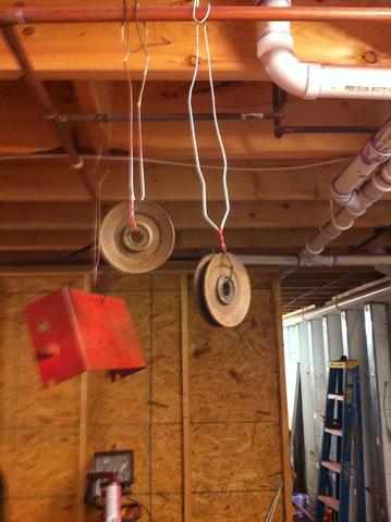

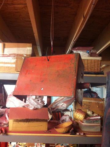

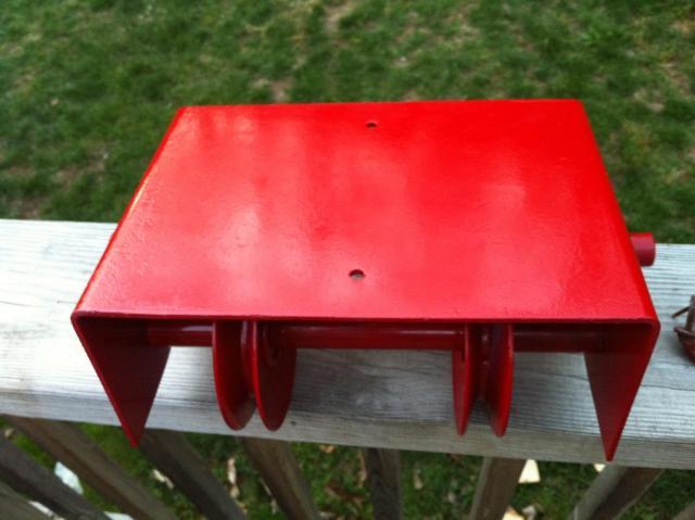

Hodge71 690 #230 Posted April 15, 2012 Reassembly has been slow. But got a present today. A new to me D mule drive, this and a NOS hub cost me a whopping $47. That old dealer my Dad knows left me poke around awhile and I found some stuff. Hopefully I get longer next time. Heres the pics of the mule drive before and after... Share this post Link to post Share on other sites
wheeledhorseman 579 #231 Posted April 16, 2012 Nice score Jeff , and I'd say a steal at that price! No chance of finding one of those for my D over here so I'm contemplating having to put one together myself. If you do get the chance to have a poke around again have a look for me - a couple of NOS pulleys for the mule would be a start. Andy Share this post Link to post Share on other sites
Hodge71 690 #232 Posted April 16, 2012 Andy, While I have this apart I could measure my pulleys and such that way you have an idea what bearings, pulleys, shaft size etc you will need to fab your own up. Share this post Link to post Share on other sites
wheeledhorseman 579 #233 Posted April 16, 2012 Thanks for the offer Jeff. Tim (Tap53) sent me all the measurements a time ago when I first mentioned I'd have to fab one. I haven't checked the availability of similar sized pulleys over here but they'll likely be metric. I'll go that route if I have to but for the moment my aim is to get hold of original pulleys if I can. Andy Share this post Link to post Share on other sites

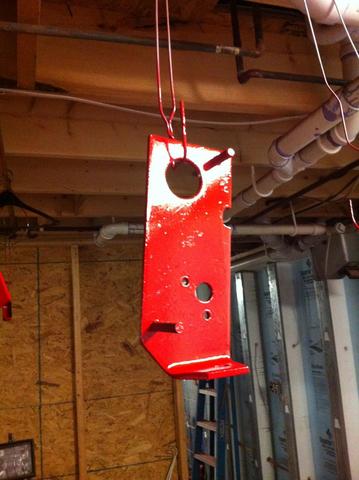

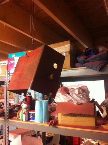

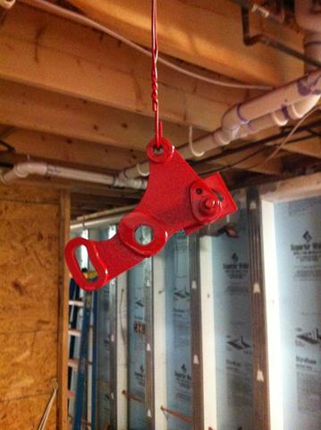

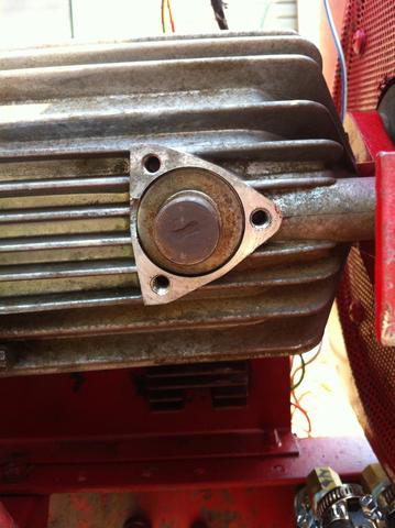

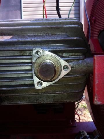

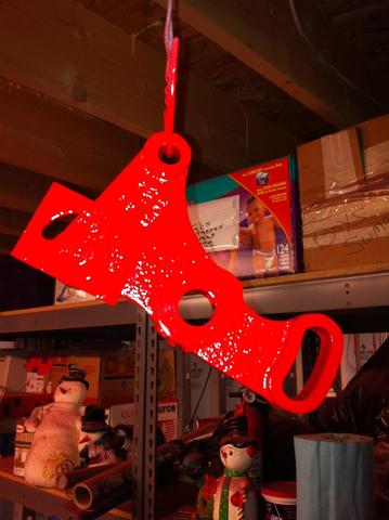

Hodge71 690 #234 Posted April 16, 2012 Heres pics of what gone done today...I got my hydro pump installed today but had the wind taken outta the sails when I figured out Northeast Hydro lost all the parts that attach to the hydro pump for the motinn controls...ugh... Heres a closeup of the area that the bracket bolts to on the pump. From what I remember is kind of an oblong triangle shape with a lever to the pumps direction control and bolts to the 3 holes shown I got the throttle control, motion control, PTO lever and solenoid painted. I used Rustoleum Hammered Finish in silver for a little bling and to set it apart a bit. The mule drive is painted and reassembled too. I also got the remote oil filter mounted in a good are with no interference and got the hoses plumbed up Share this post Link to post Share on other sites

coldone 35 #236 Posted April 17, 2012 I haven't checked the availability of similar sized pulleys over here but they'll likely be metric. I'll go that route if I have to but for the moment my aim is to get hold of original pulleys if I can. Andy Do they have to be NOS? I got generic replacement pullies for mine at AGRISUPPLY. Share this post Link to post Share on other sites

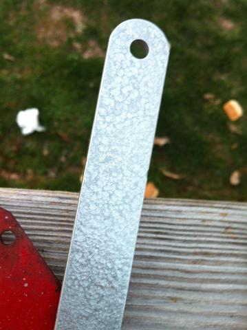

wheeledhorseman 579 #237 Posted April 18, 2012 Love the silver finish on those parts Jeff, I'm going to try it on some of the bits on mine that are past their best but I hope we're not entering a pimp your horse competition - could have disasterous consequences. Thanks for the fleabay tip Lonny, I suspect shipping for heavy items will be prohibitive. Fabbing one will be a nice challenge. Like your thinking 'coldone' I'll check the equivalent sort of suppliers over here as you're right they don't need to be NOS. Andy Share this post Link to post Share on other sites
coldone 35 #238 Posted April 18, 2012 Here is the one i bought. If you end up needing them from over here let me know. We will get it figured out. http://www.agrisupply.com/Idler-Pulley-Toro-Wheel-Horse-Belt-Style/p/57119/&sid=&eid=/ Share this post Link to post Share on other sites
CRE1992 135 #239 Posted April 18, 2012 I like the hammer finished silver! Ill have to remember that next time I paint something. Share this post Link to post Share on other sites

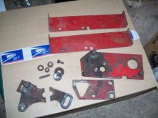

JamesBe1 84 #240 Posted April 18, 2012 Hey, there is a NOS turning brake kit on ebay: http://www.ebay.com/itm/ws/eBayISAPI.dll?ViewItem&item=350558410040&ssPageName=ADME:B:SS:US:1123 I doubt that we are ever going to see a NOS one there again. I wish I could afford it, I would buy it just to use as a template to fab parts against. Share this post Link to post Share on other sites
wheeledhorseman 579 #241 Posted April 18, 2012 Re Mule Drive - Lonny's found me one that 'aint pretty' or in perfect condition so hopefully it will be making a trip across the pond. Re the NOS kit - a man can drool! Just in case the auction link gets removed here's the pic in high res. It a great reference - exactly the same as my kit even down to the two sets of spacers that sit between the caliper mount and the tractor frame - so maybe the springs on mine are supposed to go to the spacers rather than a bracket on the caliper. Andy Share this post Link to post Share on other sites
JamesBe1 84 #242 Posted April 18, 2012 Lol. I am glad I am not the only one to keep a copy of the picture for reference. I guess great minds think alike. Too bad it wasn't taken against a ruled background. Share this post Link to post Share on other sites

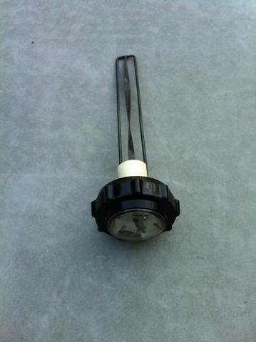

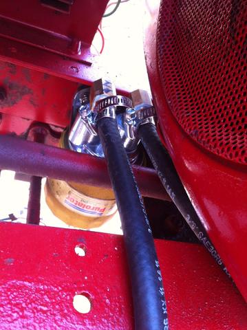

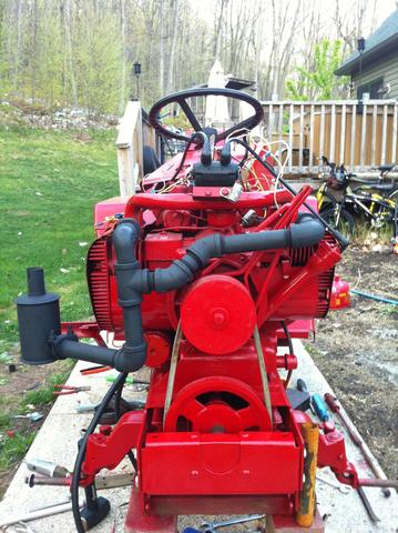

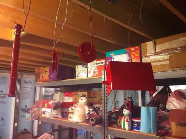

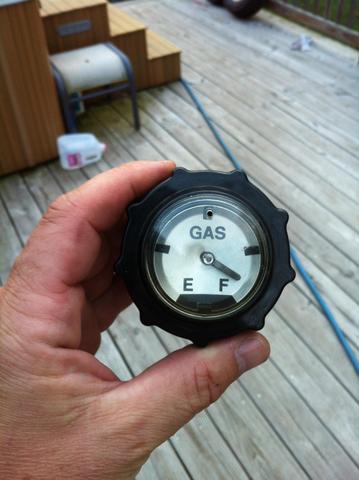

Hodge71 690 #245 Posted April 26, 2012 More progress today, even if it was a small amount. Got my new exhaust gasket material and made new gaskets. I also got the exhaust painted and mounted up. I got a present from the guy at Ringtown. He gave my Dad a call and gave him a gas cap for me. I had spoke to him last week when he left me pick through a few random piles of stuff and he said he wasnt sure he had one. Well I expected it to be the chrome kind that was on it. Lets just say it wasnt.... I have no idea where he found it or if it is NOS . It says Kelch on it, not sure if thats who made them for Wheel Horse but I have found them now on Amazon and such for $10- $30 depending on the length. I also got my bracket assortment from Kelly for the motion control on the hydro pump and started figuring them out. This bracket was actually broken right in half where the pump direction control shaft went went through. Before... and after It was cast iron so I was able to heat it cherry red with the oxyacetylene torch and then weld it once it was hot. I then put it into an asbestos pouch and left it cool until today so that it wouldnt crack at the welds I couldnt believe it was actually still warm to the touch this morning. Today I threw it on the milling machine and milled the surfaces flat again. Share this post Link to post Share on other sites
JamesBe1 84 #246 Posted April 26, 2012 Wow! Fantastic progress Jeff. Andy is going to be jealous for that gas cap for sure. Looking at the front axle on yours, I see how different it is from mine. I'm going to have to do something about that. Good thing I have a parts tractor. I like the weld job you did on the cast iron piece. Lucky that you have access to a milling machine. How did the center hole turn out? Any burrs or anything? Have fun figuring out how it all goes back together. It's kinda like a jigsaw puzzle. If I hadn't taken pictures of mine when I took it off the first time, I would have been working on it for a long while trying to figure it out. Hope you took pics ahead of time, if not, and you need them, let me know. I'm going to have to fab an exhaust, and I think I am going to go with a single exhaust like yours. You wouldn't happen to have a list of what you used would you? Share this post Link to post Share on other sites
