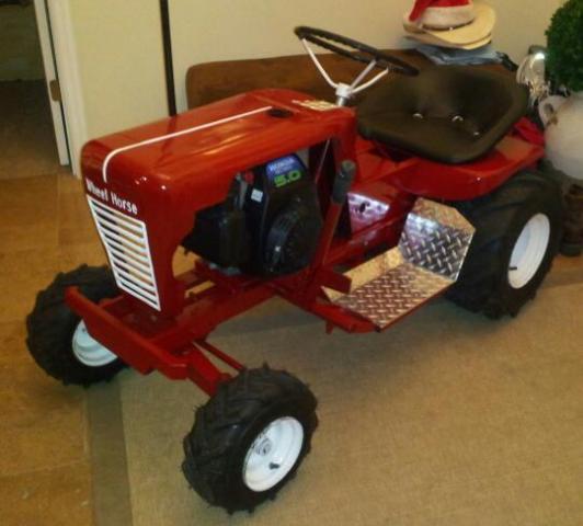

Jim B 0 #1 Posted January 12, 2012 Hello all, New to this forum as I am a new Wheel horse owner. I bought my Son (2 1/2 yrs) an L157 for christmas. It took a week of up all nights but I got it done just in time for christmas. It was in bad shape and an attempt to modify sometime many years ago left it in bad shape for a factory restoration. But it was a perfect canidate for a kids play/pull tractor. I had to split the transmission case because it didnt want to shift when I got it home. Much to my dismay I found the trans full of water/oil. The gears are useable but most of the bearings were shot. I had to clean EVERY needle bearing with emerycloth so I could get it to work for Christmas. I need to replace all of the bearings and seals. I have not had much luck finding the bearing online. Many are discontinued. Does anyone know where I can find these bearings at a resonable price? or does anyone know the cross to a fedral mogule part number? I have all of the wheel horse numbers but no luck so far on finding parts that a working class guy can afford. Thanks, Jim B Share this post Link to post Share on other sites

AMC RULES 37,235 #3 Posted January 12, 2012 Tractor looks great so far, what a lucky little boy. Jim. Share this post Link to post Share on other sites
Jake Kuhn 1,581 #4 Posted January 12, 2012 :WRS: your tractor looks great so far :handgestures-thumbup: Share this post Link to post Share on other sites
Buckshot 1 15 #5 Posted January 12, 2012 :WRS: Nice outstanding work. :flags-usa: Share this post Link to post Share on other sites
JC 1965 1,532 #6 Posted January 12, 2012 Hello and That tractor looks great. If your son takes good care of it , he can pass it down to his son. :thumbs2: Share this post Link to post Share on other sites
Duff 206 #7 Posted January 12, 2012 Sah-weet looking tractor! Great job! Duff :handgestures-thumbup: Share this post Link to post Share on other sites
Sparky-(Admin) 23,794 #8 Posted January 12, 2012 Nice looking machine! I have that same Honda engine on a 656 and it pulls me around with ease . Mike...... Share this post Link to post Share on other sites
Irv 115 #9 Posted January 13, 2012 Check with member racinfool40. he may be able to hook you up with some bearings. Click on "members" and the tab above. oh! :WRS: Share this post Link to post Share on other sites
can whlvr 994 #10 Posted January 13, 2012 :WRS: great lookin tractor,what a gift,hell have it for years and you can be proud of it all the time Share this post Link to post Share on other sites
speedyleedy 205 #11 Posted January 13, 2012 Great looking tractor your little boy is a lucky little guy ! "good job dad" :) Share this post Link to post Share on other sites
546cowboy 302 #12 Posted January 13, 2012 Boy that's one lucky kid. That thing really looks good. He will be a Wheel Horse fanatic for life now. Share this post Link to post Share on other sites
