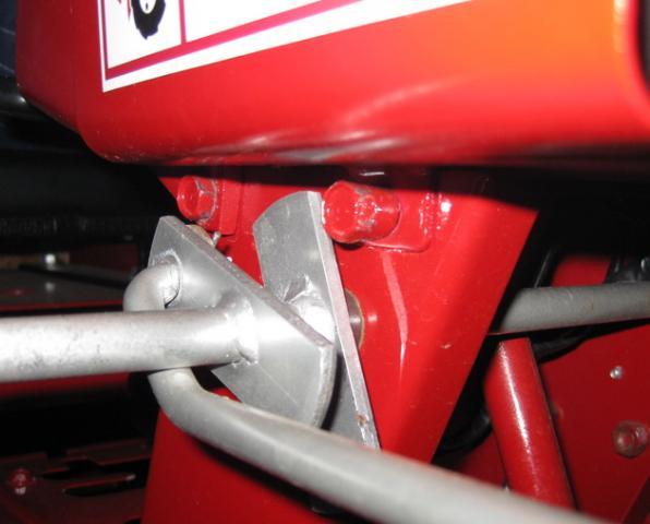

Anglo Traction 761 #1 Posted January 10, 2012 Thought I'd ask the question first before I tighten up the bolt. Does the PTO Lever Bar that engages the Switch on one end, touch the Bolt Head (one not yet tightened up in Pic) to act as a stop for the Lever at the other end? (the end with the hole in it). If it is supposed to, I'll have to make up a special one that protrudes further. I don't have a Brake Pad on the PTO Clutch Pulley to limit disengagement travel. Thanks in anticipation Share this post Link to post Share on other sites
varosd 1,185 #2 Posted January 10, 2012 yes, on my B-80 it does..I had to run out into the cold garage to look. must be late over in the UK by now. nice resto by the looks of it Rich Share this post Link to post Share on other sites

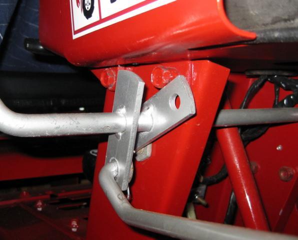

rmaynard 17,106 #5 Posted January 10, 2012 Just to add a few pictures, here are two pics, one engaged, the other disengaged. My bolt has a 5/16" collar on it. But anything that can be used as a stopper. My worker has larger nut in place of the collar. Share this post Link to post Share on other sites
Anglo Traction 761 #6 Posted January 10, 2012 Insomnia means: That 12 hour shift tomorrow is going to really suck! Fortunately It wasn't 12hrs and I have a lay in tomorrow. Regards. Just to add a few pictures, here are two pics, one engaged, the other disengaged. My bolt has a 5/16" collar on it. But anything that can be used as a stopper. My worker has larger nut in place of the collar. Bob , Many thanks for the Pics. I'll now be ahead when I set up the Linkage etc. Regards. Share this post Link to post Share on other sites
