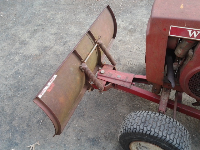

CTPATRIOT 12 #1 Posted January 9, 2012 The front blade i picked up yesterday was ALL apart.I'm missing the bolt or pin(?)that holds the bottom of the blade where it mounts up.Anybody know what i need,or have a pic? Share this post Link to post Share on other sites
rmaynard 16,590 #2 Posted January 9, 2012 Do you know the model number of the blade? Year? Size? Share this post Link to post Share on other sites
CTPATRIOT 12 #3 Posted January 9, 2012 42" from the "70's Share this post Link to post Share on other sites
CTPATRIOT 12 #4 Posted January 9, 2012 Here's a pic. Share this post Link to post Share on other sites
tgranthamfd 29 #5 Posted January 10, 2012 You talking about the bar that fits into the axle hitch? I think it is 3/4". I can run outside in a minute and measure the length for ya. Share this post Link to post Share on other sites
tgranthamfd 29 #6 Posted January 10, 2012 On mine it is a peice of 3/4" bar stock with holes drilled through, to hold a keeper pin just to the outside of the plow frame. The length on mine , from end to end, is 15 3/4". Mine, also, has 2 sets of holes to accomidate long or shrot frame tractors. Did not get a picture but hope this is what you were looking for. Share this post Link to post Share on other sites
Scrumpy 5 #7 Posted January 11, 2012 Sounds more like he is looking for the pivot bolt that the blade attaches to the plow frame right where it joins in an "A". Mine is packed behind a bunch of equipment in my garage or I would get you a measurement. Share this post Link to post Share on other sites
