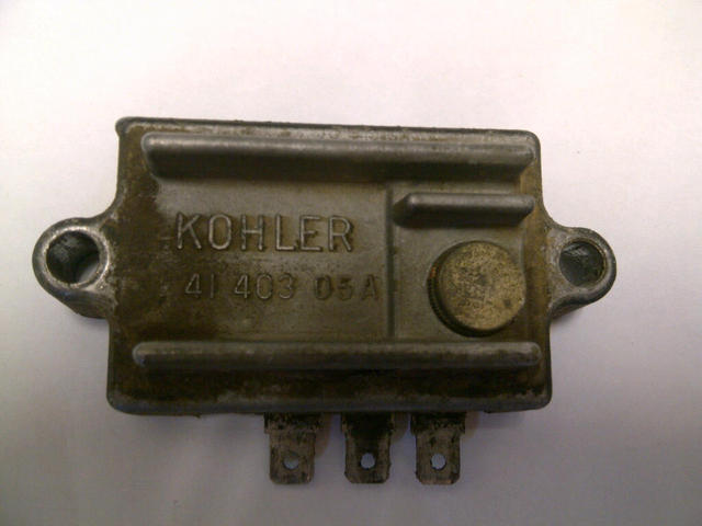

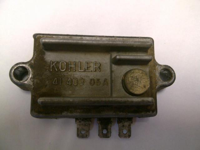

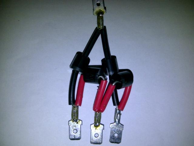

shameless 3 #1 Posted January 3, 2012 Hi Guys: Checking the charging system on my 312-8. found this after chasing wires. It was attached to the fan shroud with two bolts. I did a bit of reading and got out my meter to measure. I grounded one of the bolts directly to the battery to be sure of a good ground. The outside terminal supplied AC voltage in the 30 volt range at mid throttle and more at higher rpm. The center terminal connected to a violet colored wire. There was no output voltage. Did some more reading and figured the unit was N.F.G. Built this out of 6 amp diodes from The Source (Canadian version of Radio Shack).for $6. Connected it to the original flat plug at the engine shroud. The violet colored center DC wire dissapears behind the shroud and reappears at the back of the motor and connects to a molex where the wires change colors. I cut the wire at this point to ensure that if my creation did not work, I could contain the damage. I took my measurements at the cut point. It works and changes the AC from the stator to DC. The DC output voltage is almost as high as the input voltage when checked with no load. Will I need to regulate this voltage or will the load (100 watt fornt lights) lower the voltage? Share this post Link to post Share on other sites
meadowfield 2,955 #2 Posted January 3, 2012 I was just about to dig deeper into some of saveoldirons posts for the very same reason... What you have made will work, but does not limit the maximum charge/battery voltage to around 14.4V so unless you have low revs or a big load there is a danger you will over charge the battery. A correctly working regulator will rectify, but also cut out when the battery is charged - around 14V (most cars charge between 13.8V - 14.4V) just found one of the useful posts... mark Share this post Link to post Share on other sites

shameless 3 #4 Posted January 4, 2012 hey can whlvr: Ingenious...nah............ I copied the design from a youtube video. It works fine, I hope someone can answer my question about regulating the voltage and no load versus load. I live in Hamilton. Share this post Link to post Share on other sites
meadowfield 2,955 #5 Posted January 4, 2012 it's a certainty if you have a stator over 3A (most k series kohlers are min 15A) then charging a battery unregulated will cause it to overcharge, it will boil the electrolyte, create excess gas and fail - usually catastrophically !!! The only way to save the battery is to dump the excess power - you can either use lights or a big dummy load, i.e. a 2 ohm resistor and a switch. You would have to use this in conjunction with a voltmeter and switch the load in when the voltage is over 14.5V. Personally I think charging this way is too risky, I'd rather run the battery with no charge circuit and charge offline... Btw if anyone has managed to remove the silicon potting compound and supply pictures - I'm more than happy to do a replacement board and find modern alternatives. The board I have is totalled as I just couldnt remove it without breaking it into pieces. thanks mark Share this post Link to post Share on other sites
shameless 3 #6 Posted January 4, 2012 Hey meadowfield: Thanks for the response. When I measured such high DC voltage I knew enough to ask rather than hook it up to the battery and carry on. I built the rectifier cause it cost $6 rather than the $50 plus I saw on line for the proper replacement part. Obviously the stock unit uses more than diodes like I did. Does anyone know what else is in that "brick" other that rectifying diodes? :eusa-think: :eusa-think: Share this post Link to post Share on other sites
meadowfield 2,955 #7 Posted January 4, 2012 there is a 14V zener diode - used to monitor the voltage, and then an SCR (voltage controlled switch) shunts the stator windings. I am keen to copy the Kohler variant, if I can get a picture of top and bottom side with the goop removed! mark Share this post Link to post Share on other sites
