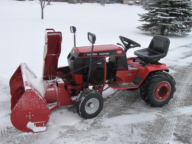

Hydro 131 #19 Posted February 12, 2012 Well I finally got some snow...not much but enought...about 3" and put the M-16 to work on my newly modified 516C. There is no comparison between the M14 and the M16 when it comes to powering a 2 stage snow blower with a hydrostatic transmission. Now some of what I have just said may in part be due to the difference in carburation between the older Kohler and the newer Walboro but the 16 motors right along at this point without really even loading up. Hope to get a foot of snow and really put it to work. I added an original style light bar and a class II hitch. The hitch is not quite complete as it was intended to accomodate suitcase weights but I can't find any up here except the JD brand. Maybe not so bad as they would be at the back of the Horse! The two halogen lights work great but I will need to shorten the bar and then re-postion the lights so they are level. Bent the pipe and made the bracket first however the left side of the bar was too close to the chute and blocked some of the light. Got where I need them now just have to lower and level them. Just having fun :icecream: Share this post Link to post Share on other sites
can whlvr 994 #20 Posted February 13, 2012 nice setup :thumbs: Share this post Link to post Share on other sites
mattd860 162 #21 Posted February 14, 2012 Looks great Gary. You're really putting my old 314 to the test. Good job on the light bar. Share this post Link to post Share on other sites
Hydro 131 #22 Posted February 15, 2012 Thanks Matt. The light bar will be shortened,leveled then painted. I had to start somewhere in order to get a feel for what would work. It's in keeping with the original style. Share this post Link to post Share on other sites
