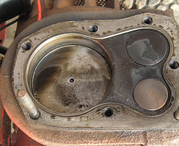

Well this doesn’t look good…Pulled the head this morning and found this
post-5872-0-67072800-1325436138_thumb.jp
Piston definitely has a little play in it…Funny thing is it barely smokes…I guess I didn’t notice anything amiss because I didn’t run it much until my tuneup…It still doesn’t run bad or smoke much…but I’m thinking nothing good can come from ignoring the issue..
Probably will pull the engine and start reading up on replacing pistons and rings…Guess I'd better plan on shoveling if we get any snow this winter.... :angry-banghead:.

Why not clean it up and put it back together, check the float level on the carb and run it?
smoreau
I agree!
Kelly
I've seen WAY worse, run good, just keep a eye on the oil level, my sons tractor he is using this winter smokes but runs great, but better than a shovel.
To be honest, I don't see a oil issue there, almost looks to clean like to much gas washing it, normally a oil burner will have thick tar like deposits on everything.

I'm new to all this...I don't understand the part about gas "washing it" and how adjusting the float level might...It's hard to see in the picture but oil or a mixture of oil and gas was pooled up on the piston when I pulled the head
