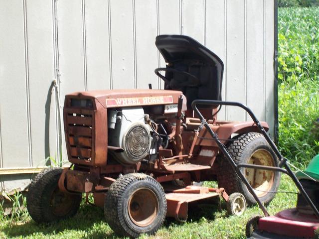

oldagpilot 0 #1 Posted December 31, 2011 I have a case 44 inch Deck on my C12O. The main problem puting it on was that we had to raise the front end up to get it to work on the wheel horse. Share this post Link to post Share on other sites
Sparky-(Admin) 24,646 #2 Posted December 31, 2011 Looks like it fits real well! It even seems to have the same amount of paint fade like its been on that tractor its whole life. Mike............. Share this post Link to post Share on other sites
oldagpilot 0 #3 Posted December 31, 2011 yes the only thing that stands out as not on it from day one is the gray paint on the reman engine. Share this post Link to post Share on other sites
TT-(Moderator) 1,169 #4 Posted December 31, 2011 :WRS: What did you do to make it spin the right direction? Share this post Link to post Share on other sites
oldagpilot 0 #5 Posted December 31, 2011 I twisted the belt,also I used a threaded rod to attach the hand lift. Share this post Link to post Share on other sites
