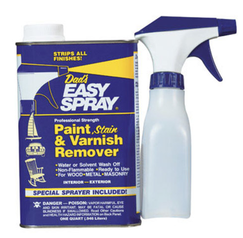

Cole
i have used Dad's easy spray paint remover and in 15 minutes the paint bubbles and scrapes right off to the bear metal. you get best results when you brush on and use a wire brush to scrape off.
