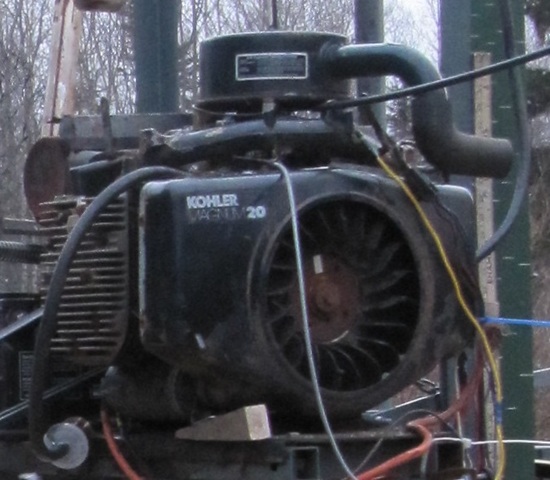

Bugger, you are right TT. The MV20 is a vertical shaft. I am looking at an M20... (too bloody many notes on my scribble page right now). I have attached a pic of the engine in question (currently powering a home-made band-saw mill).
As to my model, it is a '78 C-121 8-speed. Again reference my messy notes page, the 312-8 is the nearest model that my local Toro dealer recognizes (the girl at the counter hadn't even heard of a Wheel Horse before I wandered in) seems these are fairly scarce in Atlantic Canada.

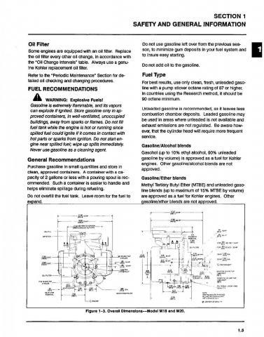

I did find a spec sheet for the M20, but it is a horrible scan (numbers are largely unreadable). I have attached it as well, any chance someone recognises it and has a better copy?

The M20 was actually used on a Horse, as was the M18. You could use a mounting plate for a 418-A or a 418-8 (and probably the 417-A & 8 models too), but you'll need to remove the isolation mount blocks from the frame. If you want to keep the rubber-mounted engine, the C-175 cradle should work.
I'm pretty sure you're in for some hood modifications either way.
