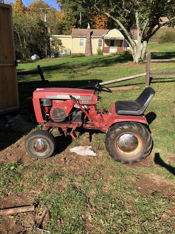

Sammy 89 #81 Posted January 11, 2021 I have a wheel horse 800 special and it’s all original with all the options they could’ve came with and from the outside it sure doesn’t look like it but it’s a sleeper for sure. It’s got a 5.5 inch on the front and a 2.25 inch on the rear and it’ll do 27mph and it’s an amazing show piece and a great toy to do speed runs and rip around my yard! It looks stock but let me tell you it runs like a champ and does great! 2 Share this post Link to post Share on other sites
Maxwell-8 4,371 #82 Posted May 15, 2021 On 1/11/2021 at 3:43 AM, Sammy said: I have a wheel horse 800 special and it’s all original with all the options they could’ve came with and from the outside it sure doesn’t look like it but it’s a sleeper for sure. It’s got a 5.5 inch on the front and a 2.25 inch on the rear and it’ll do 27mph and it’s an amazing show piece and a great toy to do speed runs and rip around my yard! It looks stock but let me tell you it runs like a champ and does great! How is the tranny holding up? Any belt slip on that small rear pulley? Cause I do think this is excessive Share this post Link to post Share on other sites
Warning:Unsupervised 83 #83 Posted May 15, 2021 Id say the issue is lack of stopping power. The brake band is not made to stop at high speed, just beware of its limits. Have fun! Share this post Link to post Share on other sites
Maxwell-8 4,371 #84 Posted May 15, 2021 And starting in 3de gear. because you need to do this in low rpm, to prevent to much belt slip Share this post Link to post Share on other sites
