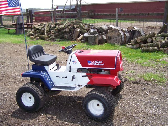

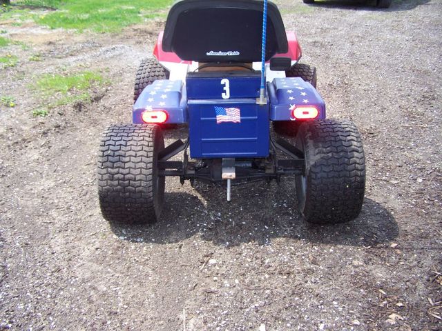

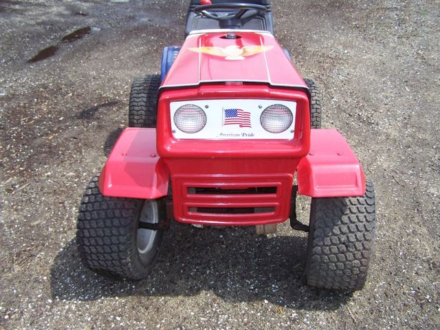

546cowboy 302 #67 Posted September 5, 2013 All very interesting and I have never tried speeding up one of the Horses in my stable. I have considered it though since I have done that with an older Craftsman I got for free. It was too straight to scrap so one thing led to another from paint to extending the axles and spindles, big tires all the way around and changing the pulleys for more speed. I didn't make any changes to the stock steering and that's where it gets scary. It will run about 27 m.p.h. but it is a handful going down the asphalt and those two little brake pads are pretty useless. It does have a 6 speed shift-on-the-fly trans-axle in it so you can downshift it. If I remember right I have a 9" pulley on the engine and a 5" on the trans-axle. Share this post Link to post Share on other sites
