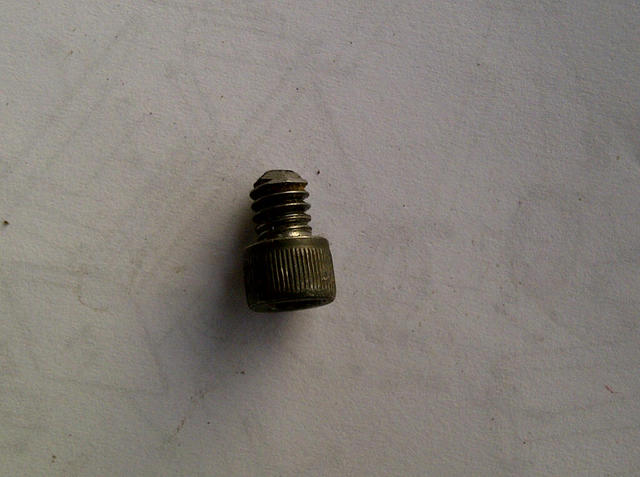

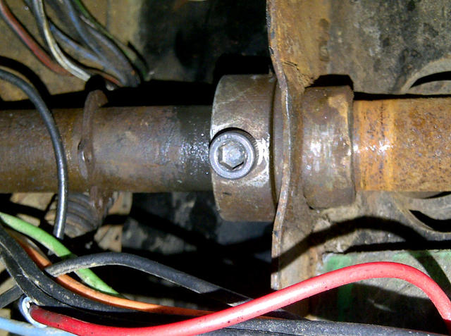

I checked behind the battery and the bushing that passes through the braket had dropped out of place.
It does not look original it has a tapped hole in it 1/4"- 20 and had a bolt in it which was too short and did not make contact with the shaft.
I rounded off the end of a bolt.
post-5770-0-26776300-1324158371_thumb.jp

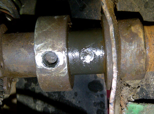

I them drilled through the tapped hole and dimpled the shaft so the bolt would act like a "keyway" and hold tight.
post-5770-0-06665500-1324158515_thumb.jp
And then bolted it up tight!
post-5770-0-27924000-1324158566_thumb.jp

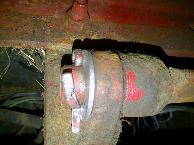

The lower steering shaft had the original cotter pin in it and was a b*tch to reach.
It was flattened out pretty flat.
I added a washer that I had to drill out to fit over the 3/4" shaft and had to pry the shaft from the front to get the cotter pin back in.
post-5770-0-28269000-1324300478_thumb.jp
Thanks again.
P.S The steering is perfect now lock to lock with smooth and easy, even with the added weight of the snow blower in the raised position!!!
