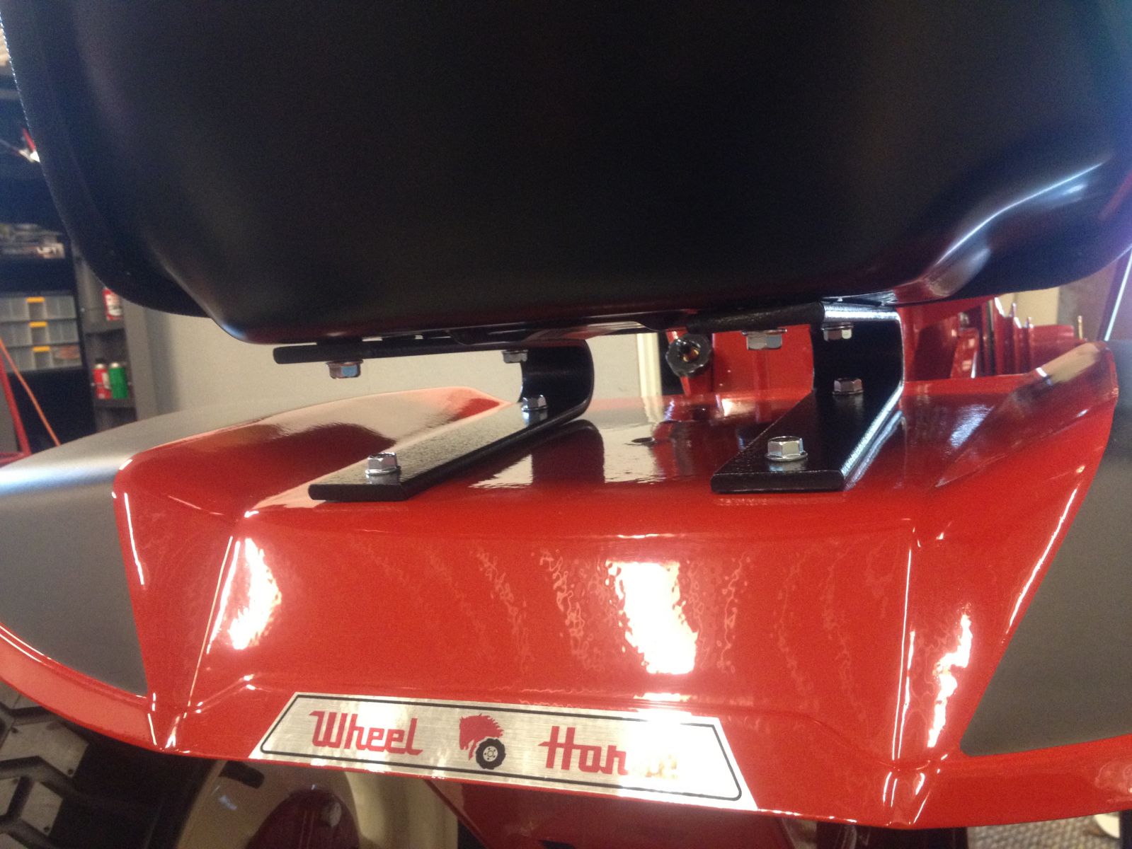

sorekiwi 761 #202 Posted April 21, 2012 Very nice Martin. I think those seats are the best replacement for the original ones, they do look right. I had the same spacing problem on my 1267, so I elected to put a pair of seat springs on. Adds to the comfort level too, my tired old back need all the help it can get! Share this post Link to post Share on other sites

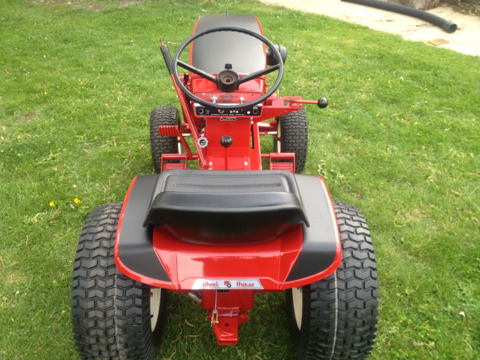

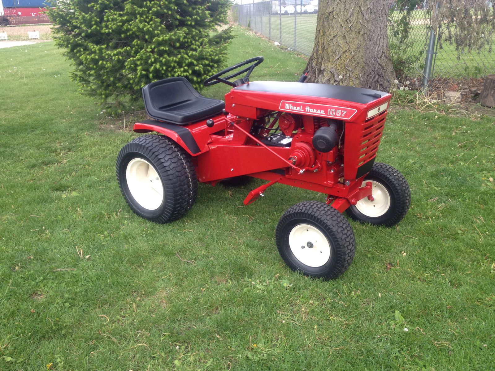

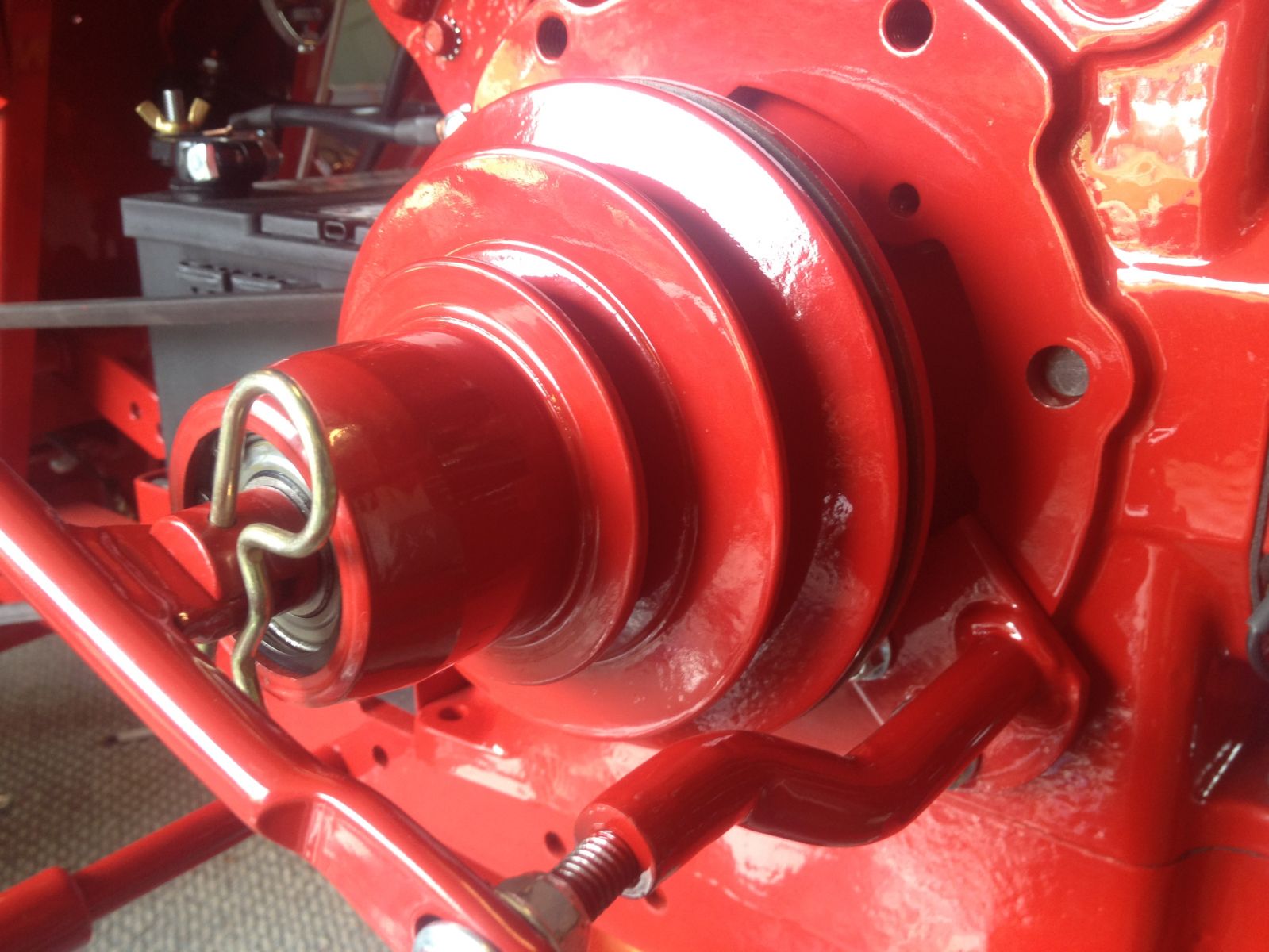

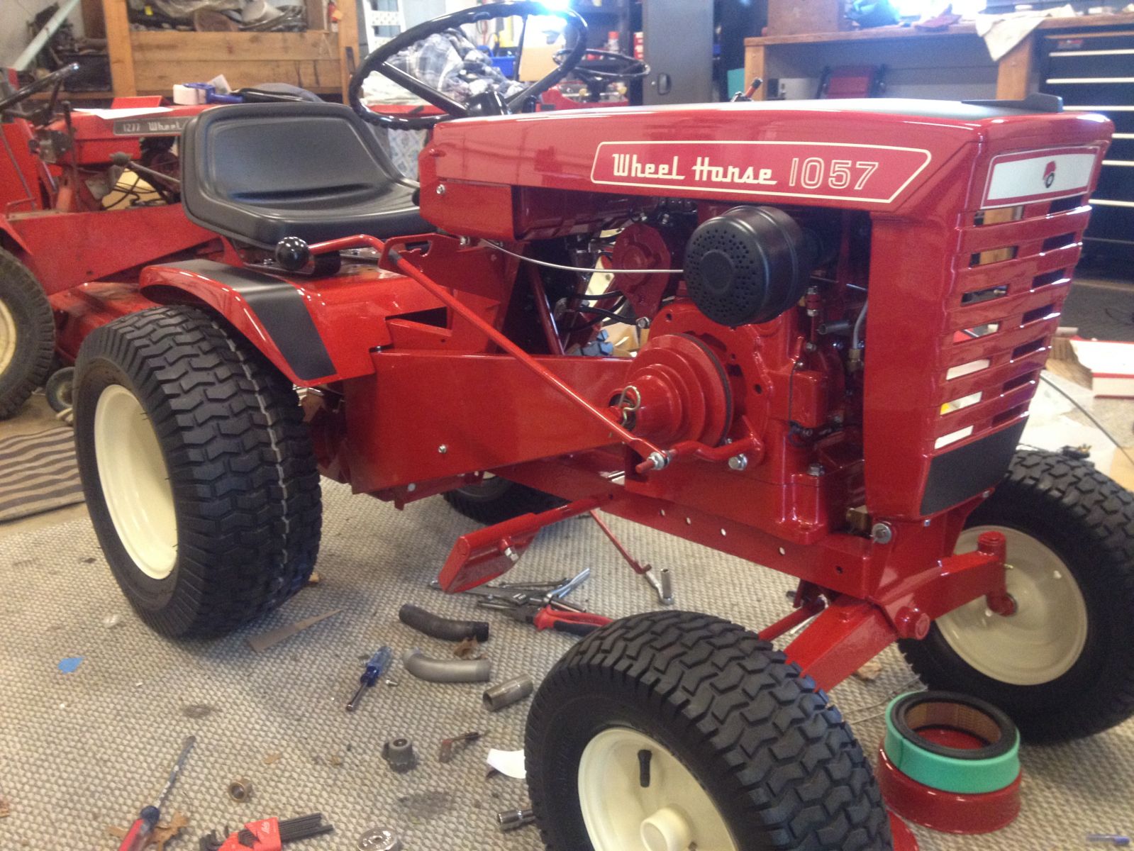

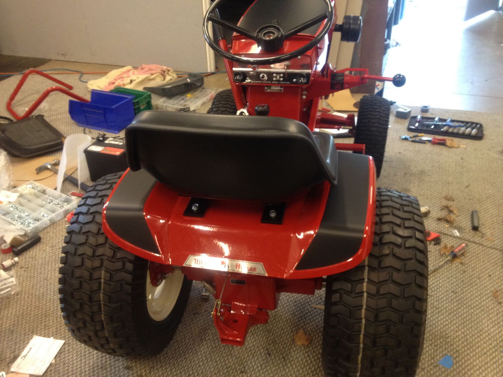

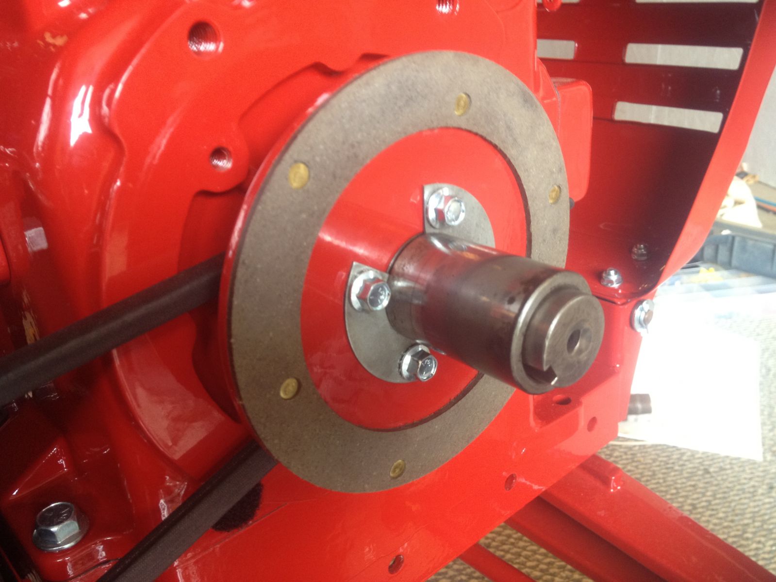

Martin 2,133 #203 Posted April 21, 2012 a little closer to being done...... finished the black on the seat pan, i guess its growing on me, looks better in the flesh than the pics, for some reason the pics i took today dont have the same impact as the red and matt black looks in the sun. also got the pto bearings and seals installed and on the tractor. heres some pics of the pto install and when i dragged it outside on the lawn with the steering wheel propped in position and the seat sitting on some spacers.... 4 Share this post Link to post Share on other sites

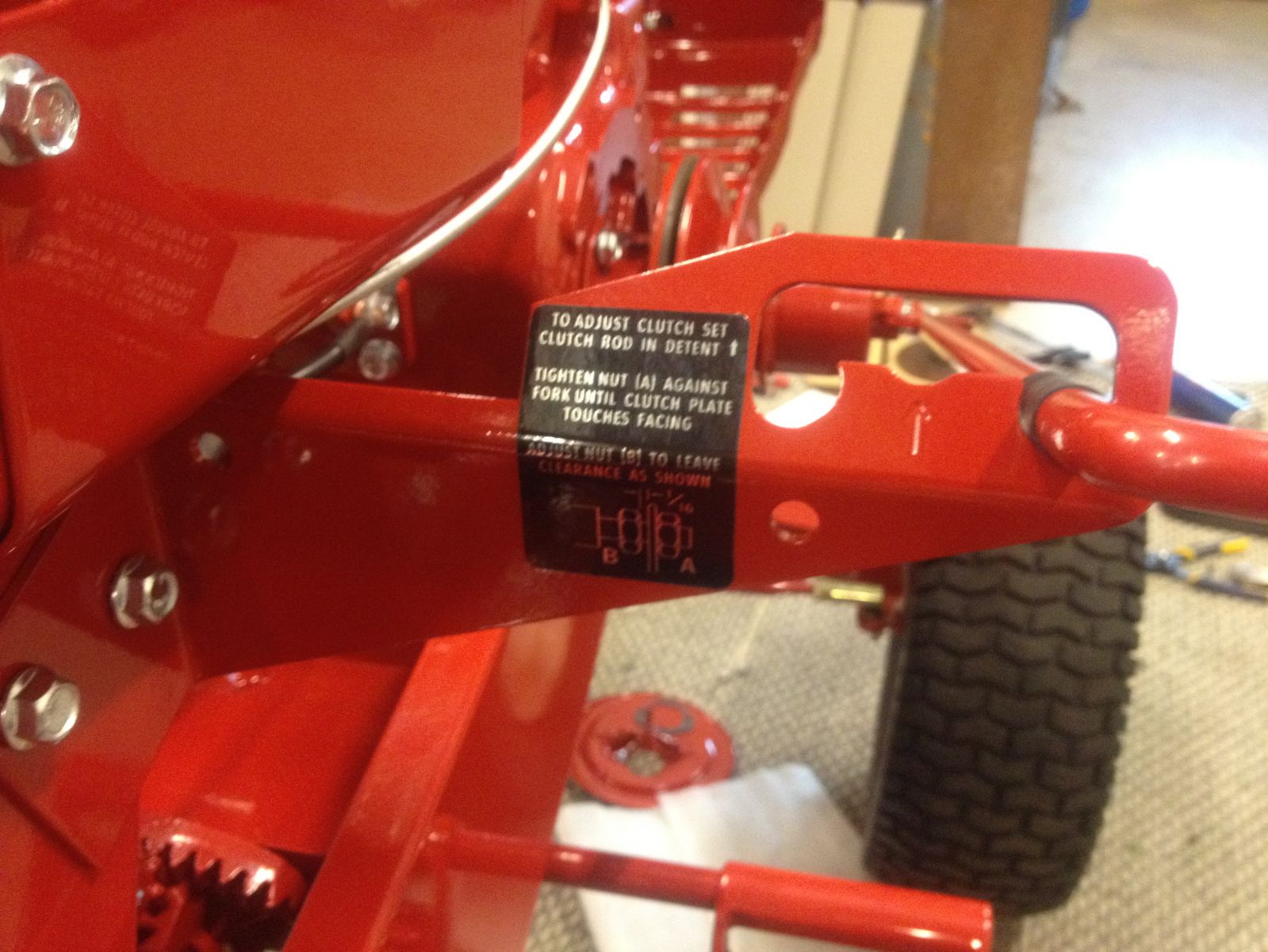

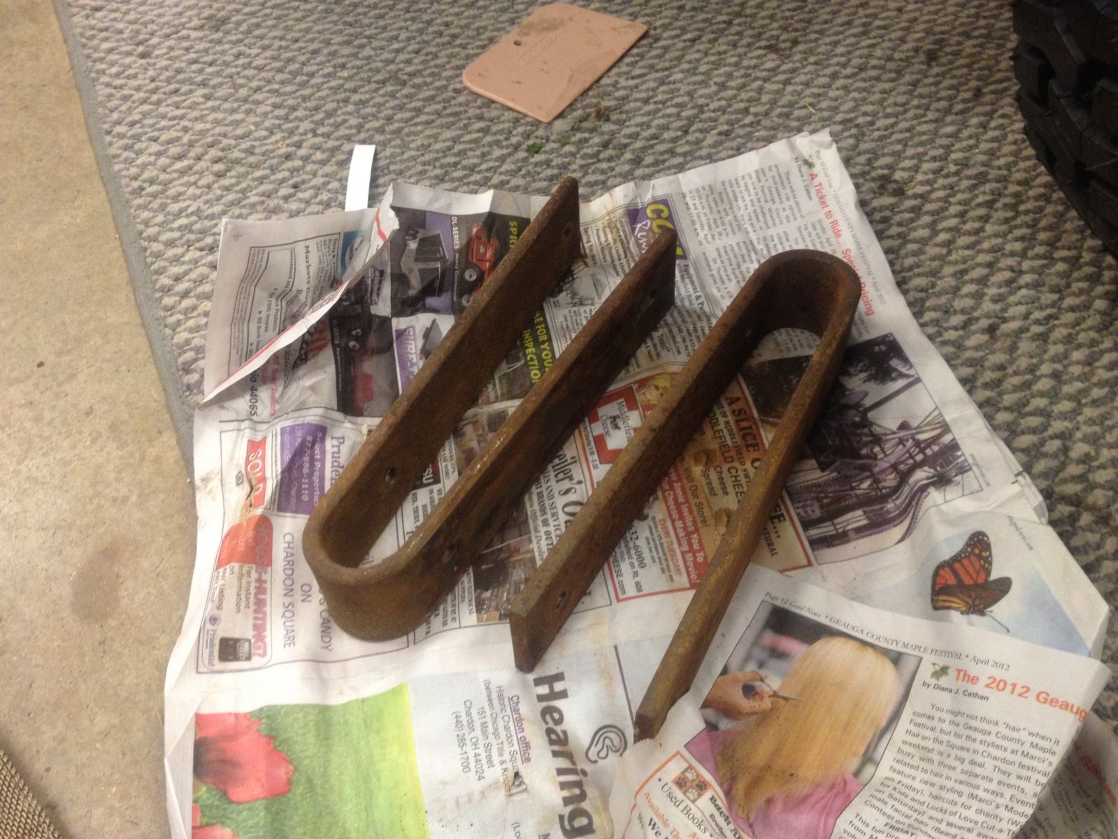

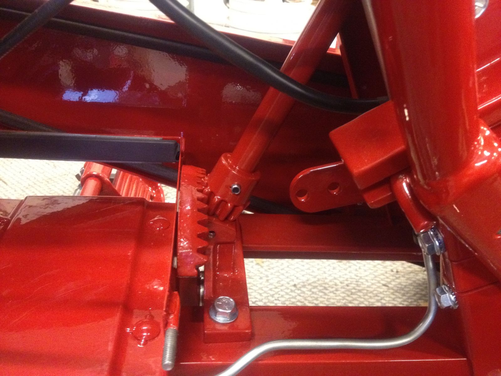

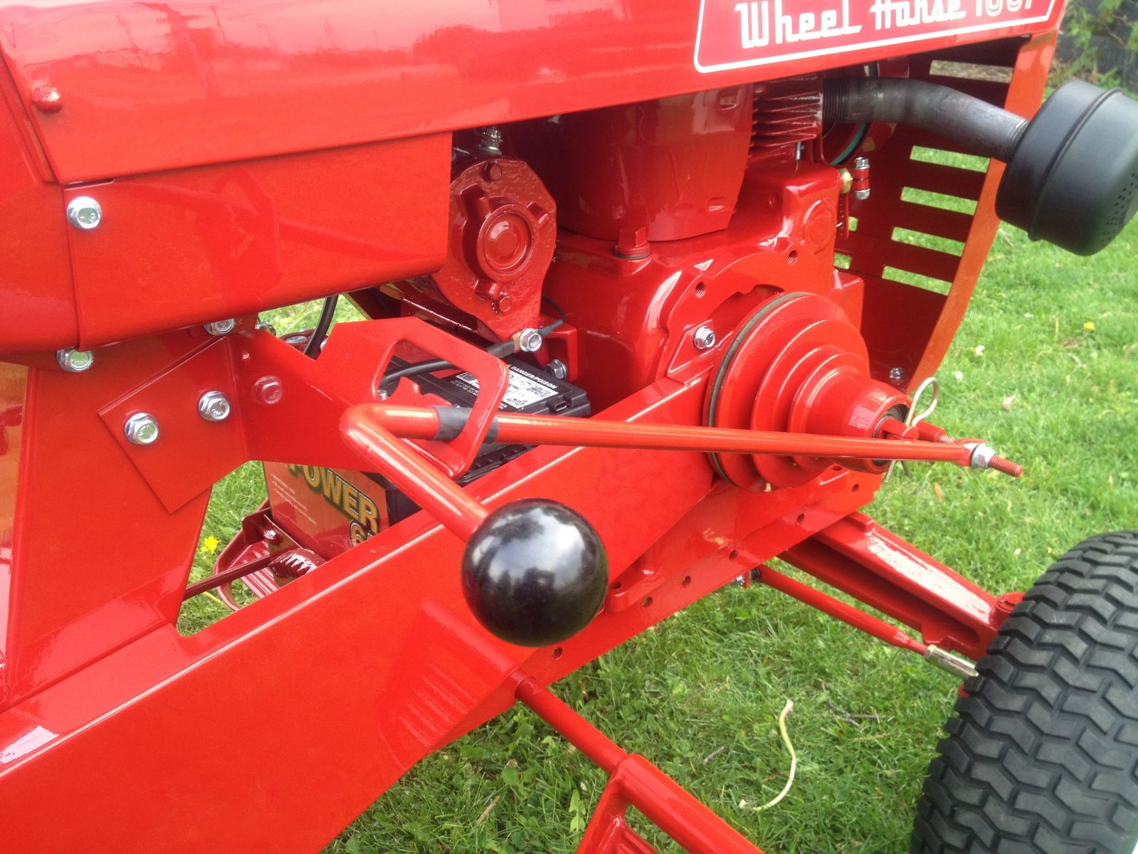

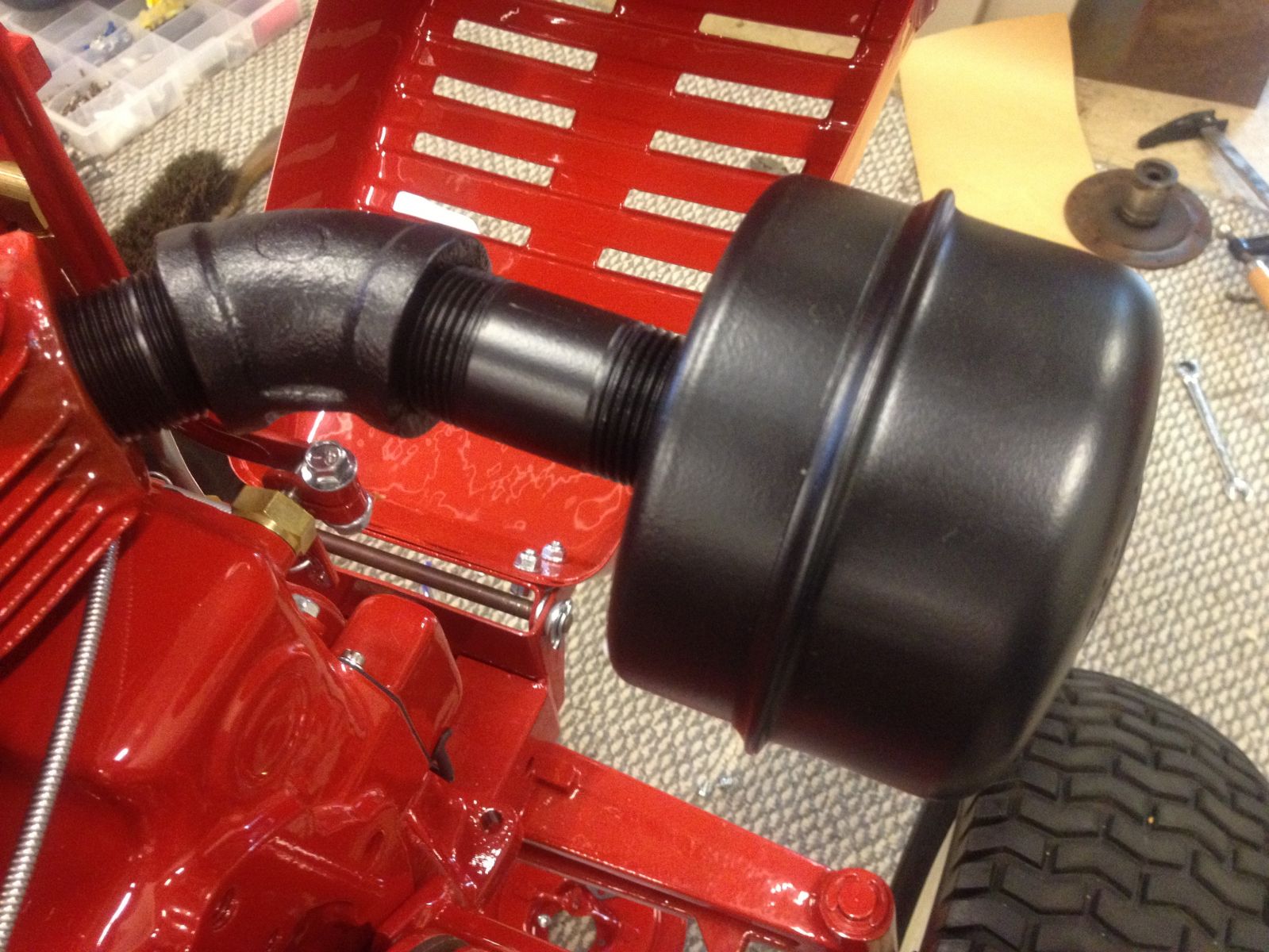

Martin 2,133 #208 Posted April 30, 2012 small update. got the exhaust all sorted. was going to just use a single length of pipe like in my previous pics, but couldnt get it looking good in the bend, so went back to a close and 3" nipple and a 45 degree elbow. we were running a bunch of hi temp black powder at work, so i thought id give that a whirl and see how it holds up. finally got the steering shaft and gears sorted....... choke and throttle cables in, but still messing around with routing them. steering shaft all ready for the steering wheel, once its done. i spent about 6 hours today wet sanding the wheel, still a few hours left on that before its done........will post some pics on that when it done. pto decal on, learned how to make these along with the dash decals yesterday! thanks terry for the schooling..... also got some seat springs from mike (sorekiwi) , will take them to work tomorrow, blast them and throw them in the vibratory machine to get them smoother before paint. im interested to see what sort of ride difference there is with these vs sitting on a seat just bolted to a seat pan..... Share this post Link to post Share on other sites

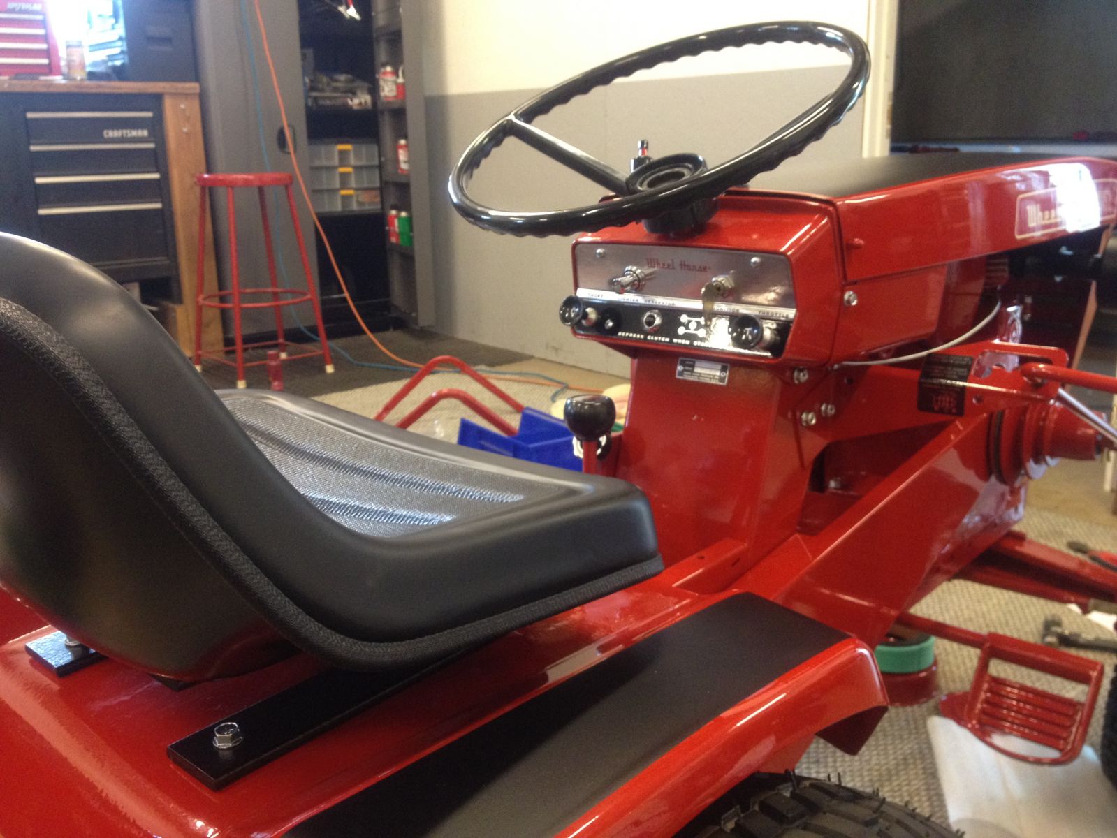

Anglo Traction 761 #210 Posted April 30, 2012 Your work just oozes quality as usual Martin . I see you've used the old Anti Vibration/Rub trick on the PTO Rod where it passes through the Selector Gate!. With the Seat Springs added, will you be ok with the Steering wheel to Knee Clearance ?. I noticed they (WH) extended the Upper Shaft length on Seat Sprung Models around 73-74. Prior to that, the Part nbr seemed pretty generic. I believe you Fabbed the Upper shaft anyway, so maybe it's a dumb question . Share this post Link to post Share on other sites
Martin 2,133 #211 Posted April 30, 2012 no dumb questions. havent had the chance to check it with the seat springs yet. would like to clean them up first. i can say that with the seat sitting on just the pan i have at least 5 inches of clearance to the wheel from my legs. the outer rim of the steering wheels on these mid sixties long hoods sit up from the dash quite a distance. they need to as there is a clearance problem with the opening of the hood when using smaller 'less offset' wheels..... when i fabbed the shaft, the length was done so that the hub of the wheel would be sitting about 1/2" off the dash. much the same as my 1277. so its probably about standard length. the pto anti rub trick is just some heat shrink tubing at the moment. its not really holding up. might go to a piece of clear plastic hose or something else more robust. Share this post Link to post Share on other sites
sorekiwi 761 #212 Posted April 30, 2012 Looks good Martin! I do like the powder on the exhaust, it will be interesting to see how it holds up. What did you end up getting for choke and throttle cables? I remember the discussion a few months back but dont remember the outcome... Share this post Link to post Share on other sites
Martin 2,133 #213 Posted April 30, 2012 the paint is supposed to be good for constant 800 degrees, so we will see. i do know that its unusual powder, very hard to get an even finish when applying it, if you have to remove it, the burn ovens wont touch it, and neither will chemical stripper. but it blasts off real easy, whereas normal powder is exactly the opposite....... cables...... i got the ebay stens ones. i know all the problems with these cables, but i had to get something. so we will see how long they last. i do know the locking mechanism seems like it locks very easy, so not a lot of twisting force on the knob. the oem cable on the 875 doesnt lock at all so im not sure if its the same mechanism. looks to be different, but without looking at it apart im not sure. the stens one looks like the inner cable is keyed to a threaded ferrule that moves as you turn the knob, eventually it runs out of thread and binds inside to lock. is this how the oem ones are? if i get around to it i might end up pinning the knob to the cable. we will see......... Share this post Link to post Share on other sites
AMC RULES 37,225 #214 Posted April 30, 2012 Can you show us how you pin the knobs to the cables Martin? :thanks: Share this post Link to post Share on other sites
Martin 2,133 #215 Posted April 30, 2012 yeah, if i end up doing that, i will document it with pics. might practice on an old cable first though...... im half tempted to just use it as is and see how long it lasts........ Share this post Link to post Share on other sites

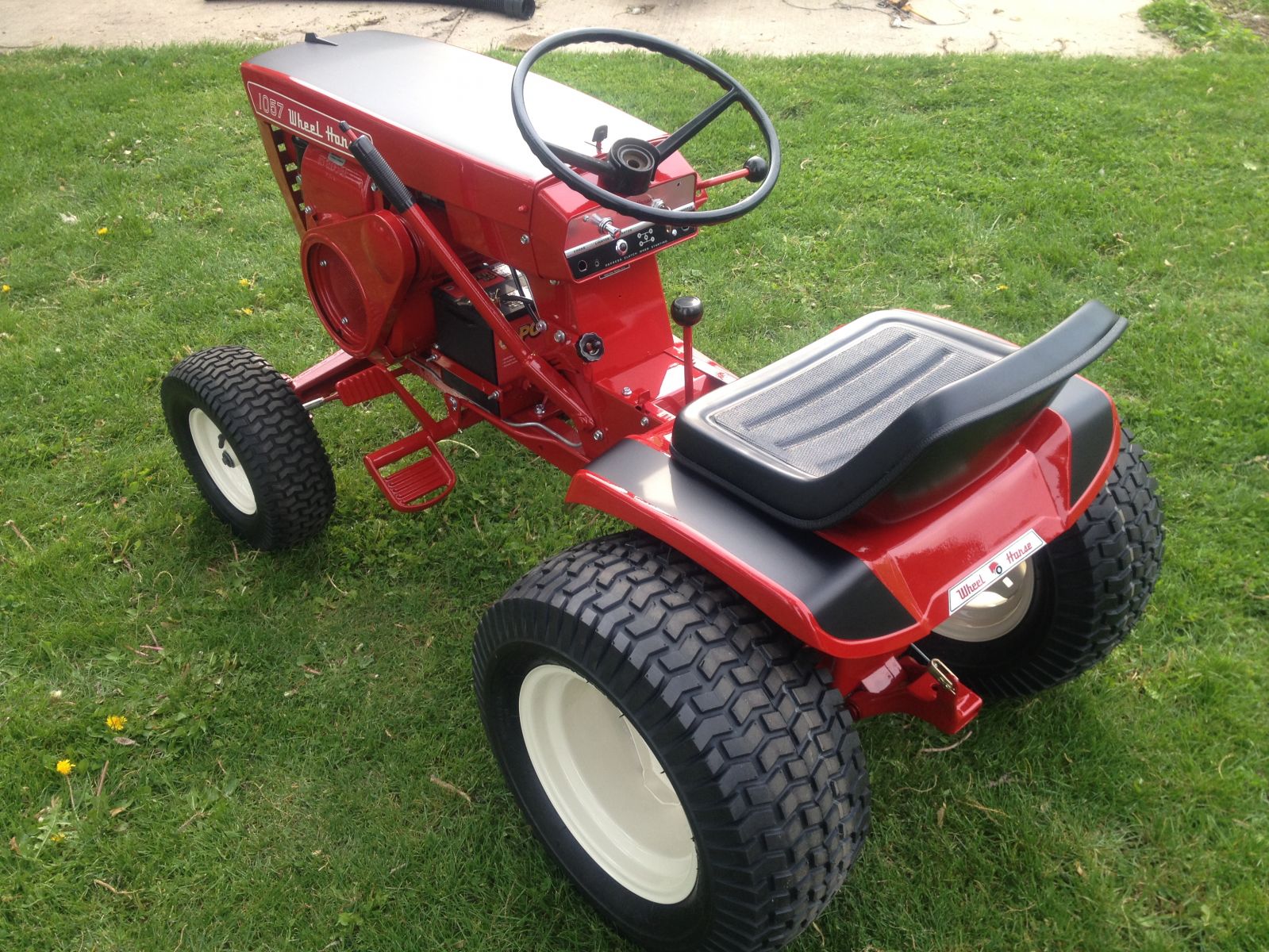

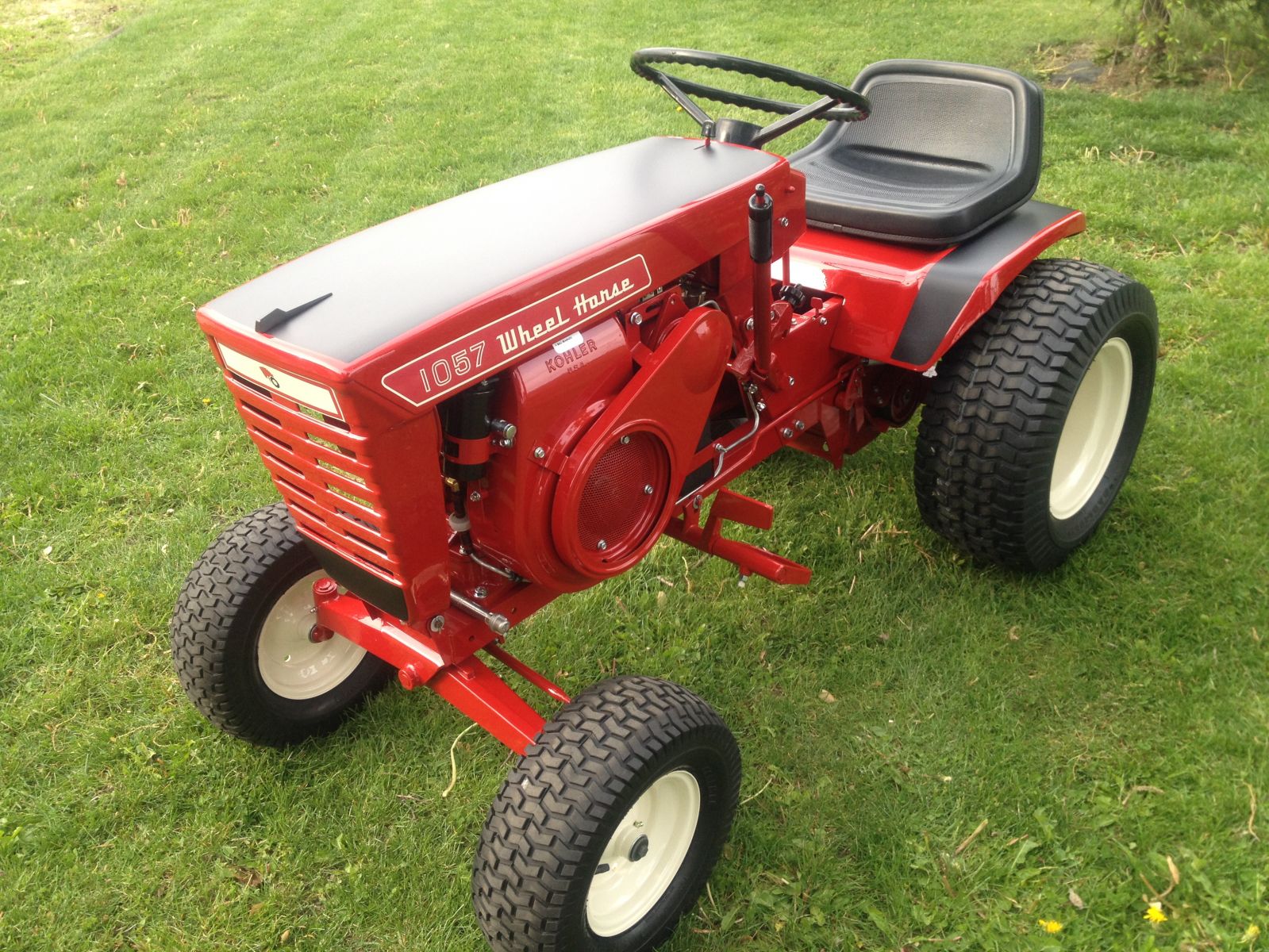

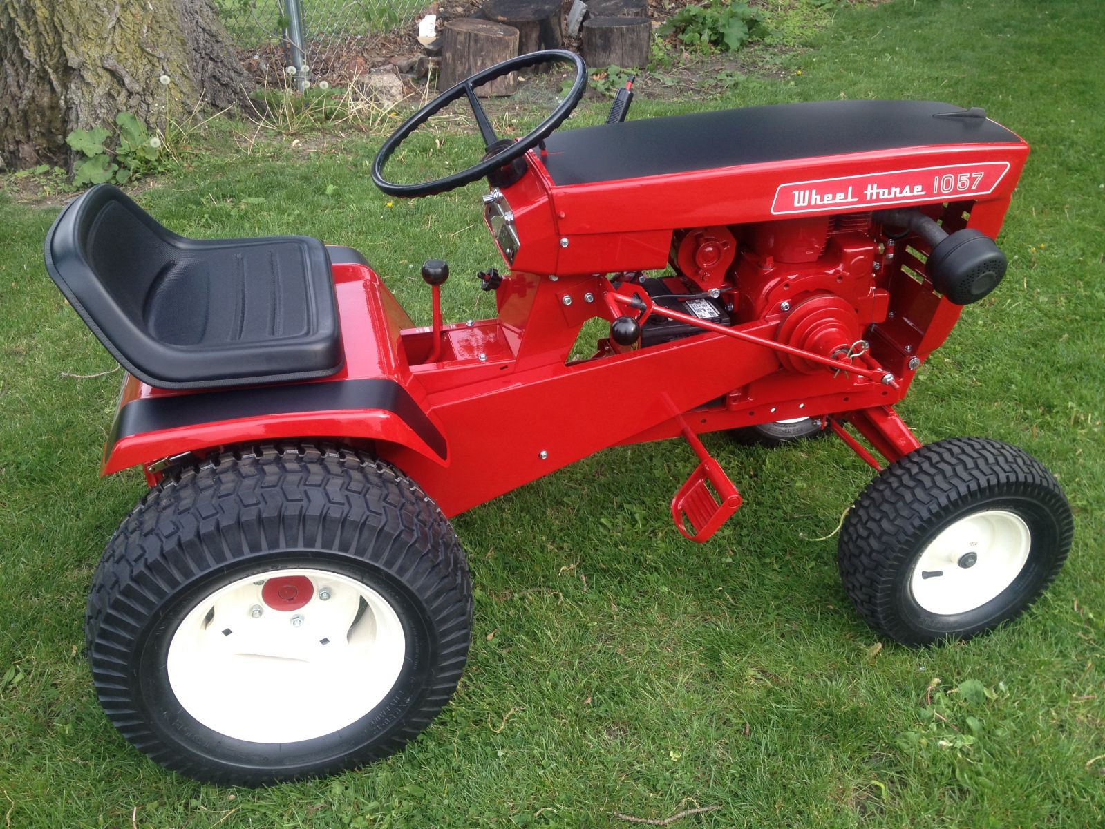

Martin 2,133 #216 Posted April 30, 2012 got the seat springs painted and on. i like it! plenty of room for my legs and some cushion for my back. going to take a while to get used to sitting up higher though...... plenty of leg room, steering wheel still needs a little work, but its a bunch nicer than before...... Share this post Link to post Share on other sites
dclarke 4,098 #217 Posted April 30, 2012 I like the seat springs Martin, been thinkin of doing that to my 867. :thumbs: Share this post Link to post Share on other sites

AMC RULES 37,225 #219 Posted April 30, 2012 Looks better than brand new to me. Share this post Link to post Share on other sites
sorekiwi 761 #220 Posted May 1, 2012 I like the seat springs Martin, been thinkin of doing that to my 867. The seat springs do improve the comfort as well as solving the "big seat on a narrow fender pan" problem. Still not as comfortable as the seat set up on a 520, but a lot easier on the back than the solid mount. (says the kiwi who just returned from yet another trip to the chiropracter... 1 Share this post Link to post Share on other sites
