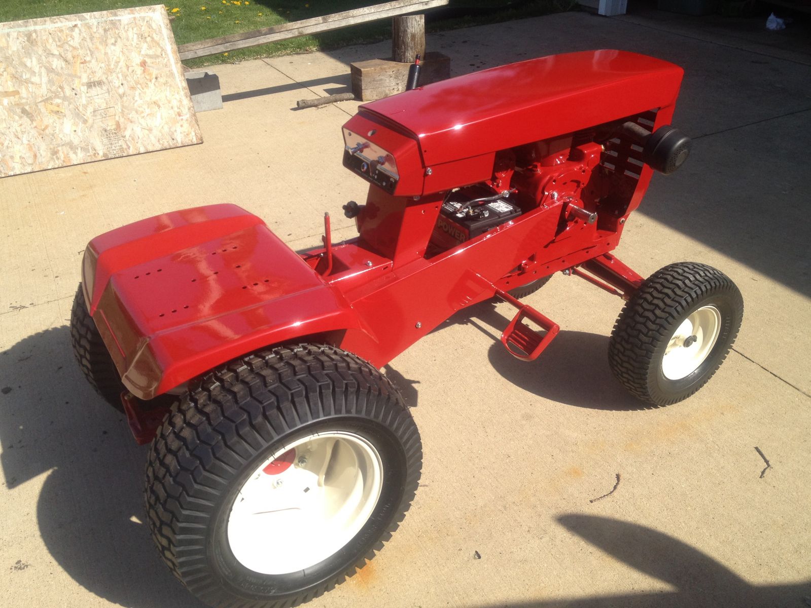

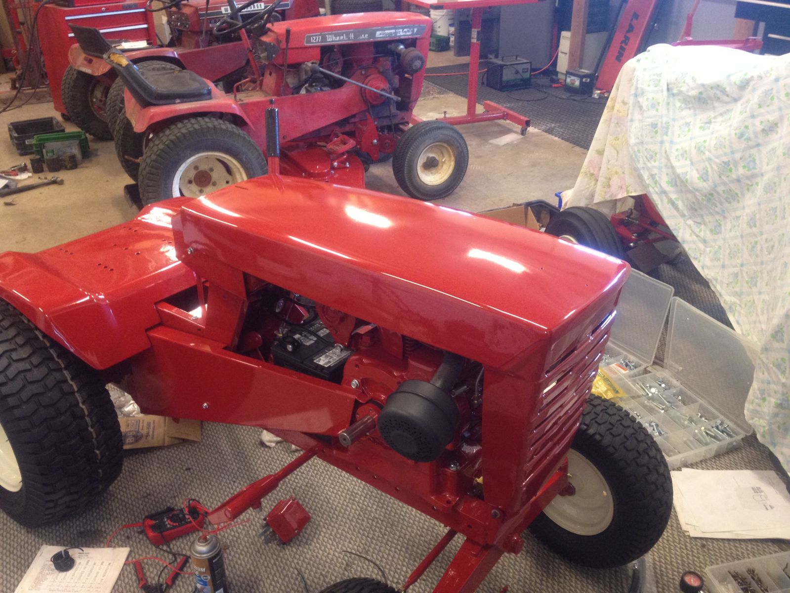

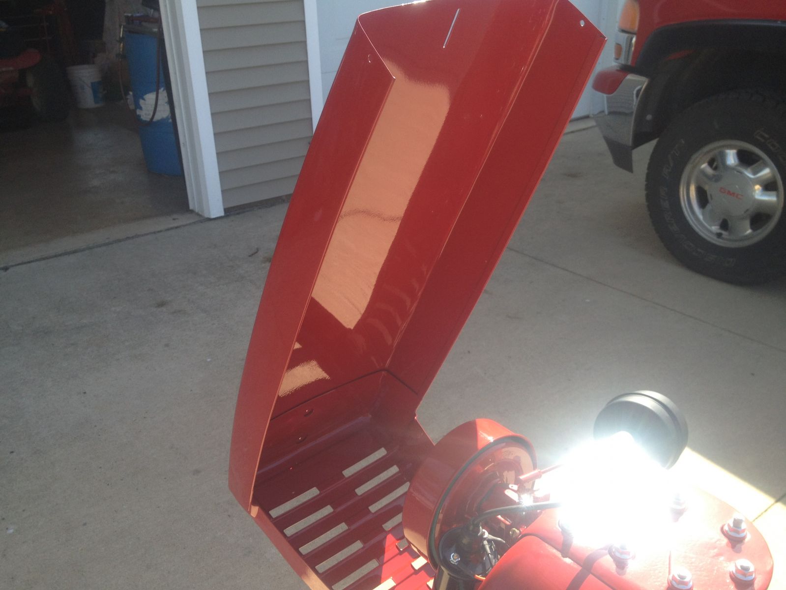

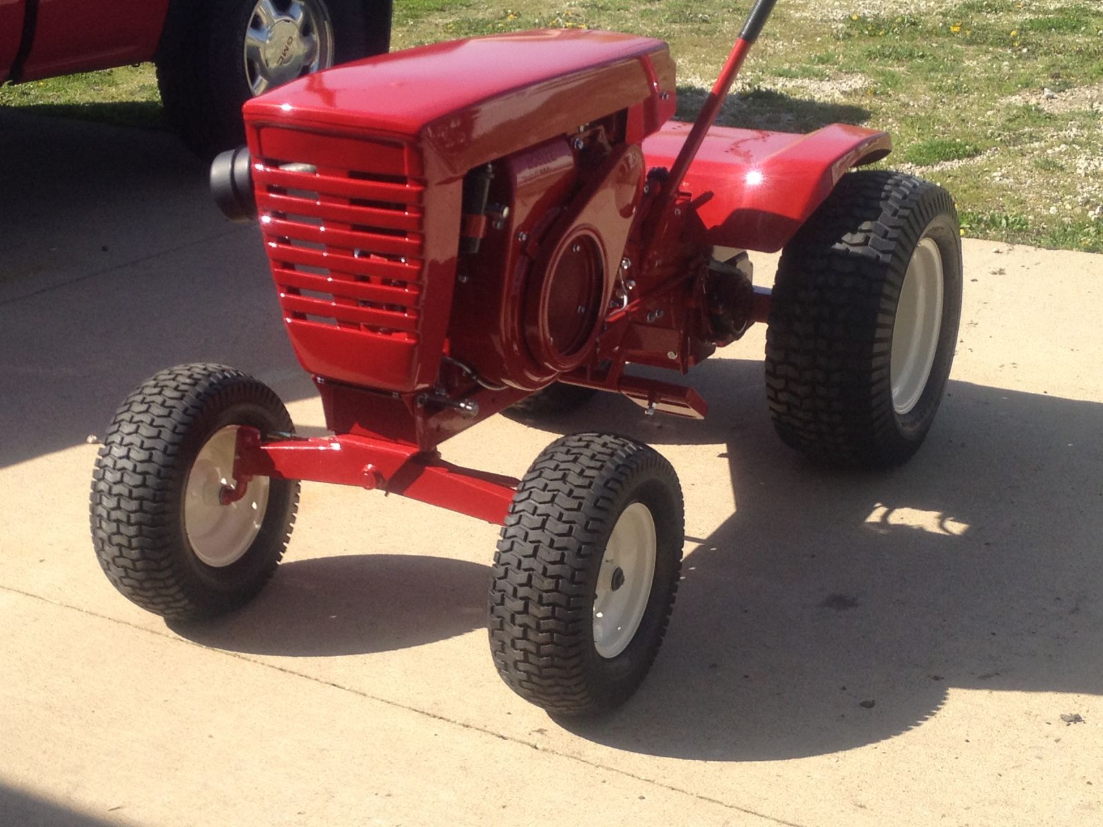

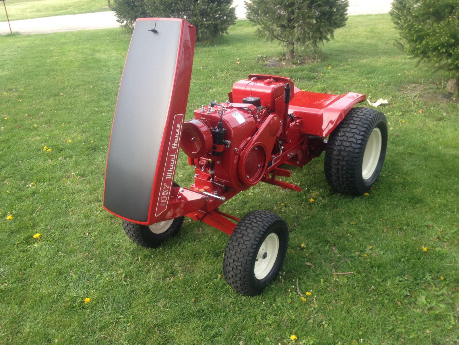

Martin 2,133 #181 Posted April 9, 2012 update....... hoods done, not very well, but its done. and its going to stay that way for a while....... until i get motivated enough to redo it, maybe....... well, i guess i should explain. the pics below are attempt number 2 and while the hood looks great in the pics up close you can see the defects in the paint. the bondo gassed out and put pinholes through the paint. first time its happened. just goes to show that anything can bite you when you least expect it. im no veteran at this, usually powdercoating goes direct to metal, but when you have stretched metal and rust damaged pitted metal, something has to smooth the substrate before paint. it didnt do it everywhere the filler was, just in some places, enough to make it look like crap. ive done a few things with the filler now and this is the first time it reacted like this. first go around on the hood i screwed it up myself by getting wax and grease remover on the filler. it soaked into the filler and when it heated up in the oven the filler lifted off the metal. talk about aggravation........ on the deck i did last week that turned out awesome, maybe i should mount the deck shell where the hood goes...... anyway enough complaining heres what youre all waiting for......... Share this post Link to post Share on other sites
bowtiebutler956 650 #182 Posted April 9, 2012 :text-imsorry: Martin. I now that kind of frustration very, very well. I don't have any experience with powder coating, but it seems like every time I think I've done a nice paint job, some little piece of trash or a bug, or I didn't get something quite clean enough and it reacts with the paint. I can really feel your pain. I don,t know anything about powder. How long do you have to wait before you can sand it down, and hit it again. I know your aggravated right now, but take a day or two of to cool down, and try it again. Matt :flags-texas: Share this post Link to post Share on other sites
Martin 2,133 #183 Posted April 9, 2012 if i do tackle it soon it will be filling the pitting with filler, rubbing down with 320 and reshooting. the reshooting is the hard part. not impossible, but just got to get the right amount of paint on a recoat, too much and it starts to run, too little and you get that rough overspray look. the kv setting has to be just right too otherwise the powder will develop electrical starbursting patterns and then youre done, time to strip and start again........ Share this post Link to post Share on other sites
Martin 2,133 #184 Posted April 10, 2012 every now and again i get reminded by people around me that it is, after all, a garden tractor............................... to answer your question about the time between repainting, theres really not too soon a time. i could in theory have let it cool down and reshoot straight away. its the filler thats the unknown. and if i do redo it, is it going to turn out better or worse? its really on the fence and the smallest problem and it could go either way. which is why i havent done anything yet. i have real nice gloss on the underside and the side of the hood where the decals go and im reluctant to mess with it as its really difficult to get it that smooth on a recoat. the part has to be 100-150 degrees for the paint to adhere well enough to transport into the oven, the powder starts to gel in particles and you end up with orange peel. normally on a first coat the painted part will go into the oven with a good coat of powder and the instant introduction to 400 degrees helps flow the powder as soon as possible reducing orange peel...... Share this post Link to post Share on other sites

Martin 2,133 #186 Posted April 10, 2012 True Martin, but its your garden tractor, and A Wheel Horse Of Coarse! Matt and its going to get some use too. i guess thats why the hoods not stripped already. if i wanted to have perfect paint i wouldnt have done it in powder in the first place. then it wouldnt be free paint either..... i know this stuff can look awesome if the metal is in good condition. just look at the underside of the hood where its just paint on metal. Share this post Link to post Share on other sites
bowtiebutler956 650 #187 Posted April 10, 2012 Looks like a big red Mirror!! Gorgeous! Matt :flags-texas: 1 Share this post Link to post Share on other sites

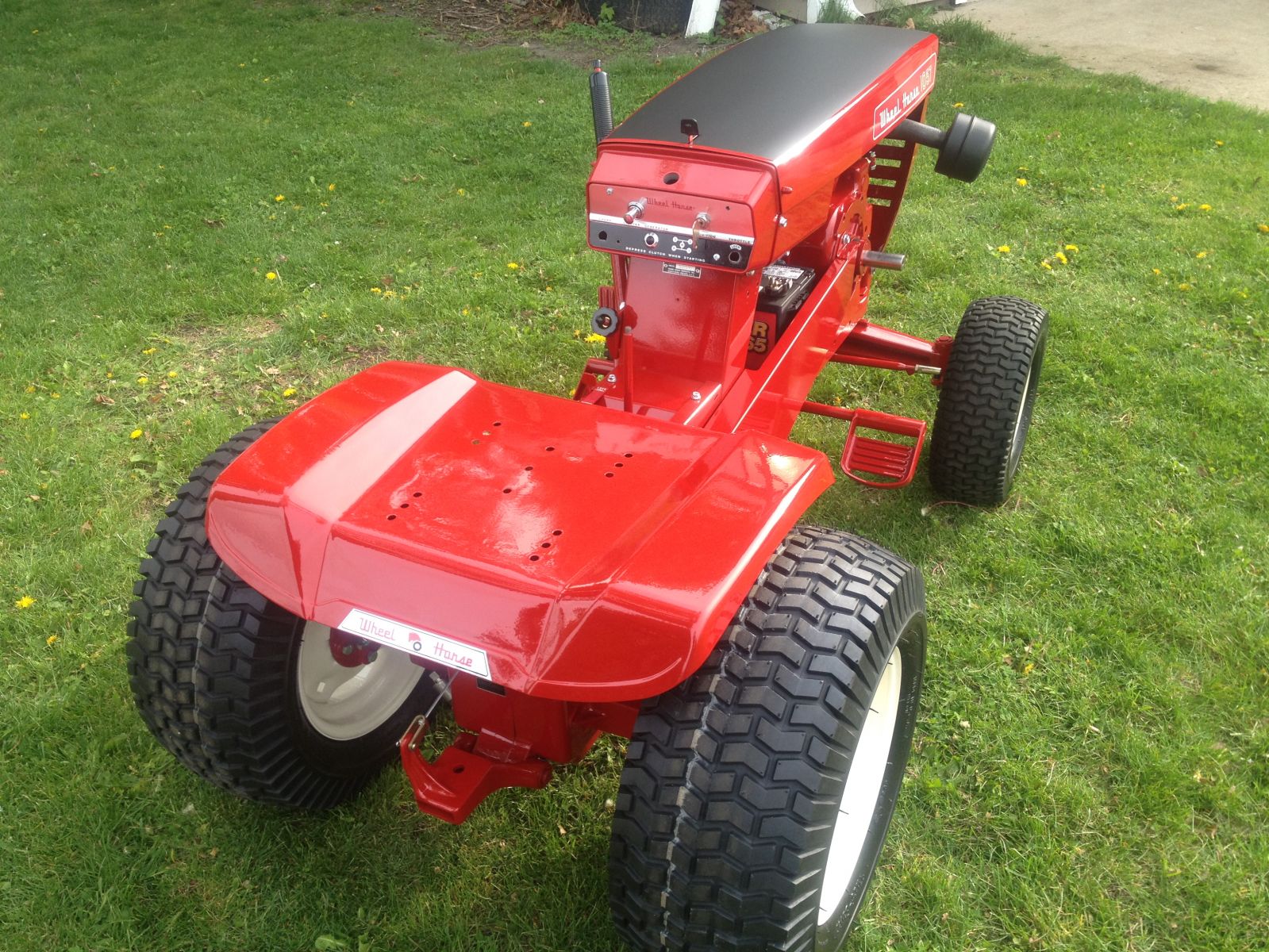

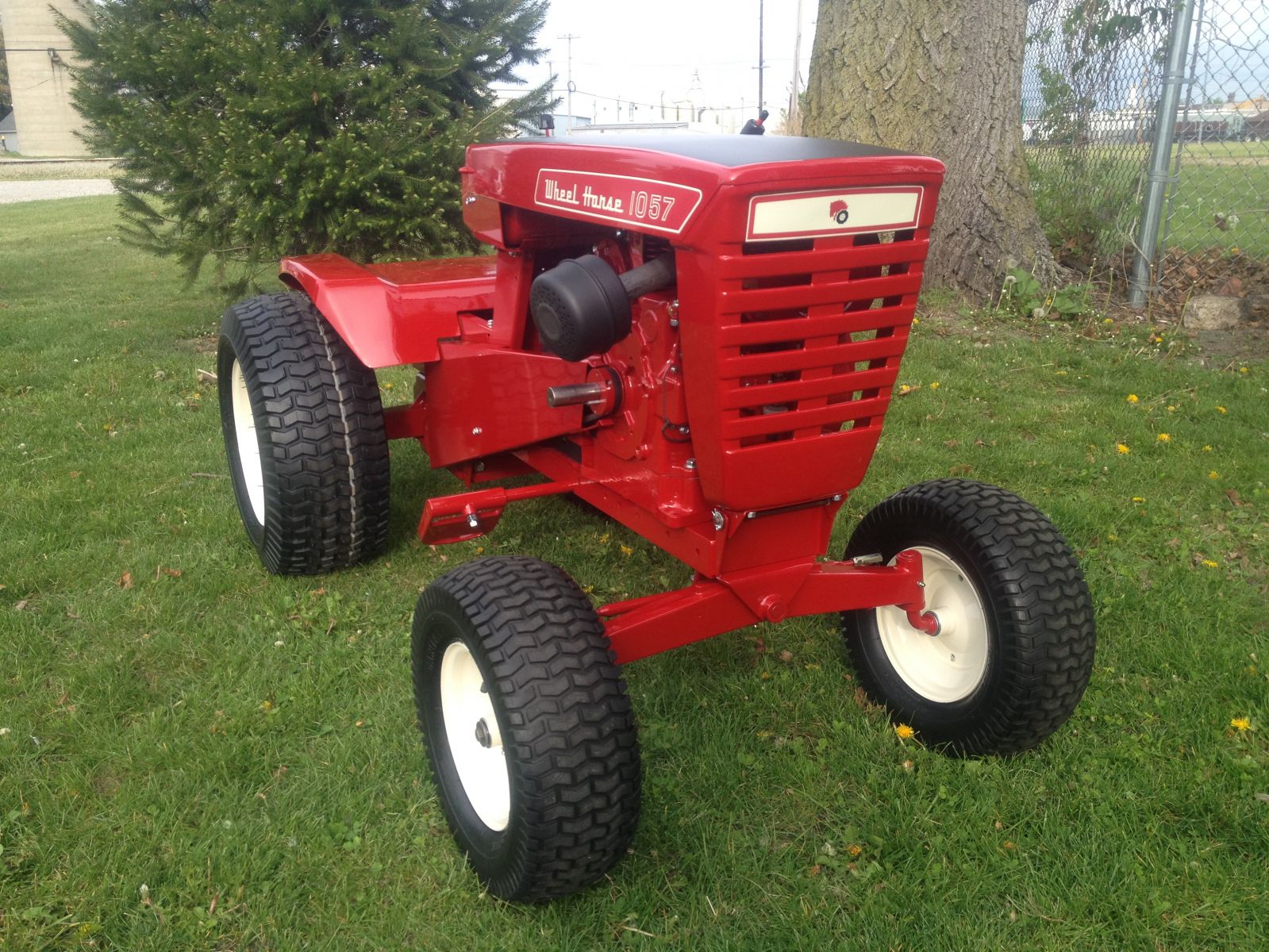

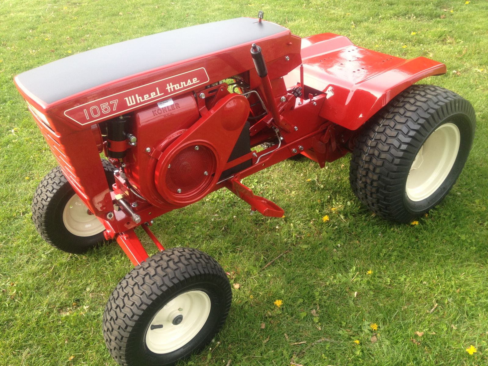

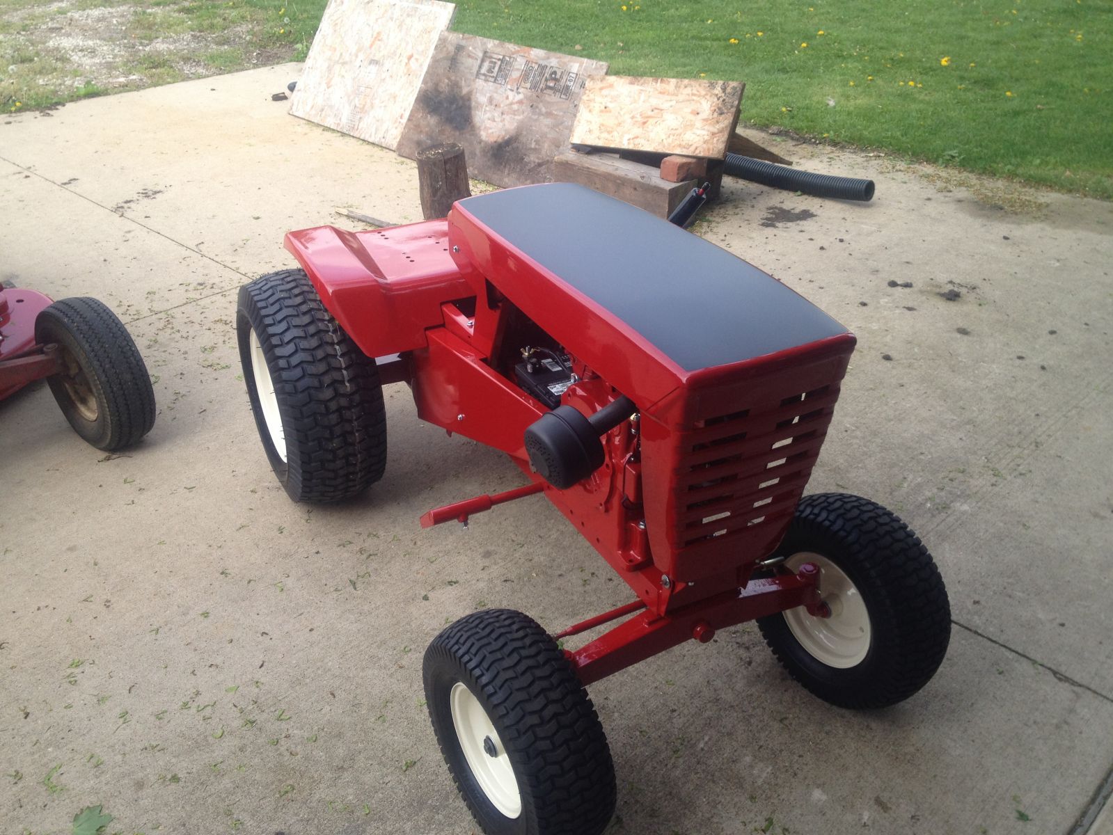

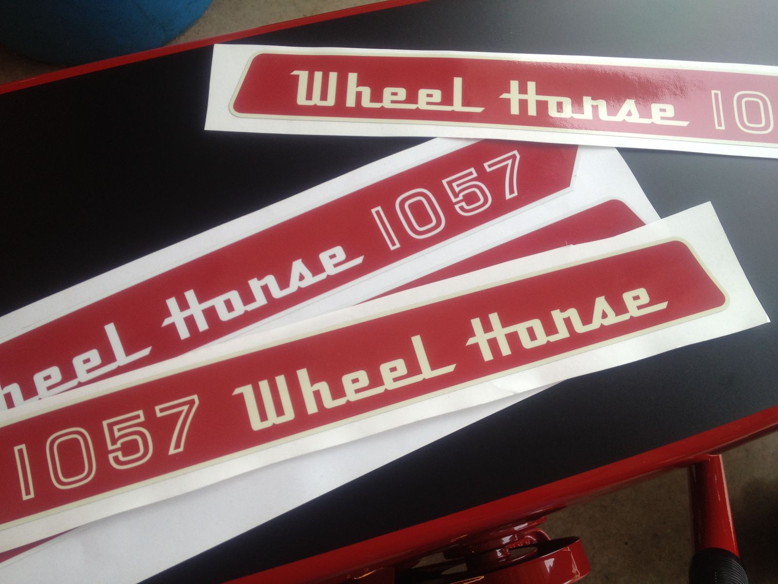

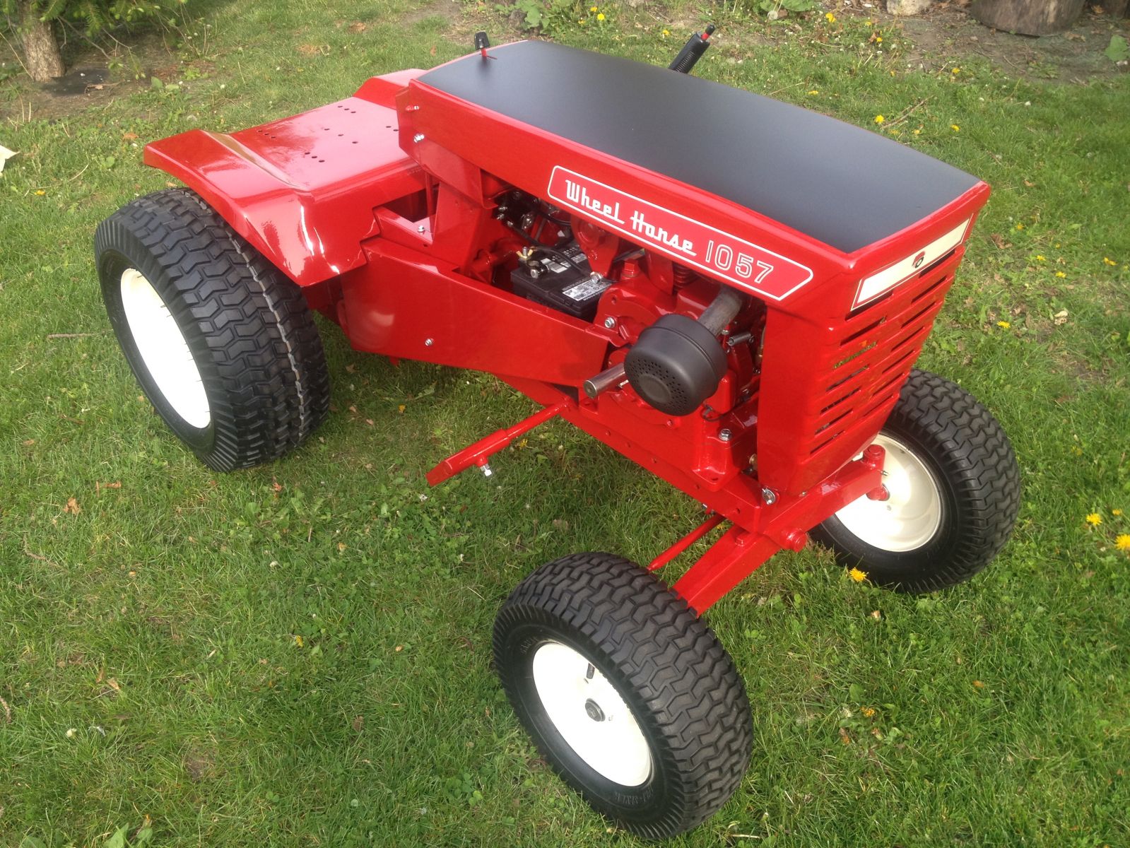

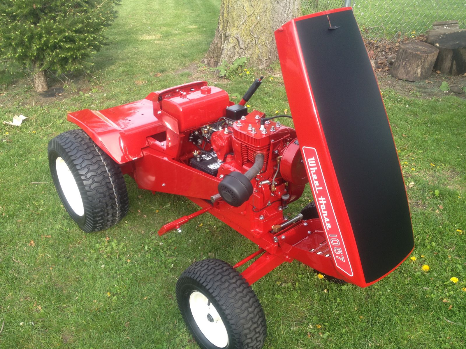

Martin 2,133 #192 Posted April 15, 2012 well heres another update. got the hood all sorted out with a 'blackhood'decal from terry (vinylguy). i made up a template and got terry to cut me out a decal to fit on the hood to cover the problem areas. we kicked around a carbon fiber pattern and matt black. i decided the matt black was more in tune for this tractor. also got the rest of the awesome decals applied. heres some pics of my hood adventure....... then terry gave me a sample of the template in white vinyl to test fit. was good to have a test run for installing the final piece. and this afternoon i installed the matt black decal...... then it was onto applying the rest of the tractors decals. terry has the 1057 decals in both red/white and red/beige. i decided the red/beige decals suited the red/beige of the tractor and wheels more. heres a few of the 1057 out in the sun, not much more than the seat and steering wheel to finish now!!! ....... 1 Share this post Link to post Share on other sites
smoreau 658 #193 Posted April 15, 2012 I like it Martin! The seat will really set this one off just wright The horse blanket thing just not going to work with this one :ychain: Share this post Link to post Share on other sites
Terry M-(Moderator) 2,299 #194 Posted April 15, 2012 that matt black hood decal looks awesome Martin! :handgestures-thumbup: Share this post Link to post Share on other sites

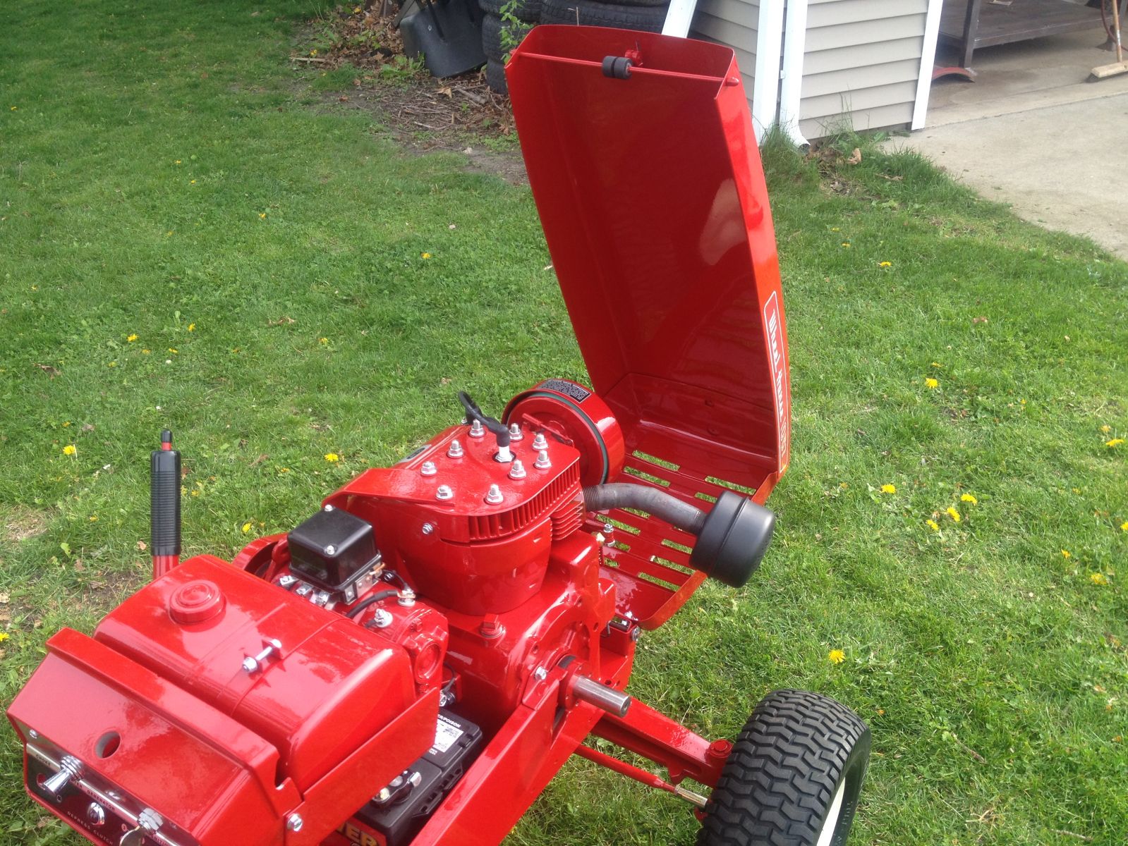

WheelHorse50 10 #195 Posted April 19, 2012 I know this goes back to page two but I was just looking through because I love this restoration and I was curious about the what appears to be head studs? I find it very interesting. Is that a custom fabrication of your own or did you buy those? Share this post Link to post Share on other sites
Martin 2,133 #196 Posted April 19, 2012 the head studs were purchased with a bunch of fasteners from mcmaster-carr. they are a self locking stud. here is the link...... http://www.mcmaster.com/#92386A636 studs just work better, you get a better bite on the threads in the block as the stud is screwed down all the way home before any tension is put on the fastener at all from clamping the head. i just like knowing that the 'bite' is spread through the whole length of the thread in the block. as the bolt lengths are slightly different on this motor, when using bolts ive noticed some have a tendency to 'pull' the threads more than others. cheap insurance for an old block........ Studs are threaded for a nut on one end and threaded (with self-locking friction-fit threads) for insertion into a threaded hole on the other. Also known as milled and tap-end studs, they have a Class 5 thread fit on the tap end (metric have Class SK6) and a Class 2A thread fit on the nut end (metric have Class 6g). Matching hex nuts are also available. 18-8 stainless steel studs provide excellent corrosion resistance and may be mildly magnetic. They have a tensile strength of 85,000 psi but are not rated for hardness. Share this post Link to post Share on other sites
Trouty56 568 #197 Posted April 19, 2012 Martin....really nice....beautiful....I really like this hood style. It's the grill....you have done an awesome job. I kind of like the black decal also...at first...maybe not....but the more I look at it the more I like it. :) Share this post Link to post Share on other sites
Martin 2,133 #198 Posted April 20, 2012 alright, had to go back over this thread a bit to see where i was at..... the black decals are going on the seat pan as well. ive tried out a template for the right side of the pan and will cut one mirror image for the left. i already know that the pan isnt symmetrical, so the left side one will need a bit of finessing. more on this here..... heres how the right side turned out. got my new seat today. michigan seat model# v-3500. not the original style seat, but it will do. this tractor had one on it before so i thought i would just get a new one. its one of the only new seats around $50 that looks ok for me. i think some later models used this seat, but with a logo on them. one thing i noticed is that i need to space the mounting at least 1/2" so the seat contacts the seat pan at the bolt location. at the moment the sides of the seat are touching the 'fenders' of the pan and there is at least a 3/8" gap where the mounting points should be touching and taking all the load from the seat. so i will make up a spacer and powdercoat it before installation. also have been working on rebuilding the pto. new bearings, seals etc and just got a call from the local toro dealer that my lining and rivets have come in, so tomorrow ill get them and will get it all assembled. bearings/seals were around $30. outer sealed bearing is timken P204RR6 and the inner needle roller is torrington J-2420. the seal is a national 343099, crosses to skf 14810 also been working on a steering wheel. i picked up an ariens wheel as its almost the same wheel as a 1057 wheel but a bunch easier to find, and cheap too. it needs some small mods to make it work, as ariens wheels are attached to a splined shaft, whereas the 1057 wheel was keyed. i will probably just ream the splines out and pin it to the steering shaft, as many models were. (thanks to tt for this tip on the ariens wheels). heres the wheel as i got it. needs a bunch of cleaning up, wet sanding and polishing but not bad for $15...... the bottom was butchered by a butcherer..... the damage will need to be fixed as well. Share this post Link to post Share on other sites
