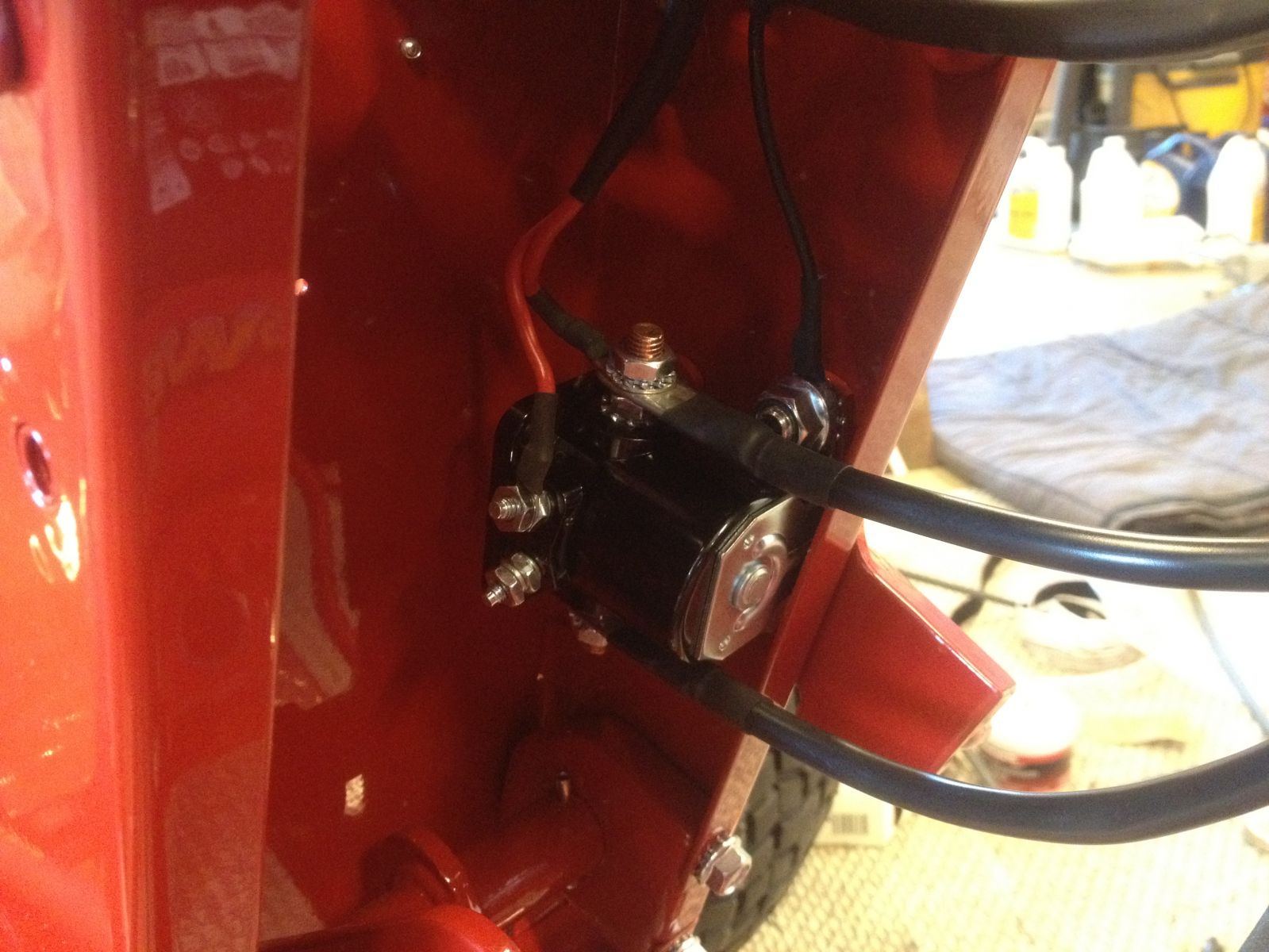

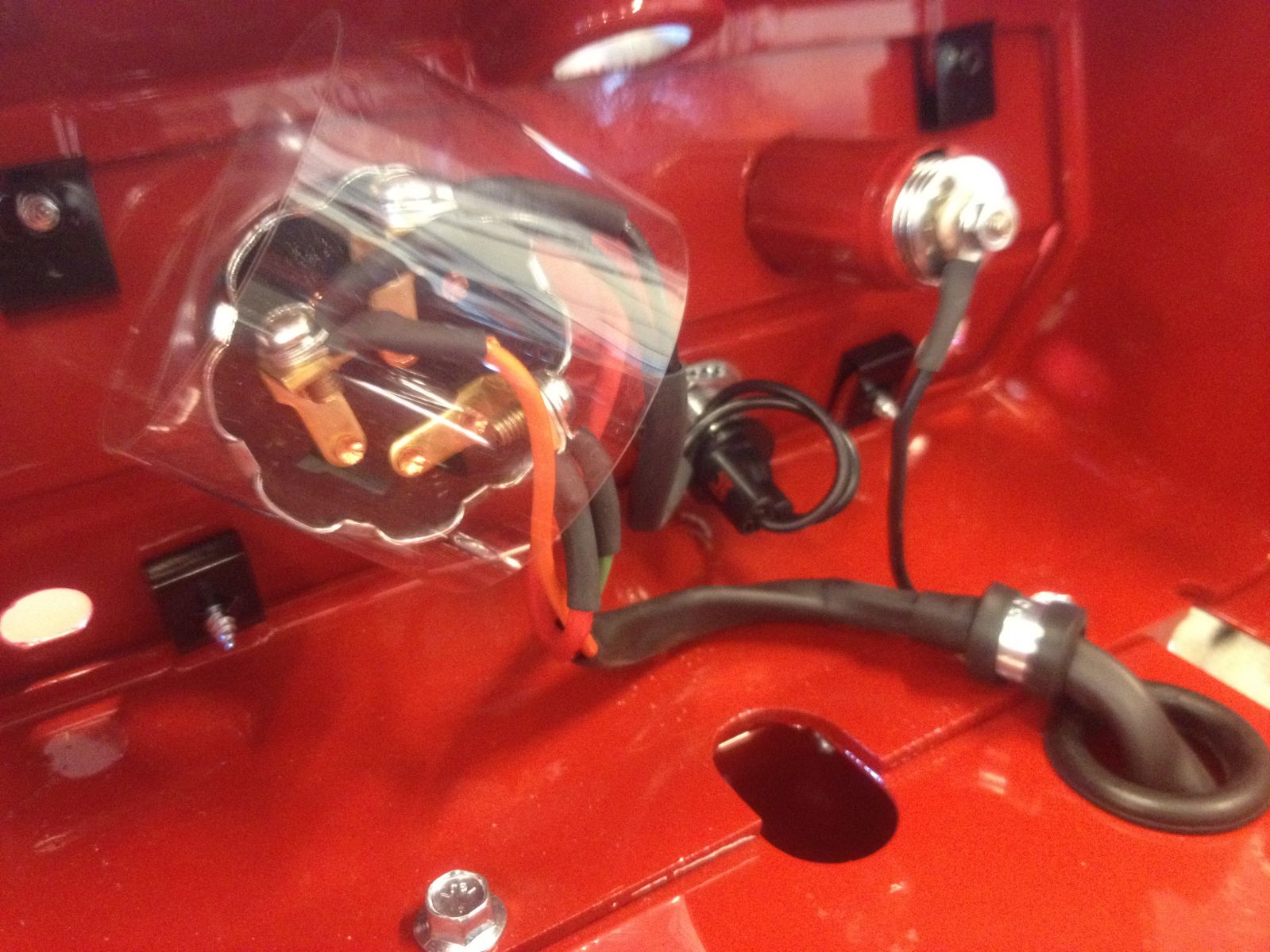

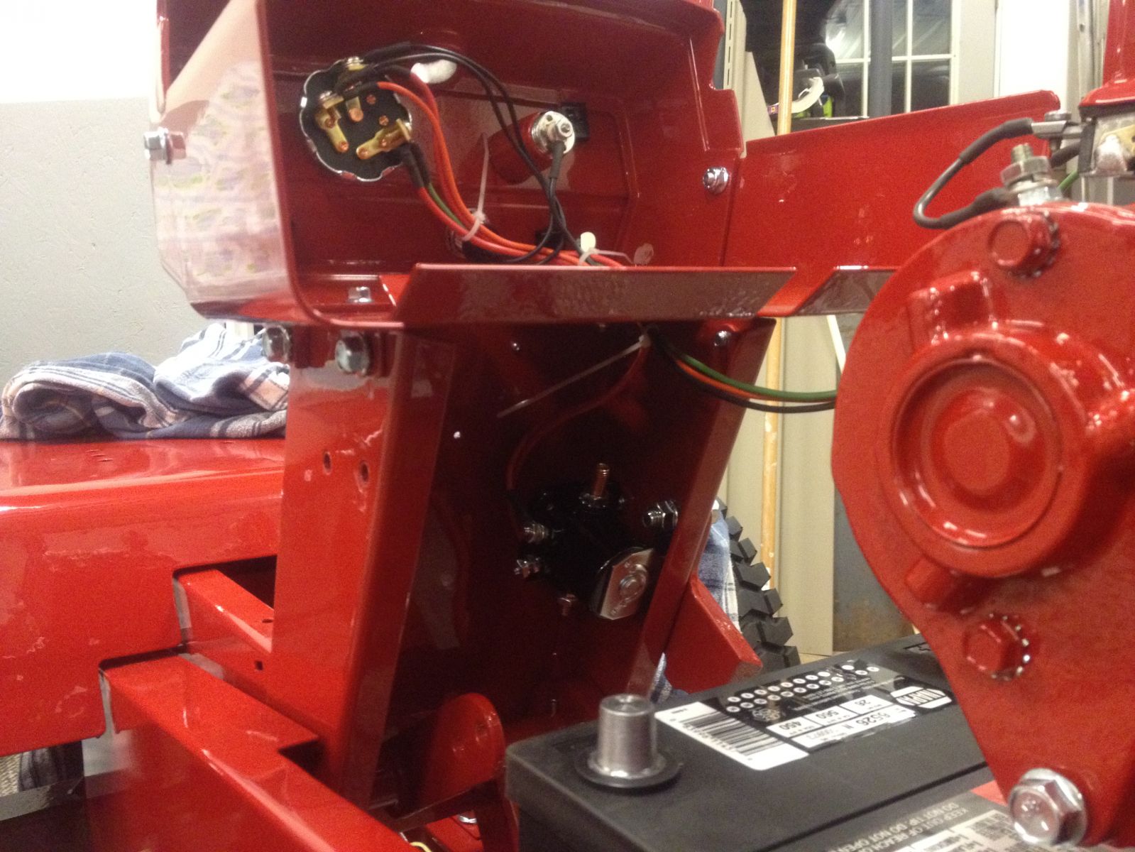

Martin 2,133 #126 Posted March 4, 2012 well the reason for the solenoid is twofold. first it relieves starting current passing through the ignition switch while the starter is energized. second, it keeps the heavy gauge wiring out from the dash area. i can just run from the battery to the switch and back to the s terminal of the solenoid using 12 gauge wiring as it only sends a 'signal' to the solenoid when starting power is needed. much easier to tidy 12 and 14 gauge wiring, than fight the 6 gauge common on these models without a solenoid. twas a good idea from a kiwi friend of mine....... also the size of the battery looks huge in there, but im sure its close to how they were, probably just taller. specs..... Battery CA @ 32 Degrees F : 560 Battery CCA @ 0 Degrees F : 450 Battery Reserve Capacity : 55 i think it was 8.5" l x 6.25"w x 7" h... 1 Share this post Link to post Share on other sites
dclarke 4,082 #127 Posted March 5, 2012 well the reason for the solenoid is twofold. first it relieves starting current passing through the ignition switch while the starter is energized. second, it keeps the heavy gauge wiring out from the dash area. twas a good idea from a kiwi friend of mine....... Good idea Martin, think I'll add that to the list of things to do to my project. That "Kiwi" friend of yours is pretty sharp! :thumbs: Share this post Link to post Share on other sites

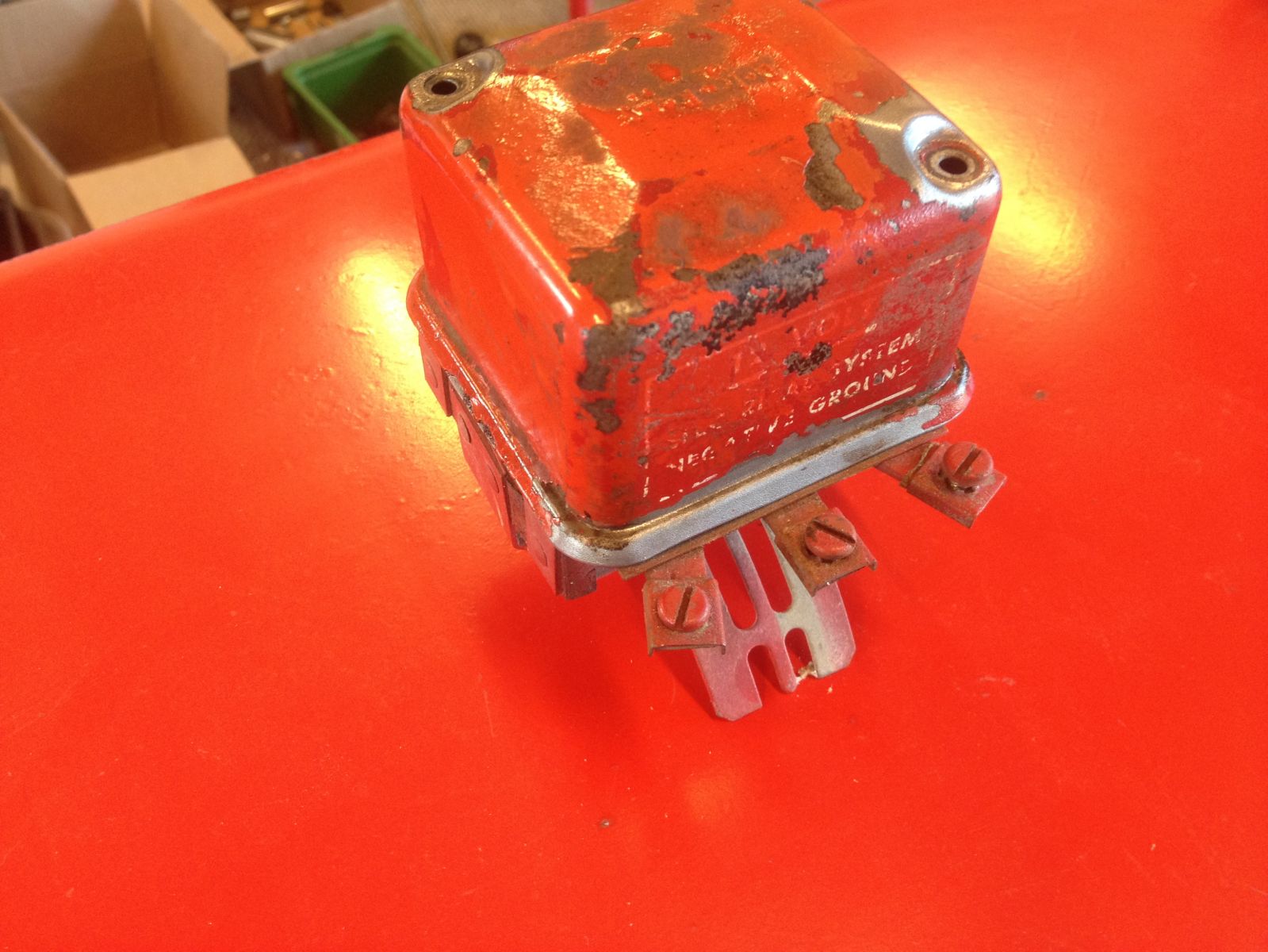

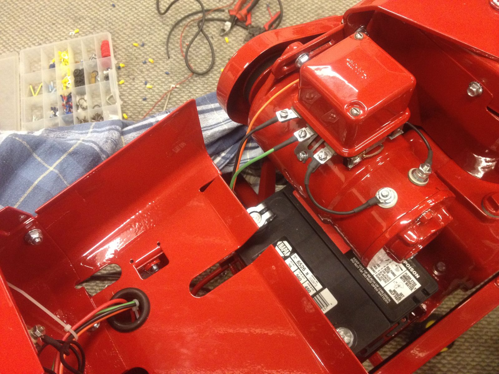

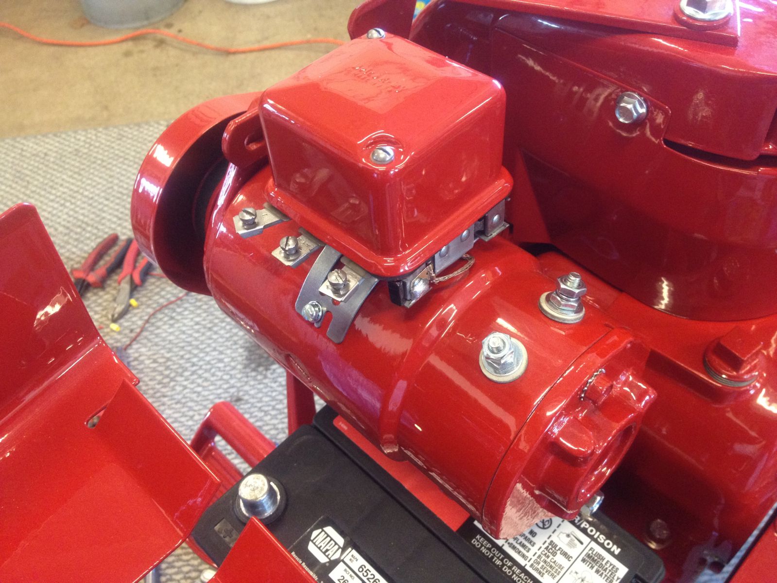

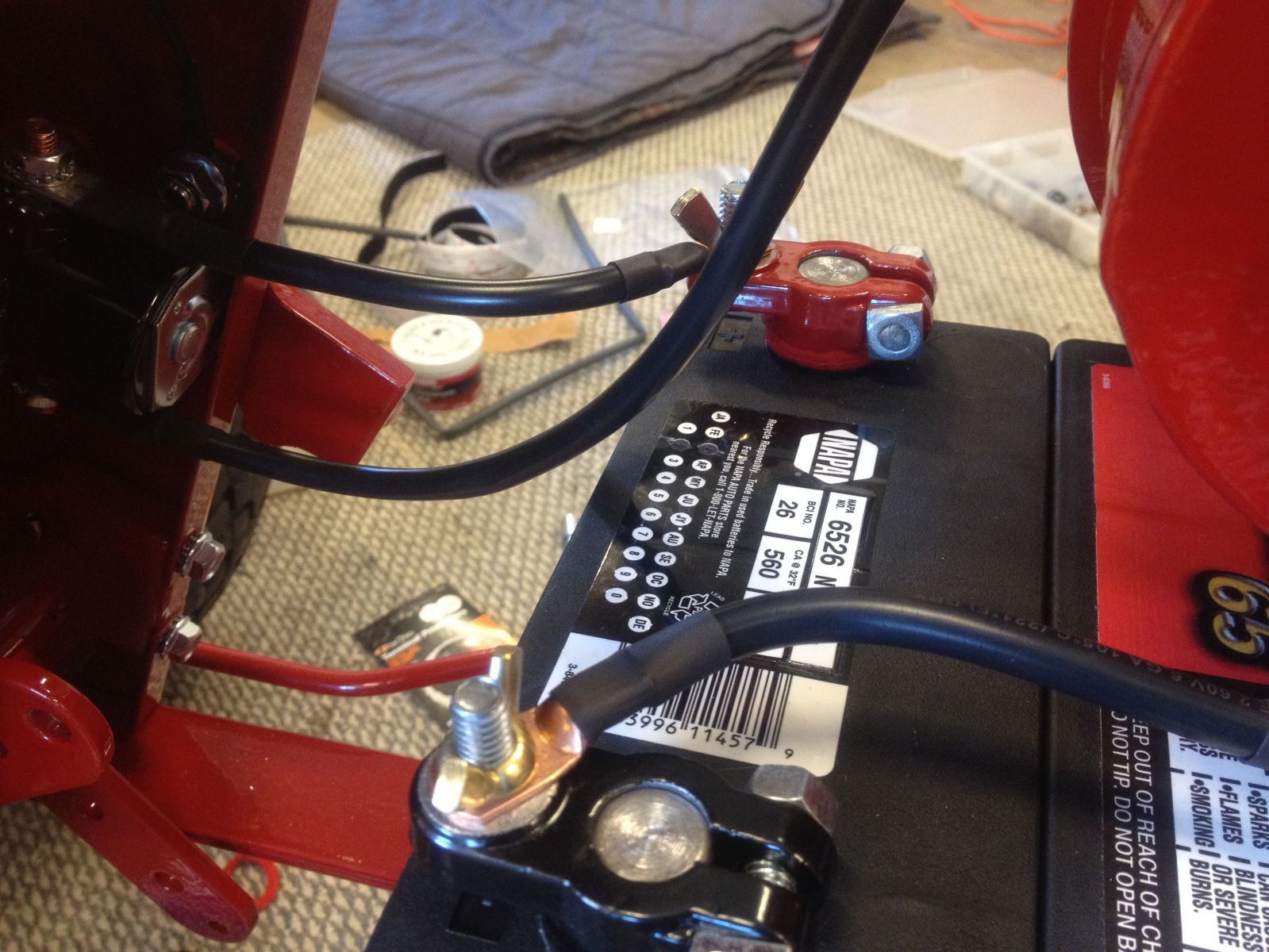

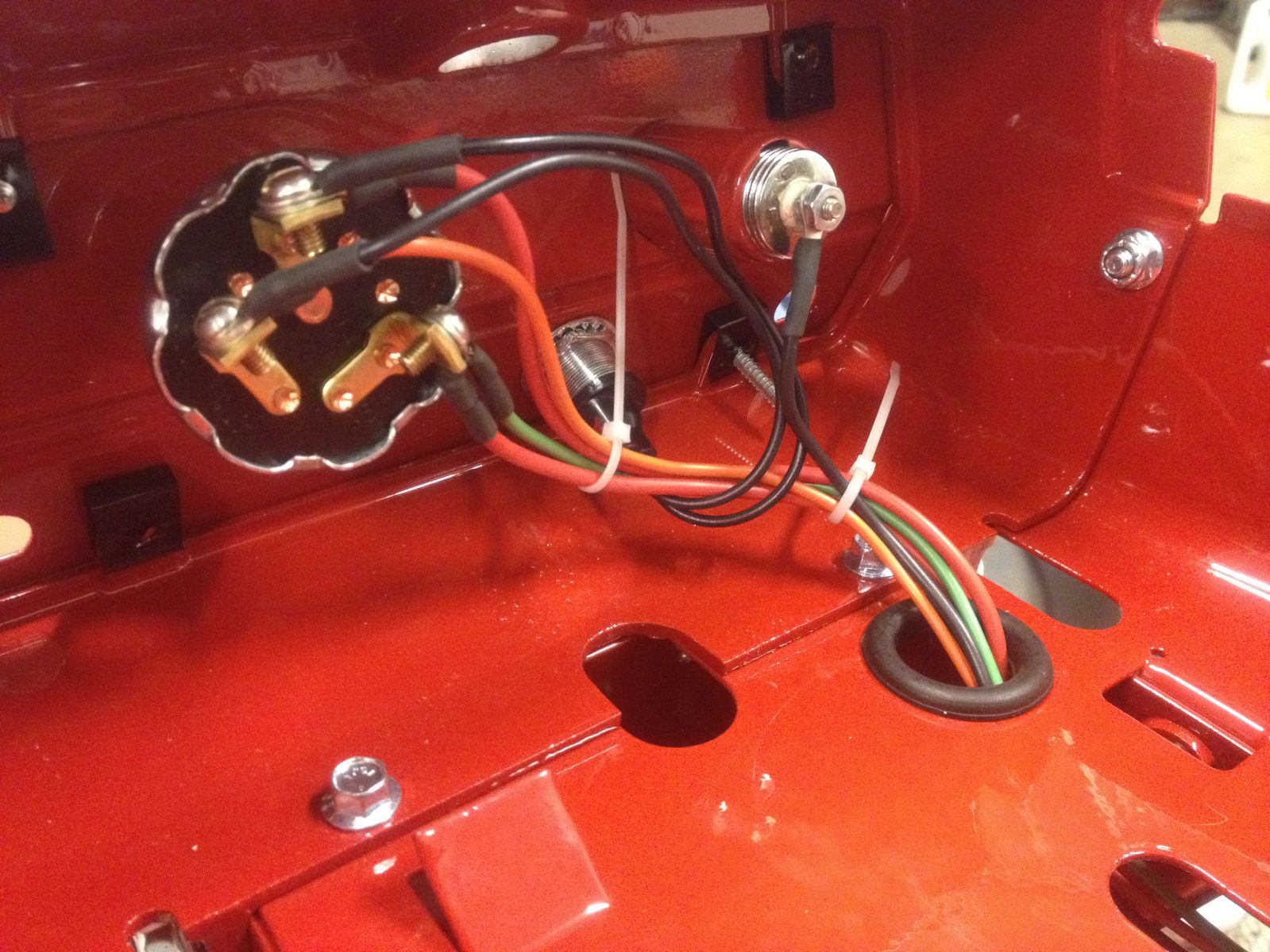

Martin 2,133 #130 Posted March 7, 2012 little more done. worked on the regulator, powdered the cover and glass beaded and clear coated the base. looks better than it did. this one was working ok from what i remember and im having trouble locating the 'proper' looking starter/gen regulator new, so this one was tidied up and i will use as is. how it was...... and now, just need to get a decal made for it and its done. thats been left to my friend terry....... roughed in the electrical, need to make sure its routed properly and then cover it up... nearly ready to check all the electrical out to see if it works! just need to finish up the battery cables to the solenoid and back to the starter/generator. 2 Share this post Link to post Share on other sites

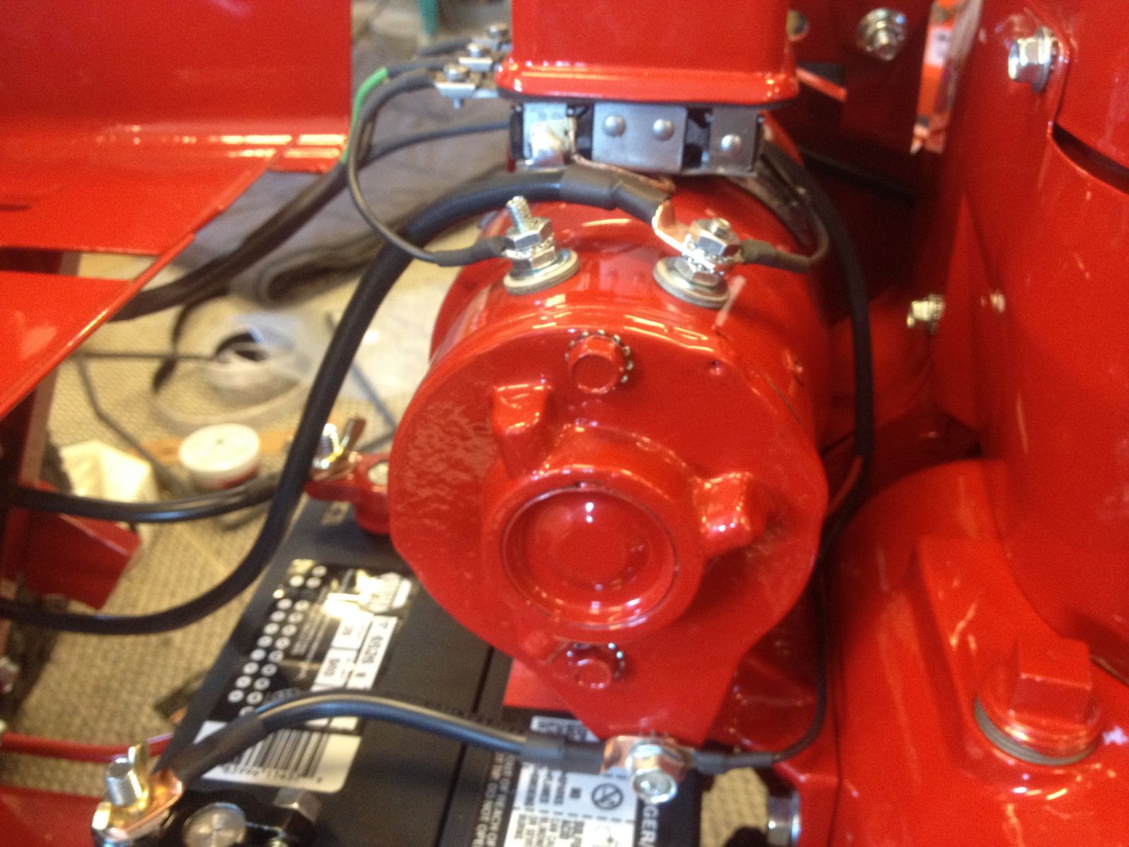

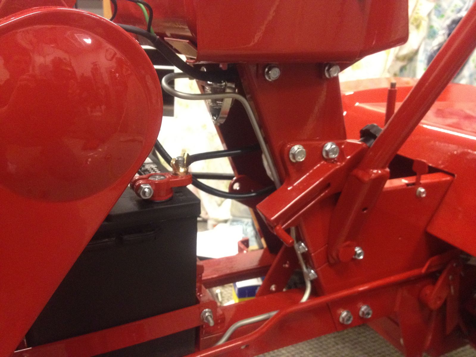

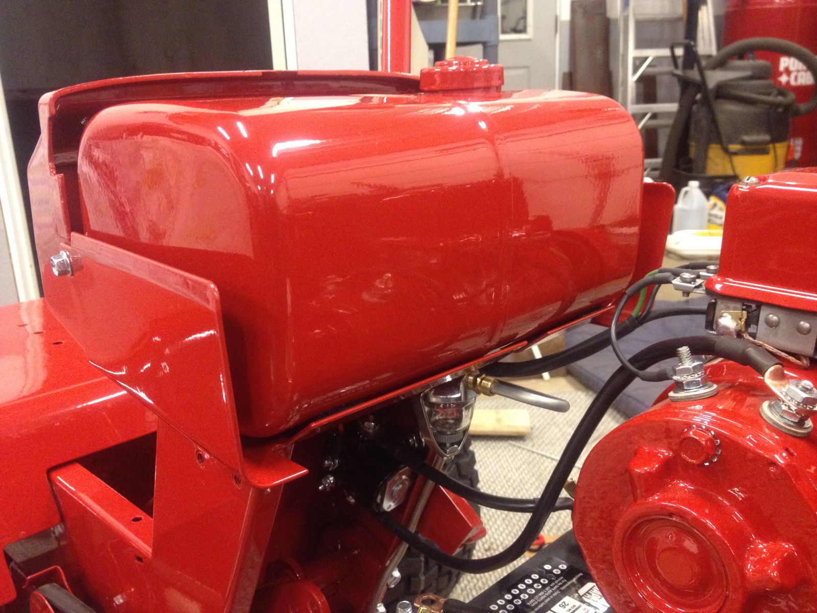

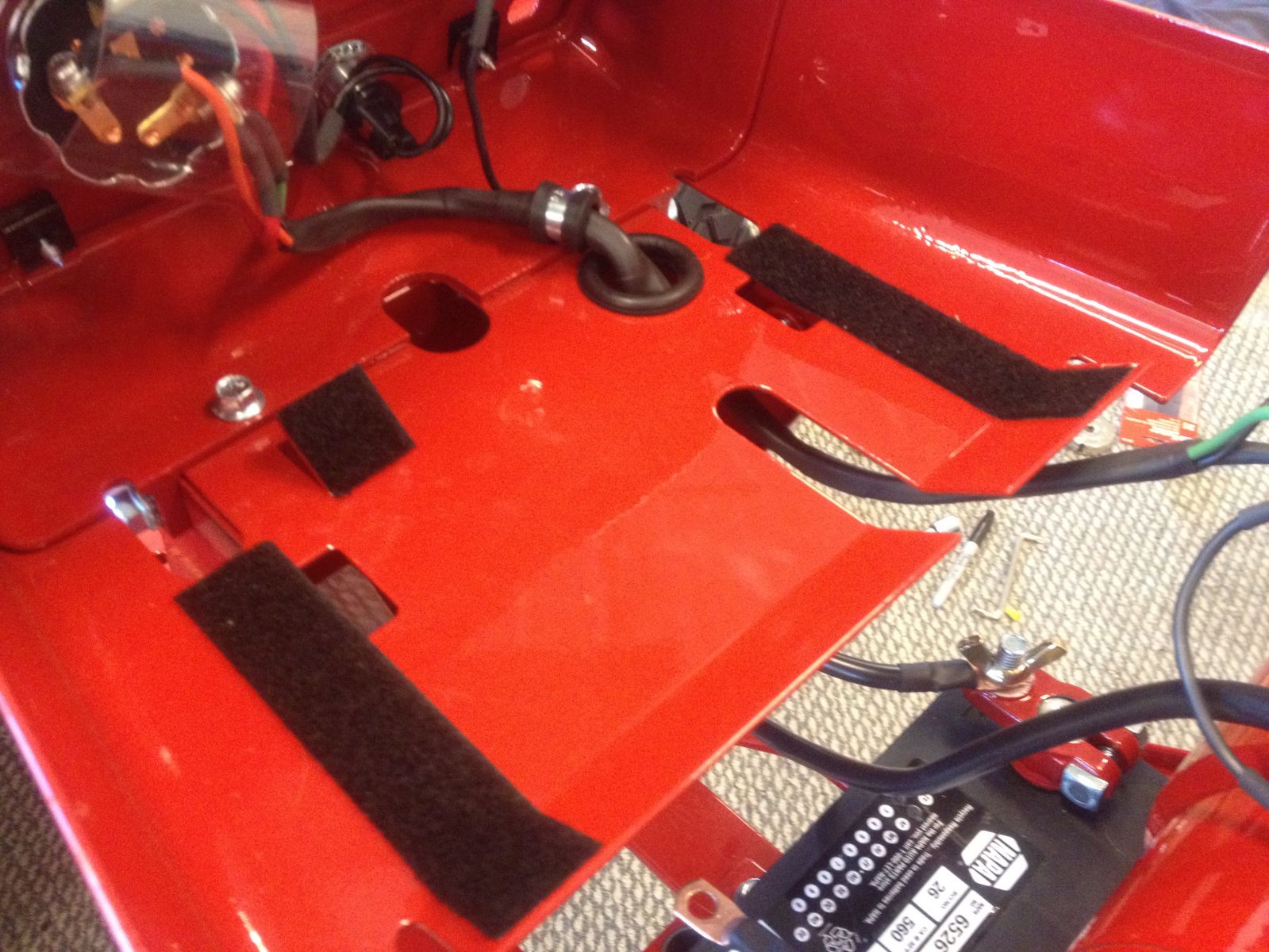

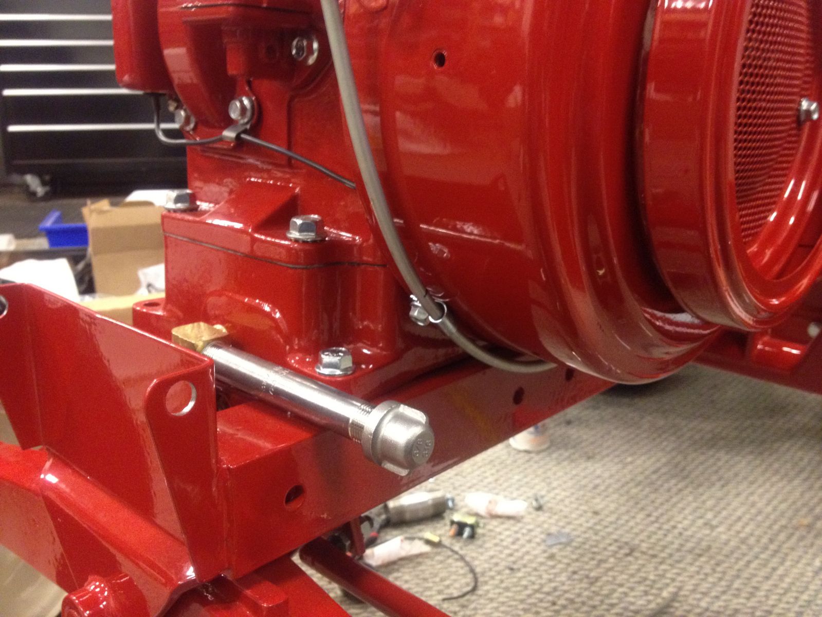

Martin 2,133 #140 Posted March 11, 2012 got more done today. wiring finished, and all covered. had a small problem testing and getting all working. it ended up being a ground problem. powdercoat isnt a good conductor.... started on the fuel system, making up a line from the tank to pump. not quite finished to the pump.i installed a glass bowl strainer and still deciding on where to install a filter in the line, maybe just before the pump will be the easiest place to be able to change it in the future. dash wiring all done...... solenoid wiring done..... and the rest of it.... put some strips on the fuel tank tray to stop rubbing. fuel line fabrication... 1 Share this post Link to post Share on other sites
WheelHorse50 10 #141 Posted March 11, 2012 Nicest restoration I've seen. Great job! Keep up the great work. Do you have some sort of wiring diagram for that? If so I might actually be in need... Share this post Link to post Share on other sites

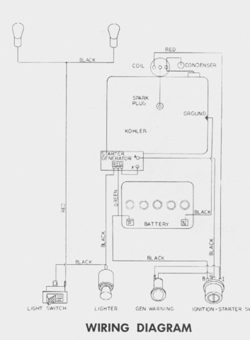

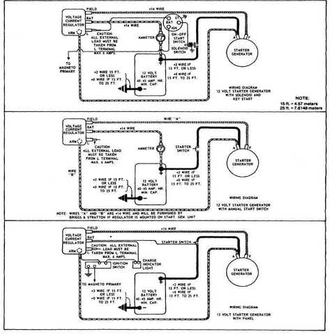

Martin 2,133 #142 Posted March 11, 2012 i just wired it up from the standard 1057 diagram found in the manual. added the solenoid into the starter part of the circuit. i will try and post diagrams of how i modified it..... this one isnt an exact 1057 one (1057 doesnt have the light circuit) but it is similar.... and in the first wiring diagram below you can see where the solenoid is hooked into the starter circuit.. i dont have any diagrams other than these, maybe if chuck (SOI) or somebody else reads this post and has something clearer then they could post it here for all to see, or at least post a link to it. im ok at posting what i can find, but hopeless at making easy to read wiring diagrams.... Share this post Link to post Share on other sites
condo630 7 #143 Posted March 11, 2012 Good work. I like that fuel line...what did you use? Share this post Link to post Share on other sites
Martin 2,133 #144 Posted March 11, 2012 Good work. I like that fuel line...what did you use? standard 1/4 inch brake line Share this post Link to post Share on other sites
